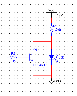

Got an example of a shunt driver ? never used one.
I cannot use anythijng but what i have @ home so i hope it is something based on a transistor or something.
Actually i have never even heard of it. "shunt driver" on google gives plenty of hits but i have no clue what is what i would be looking for.
A transistor that short the led at the place that a transistor that drive the led! Easy!
Fredos
Fredos
This sounds like shorting the LED to make it turn off faster, am i right ?
I understand it as this:
Or this:
Which is the right one ?
Or this:
None! Simply feed power to the diode directly with a resistor, other side to your ground and put a transistor in parralelle that short the led to turn it off! Simple as this!
Fredos
Fredos
Bah sometimes one can be real stupid

shunt driver
Hi edl,
Does it mean connecting the diode between pin 5 and pin 6 of 6N137?

Tekko, the use of 7805 to power up the 6N137 will give you start up probleme. Dont use electrolitic too on the decoupling of the 6N137. At start up, the time to charge them will result in a shoot trought of your mosfet (inverting mosfet driver...). Only use small 0.1uF ceramic decoupling cap and a stupid 330 ohms 1/4W and 5.1V zener for regulation...That's experience. The way you do it will bring you lot of trouble.
