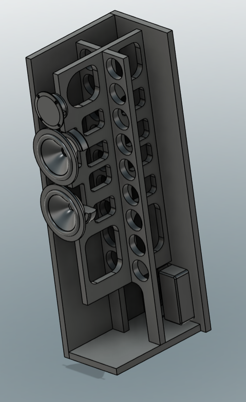

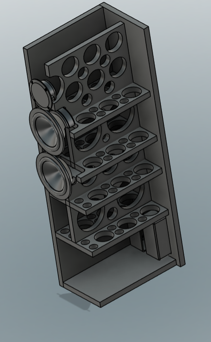

Throughout my career I have amassed a significant amount of knowledge on the subject of Statics. How this strength relates to frequency, however, I lack knowledge. I can run all the tensile sims in the world (and I do this weekly) but I don't have software to simulate resonances. I know it exists, but my question at the center of this thread is not about that software.
My questions is thus:
What is the difference between bracing and damping?
I see these terms intermingled when it comes to entering the dark realm of enclosure bracing. I see it said so many time that you can "brace a cabinet" or you can "brace it in order to dampen" it. These two things seem at odds with one another. At least to a standard manufacturing engineer such as myself. I understand both concepts, I just haven't even had a project where dampening of a structure was required to prevent cracking.
In this instance, we wouldn't be preventing cracking. We would be preventing a resonance. At least, that is my current understanding.
This leads to the second question:
What makes a brace act as a dampener as well as a brace?
My current understanding leads me to believe that a brace which could take a load but also flex would be best. Consider a solid board with a force axial to its length. A force entering into this board would simply transfer all of the load to its end.
Now lets consider a board with a bunch of holes in it. If we transfer a force into this board, yes, the force will go out the other end, however, some of it will be lost in flexion of the areas around the holes.
Is this correct or am I off by a lot here?
If we take multiple boards and cut various holes in them, stagger them, and intertwine them then we should be able to dampen and brace the cabinet all at once. Different size holes, different sizes of spaces between the boards, etc. This should spread out the loads, pressures, flexion caused by the forces from the drivers themselves.
While we are at it. Choose A or B here. I think B is probably better. A splits the enclosure in to 4 large pairs of sides where B splits it into many more differencing sizes. Choice B also makes it easier to make dimensionally on the table saw since the braces, top, and bottom are all the same width.

You are right, the second model of braces is better, option "B". Much better.

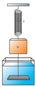

Watch this one. It's like 2 minutes. This is good demonstration of the difference between bracing and dampening a mechanical structure.Watched the video and have to disagree with you.
You are right, increasing frequency (rigid bracing) is one thing and dumping is another.What is the difference between bracing and damping?
Both methods can resolve the enclosure noise problem caused by resonances.
The enclosure panel is a kind of mass-spring system.
Mass is the mass of the panel and spring is the the panel rigity to restore itself to the original shape after being flexed by an external force, in this case, air pressure from speaker.
When we add rigid braces, we increase the spring stifness (k) and this increases the resonance frequency.
We are not dumping.
Of course that a panel has some sort of damping, cause wood flexing also has resistance and dissipates energy as heat.
This is ideal mass-spring
This is dumped mass-spring (in this case dumping provided by a fluid)
If you don't want to change the resonance frequency but just dump the panel, you need to add an extra element to the system: dissipation element.
So, the frequency will not change, but the system will quickly stop moving (dumped system).
This is what happens when you add a shock absorber to a car or motorcycle: you don't change the system resonance frequency, but just dump the system.
In order to only dump the enclosure panels, some material that converts movement to heat (not necessarily but most common) needs to be added to the panels or to the elements that connect one panel to the other.
When they move, this material will dissipate the movement energy to heat and stop the movement.
This is school theory - Now let's see the practical solutions, which I'll only guess 🙂
Pratically, you can apply layers of more plywood to the panels with some flexible material in between (this is the resistance that will dissipate the energy) or connect the braces between opposed panels not rigidly, but by some means of a material that will add this movement resistance (some kind of rubber or high viscosity fluid, for example). It can be complex and expensive.

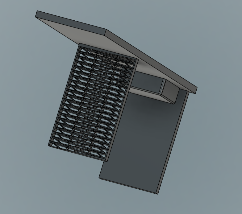

So this is inline with about what I thought. One idea I had was to 3d print braces. Install the braces with a foam or rubber between them and the panels.Pratically, you can apply layers of more plywood to the panels with some flexible material in between (this is the resistance that will dissipate the energy) or connect the braces between opposed panels not rigidly, but by some means of a material that will add this movement resistance (some kind of rubber or high viscosity fluid, for example). It can be complex and expensive.
Alternatively, I could 3D print the braces such that they had some sort of "spring" mechanism in them that would dissipate the energies. Of course, this could totally backfire and causes massive resonances of itself. A variable coil could possibly work. My track car has dual rate springs. Not progressive but actually two different spring rates connected to the damper itself. You could put different spring rates all around and end up with a mass of overlapping spring rates that could take up resonances.
