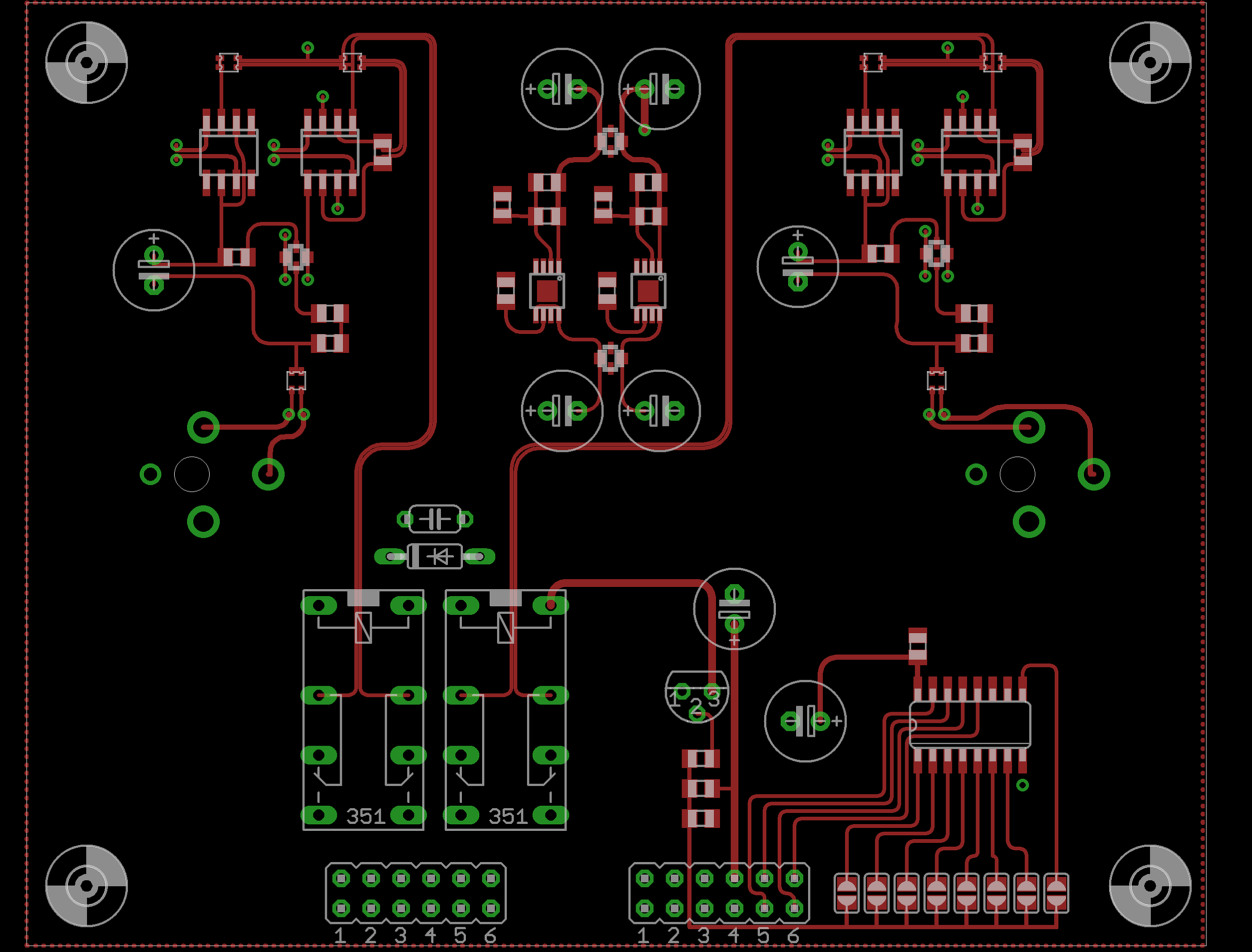

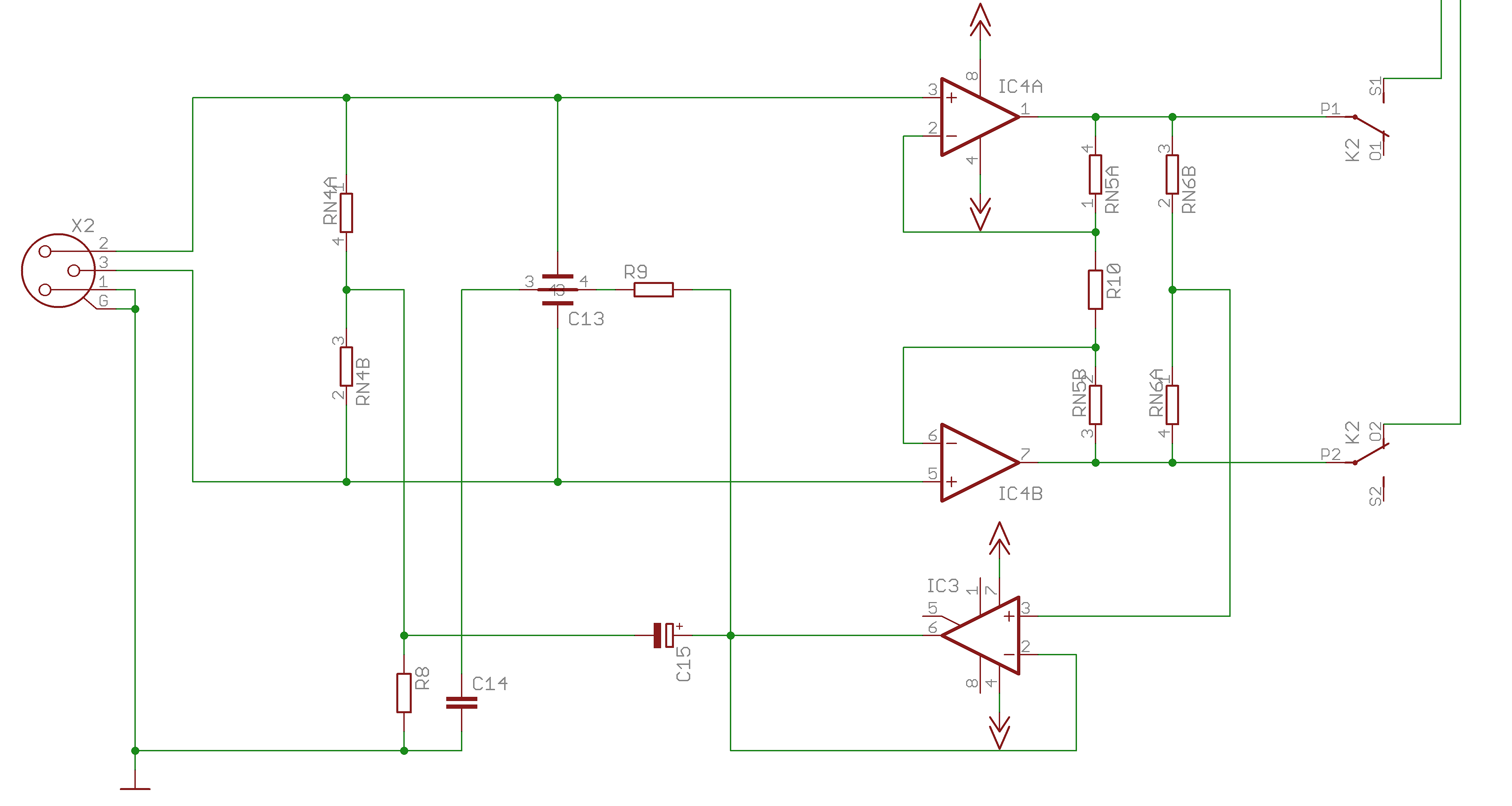

Motivated by this thread I resumed working on my own version of a Putzeys inspired balanced Preamp.
The input-boards are almost ready, including XLR connectors, the Whitlock bootstrapping circuitry, low noise voltage regulators and two relays + some logic to control them.
One board represents one stereo-channel, so this is not a cheap solution. But I need only two channels and so I'm most flexible for possible expansion.
The schematic shows one channel, the full top layer is on the other picture.
The connectors are on the others side of the board.
Now I start working on the "main board" with the instrumentation amp and the volume control. But I'm still insecure for what kind of volume control to use...

What you say is correct- first I wanted to put a jumper and a solderpad close to this Pin, so that I can decide whether Pin 1 goes directly to chassis or to ground.
But meanwhile I have removed the connectors from the board to use chassis mount connectors.
This has a lot of other advantages...
Apart from that- the "differential circuit" should be inherently immune to Pin 1-problems.

Curious, what's going on with C13 and R9 ?
C13 and R9 were parts of the bootstrapping circuit invented by Bill Whitlock:
The common mode signal is buffered by IC 3 and fed via R9 to the capacitor C13.
C13 is actually an X2Y cap, which is a bit like a capacitor with a center tap. This provides better symmetry than two single caps.
This circuit achieves a very high common mode input impedance.
Instead of C13 you will normally see two caps in series between the + and - input with their center connected to ground. This causes the common mode impedance to decrease with frequency.
Thanks. I also notice that you are doing something with the component layout, where it looks like the trace from R9 runs underneath C13.
