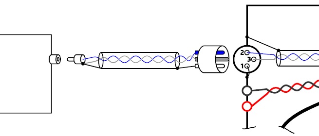

Thank you Andrew. Yet I was intending to connect the single ended RCA of my source to the XLR of the BP preamp in a way BP has described in his G-Word article and further detailed in the manual for the Hypex NC400. Figure 3 on page 13 shows this quite well:
That wiring of the screen does not work.
You have connected the Source Signal Return to the Chassis of the Receiver.
Look at Jensen's ap note 003, page3 section 2.4
It shows how to convert the unbalanced output at the Source to balanced at the cost of two resistors and one bi-polar component + a 3pole socket.
It's the same as what Putzeys has included at the output of this pre-amp.
I hot-rodded using 51r, or 100r, and panasonic's 100uF bi-polar of the type suggested. The 100uF can feed Rin down to ~2k0. Whereas Jensen's 220uF hotrod seems to be targetted at 600ohms loading.
