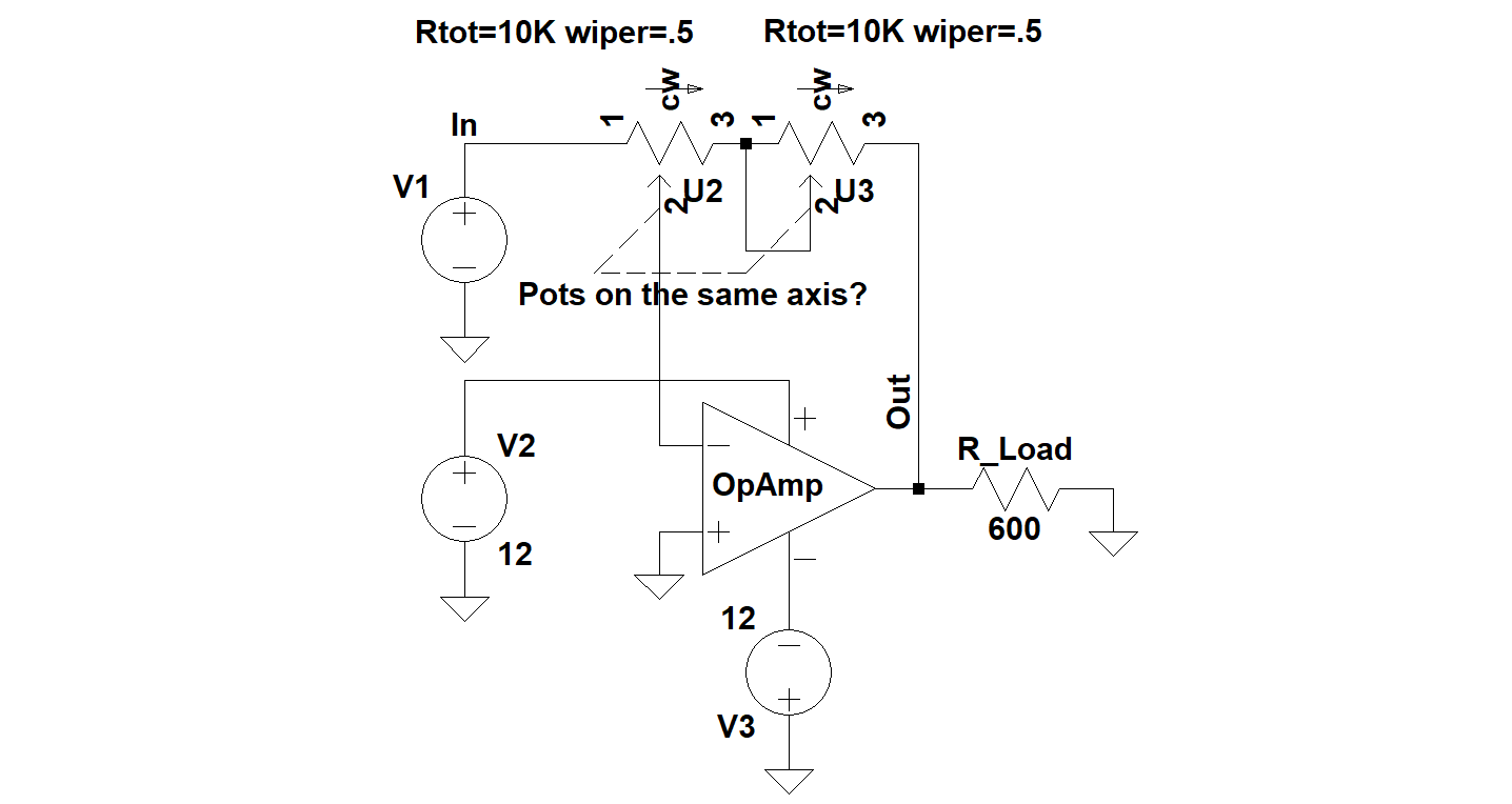

Now see what happens when adding a resistor R in one leg of the pot.
[Y*(A*I + B*I^2)] / [(100-Y)*(A*I + B*I^2)]+I*R =([Y] / [100-Y]) * (A*I + B*I^2) / ({A+R}*I +B*I^2)
Without going into further details, it is obvious that the elegant elimination of non-linearity is no longer available.
But, what you could do is to add a SECOND pot, exactly the same as the volume pot, thus having the same non linearity.
In that way, you can use the first pot for volume setting and the second pot as a variable resistor Z.
The algorithm would then become:
[Y*(A*I + B*I^2)] / [(100-Y)*(A*I + B*I^2)]+Z*(A*I + B*I^2) =([Y] / [100-Y+Z]) * (A*I + B*I^2) / (A *I +B*I^2) = [Y] / [100-Y+Z]
And again, the non-linearity has now been completely removed, and also [100-Y+Z] can never become zero, preventing a gain of infinity.
Hopes this explanation helps to get this problem out of the way forever.

Hi Hans,
If one choose to add 2nd pot as a variable resistor Z, how such a composite should be wired and whether both pots should be on the same axis in order to have the same rotational angle/value...like in sch below?
Linearity of the pot in terms of the resistance ratio is in this topology a necessary condition for the elimination of distortion.My point is: Will the noise/distortion cancellation that is described in Bruno´s paper work on the way the MAX device produces harmonic distortion/noise?

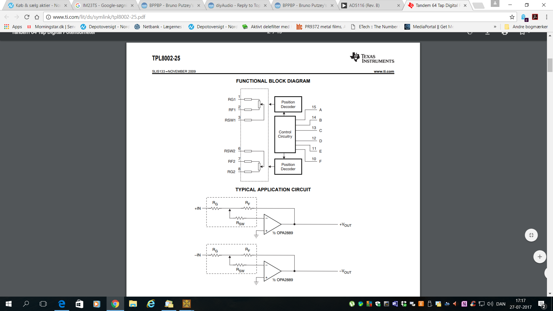

That discussion is pretty weird, as they conclude that it is very difficult to implement a digital vol.control in the same way as the analog potmeter, but this is exactly what a lot of these digital potmeters are designed to do.
Look at the screenshot. This is a TI device, and they have no distortion measurements for that, but the topology is the same as the AD5116.
Typical application is precisely how it would be used in Brunos preamp-
Well, I wasn't aware of the TI chip at the time.
While this device can be used in the feedback path, there are several points to observe before considering its use in this project.
Gain range: at least in my case, the -23.5 to +23.5dB range of the pot is not very useful because most signal sources with differential output have an output level of 4.2V. With the max. attenuation of the pot, the preamp would still send 280mV to the power amp, which amplified by 26dB (typical power amp gain) would put 5.6V at the speaker terminals. This is quite loud with most loudspeakers.
I've built two such preamps, one each with the mechanical pot and with the relay-switched attenuator, and both have a maximum gain of 6dB.
The other point wih the TPL8002-25 is that it is a low-voltage device. Should for whatever reason the voltage difference across the pot exceed the -4 to +4V limit, which is possible (e.g. 4.2V invertedby the output stage without gain ), the device may be destroyed.
Finally, the lack of the THD figures in the DS tells me that this pot is not meant to be used in a HiFi system.

The TI device was just to illustrate, that ALL the digital potentiometers can be used this way.
The resistance change in the TI is not ideal. A device like the AD5111 would probably be better, but that has to be examined closer.

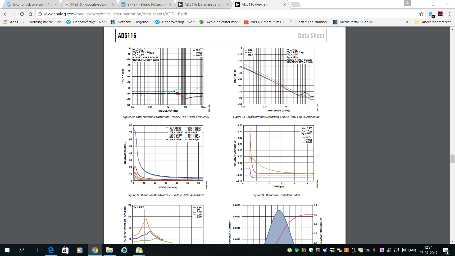

The important point in this application is whether a solution with a digital pot is able to deliver results comparable to a linear pot in the NFB path.
Even MUSES72320 is in the recommended application really only a standard pot feeding the signal to the noninverting input of the output stage, against which Bruno explicitly advised, and which can't be realised with the current PCB.
Re. the AD5111 chip, you might want to consider that it is also a low-voltage device, that the THD is -80dB, and that the DS recommends it for open-loop applications. There is also some digital feedthrough which gives me an uneasy feeling in this case.
I would genuinely like to see a digital pot applied in the NFB path, and especially the THD results of such an application.

In the case of AD5111, the THD figure of -80dB refers to something that may be called "insertion THD"; as specified in the DS, it refers to the signal at the wiper in the pot centre position being distorted by so much with regard to the input signal.
A good mechanical pot is much better than that.
I may be overly cautious, but I still would not insert a device with a THD of -80dB into a circuit having a THD of -120dB with a passive pot.
