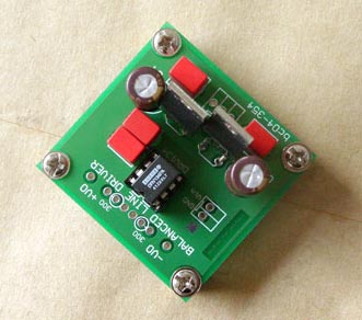

balanced line driver
Do you know where to buy a complete balanced line driver kit with power supply or the pcbs?
thanks
thanks
I am selling balanced line driver pcb's for $5 that use the drv134 opamp. Unfortunatly i have sold out of the PSU pcb.

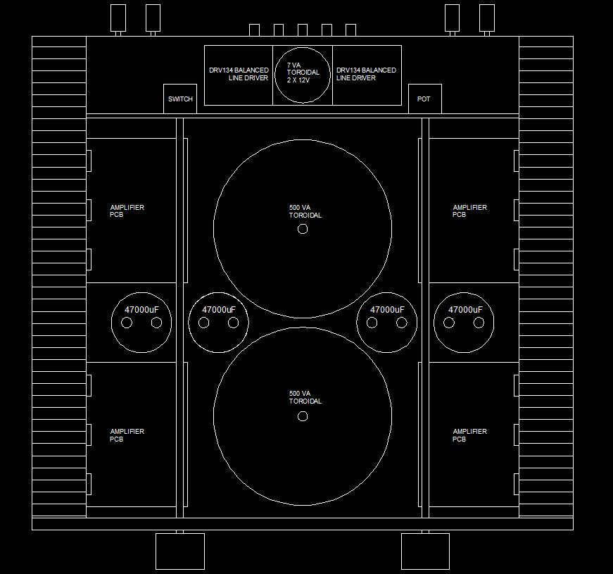

INTEGRATED BPA300 AMPLIFER
What about an integrated BPA300 amplifier with passive preamplifier in the same chassis.
The chassis can be this:
http://www.modushop.biz/ecommerce/cat079_l2.php?n=1
that layout would require advanced wiring skills, it'd be difficult to avoid noise
and the trafos are also very close to the boards
it'd be much better to go for 2 monoblocks, or PS in a different case
Re: INTEGRATED BPA300 AMPLIFER
No No No No No No No 😉
The BPA300 is a power amp, seriously use a seperate enclosure from hifi2000 for your pre. Also, you want a gain stage before the BPA300 to really push it.
juluska said:What about an integrated BPA300 amplifier with passive preamplifier in the same chassis.
