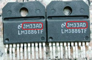

Is there anyway to match 3886 chips. I think in a parallel setup it could be beneficial. This amp puts out a prodigous amount of power for a chipamp and matching will keep everything equal, if it can be done.

tryonziess said:Is there anyway to match 3886 chips. I think in a parallel setup it could be beneficial. This amp puts out a prodigous amount of power for a chipamp and matching will keep everything equal, if it can be done.
Are boards still available. I would like 4. I have built 6 of these amps and they sound awesome.
Thanks Tad
It would be possible to match 3886 chips, but the cost would be very high i would expect do to the surplus.

Re chip matching: I can't remember where I've read it but one way to roughly match the chips would be to make sure they have the same serial number - see photo attached.
This number represents location of manufacture i think.
But I would think that if you order a tube of chips they should all have the same serial number anyway, no?
