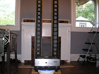

is that what might be called a long line array?
Can we assume the steps are to get your ears up to the optimum height?
i sit on a ladder when i listen to music --- does not everyone. roger russel original design was 5 drivers taller -- go figure!!! they sound pretty good. just something to do, have to stay busy or i will get old. now i am trying to find the hum in my bpa 300. it sounded perfect before i tied the two boards together. extra gain i suppose.
