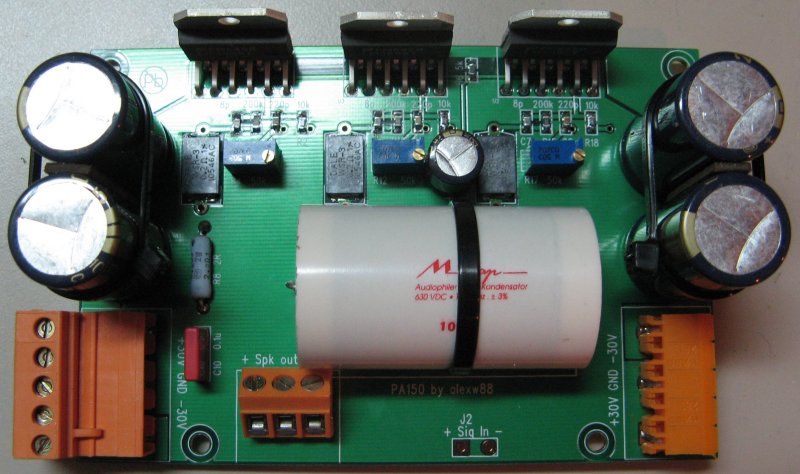

I'm working on a very simple DRV134 driver PCB that will include the +/-15V supplies. I'll post it when done, possibly by next week.
What do mean by Jensen. Is it to use Jensen as coupling cap on the driver PCB? The basic DRV134 PCB doesn't need any coupling cap. It is DC coupled. The BPA150 PCB are coupled using big 10-15uF fim caps. The PCB is big enough to accept Jensen cap if you like. Anyway the BPA150 PCB was not of my design. I ordered the superb PCB done by alexw88.

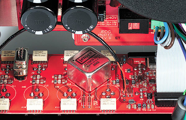

jeffry is talking about the jensen transformer used in the Jeff Rowland amp : http://www.jensentransformers.com/

I would like to add the option of using the Jensen transfo on my DRV134 PCB as an option but only if it is easy to do.
I understand that the DRV134 is providing gain for the BPA150. Using the transfo, I will need to use an op-amp to get the missing gain, correct? I suspect that a transfo driver PCB would be quite different than the DRV134 circuitry.

Build Best PCB for Jensen Transformer
Indonesia want to buy it 4 pcb 😀 EXACTLY
Why ? we cant afford JEFF ROWLAND Amp
So Build as good as he build, this another picture
http://www.shine7.com/audio/jeff.htm
