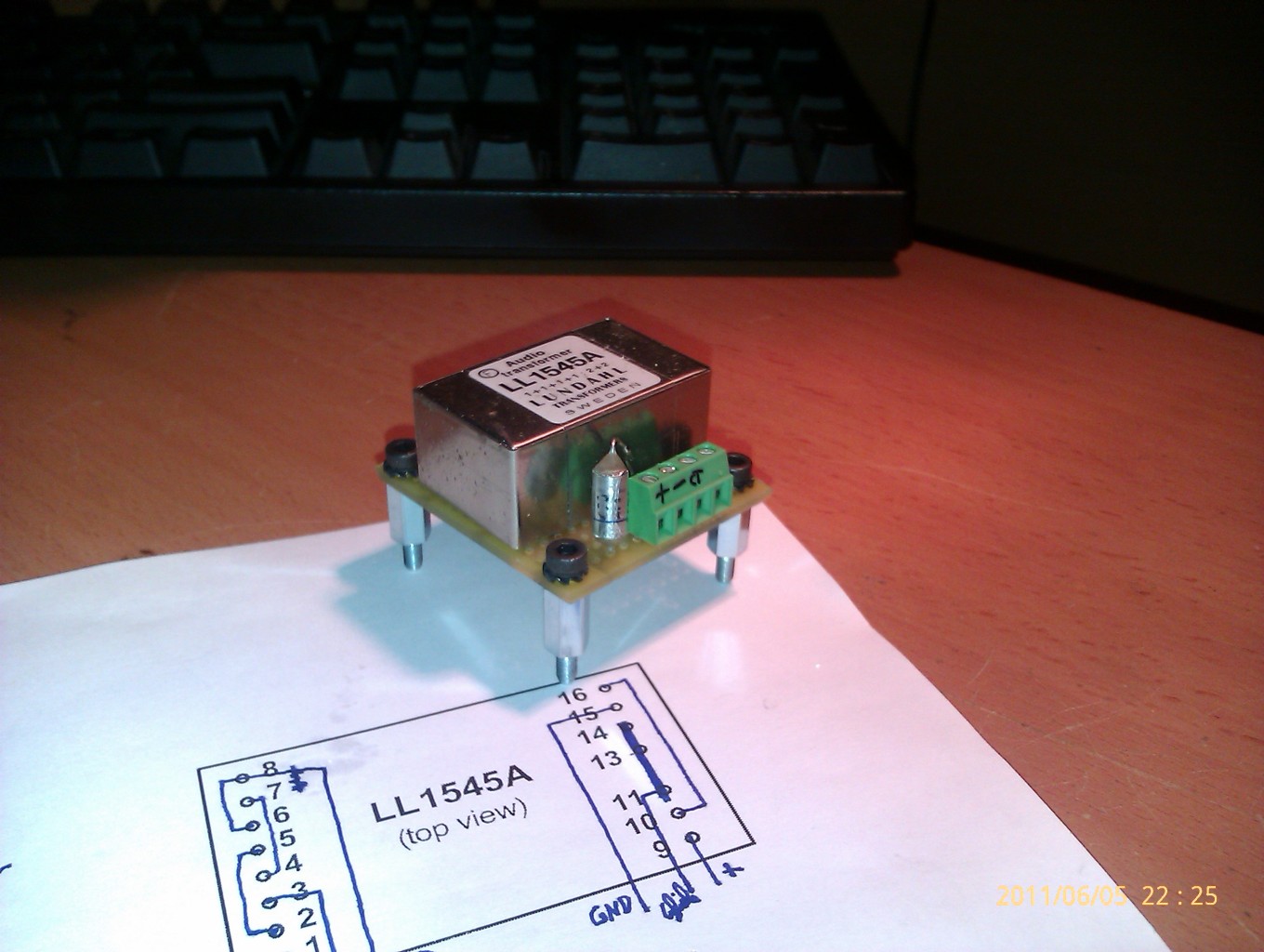

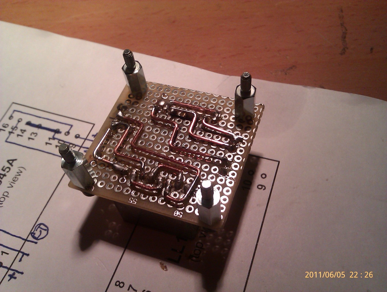

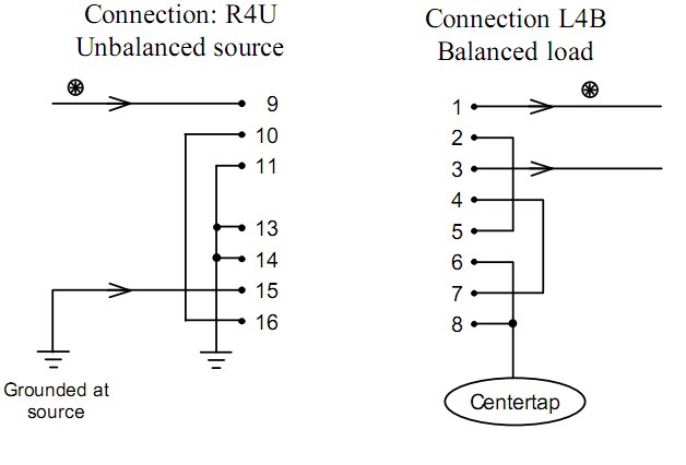

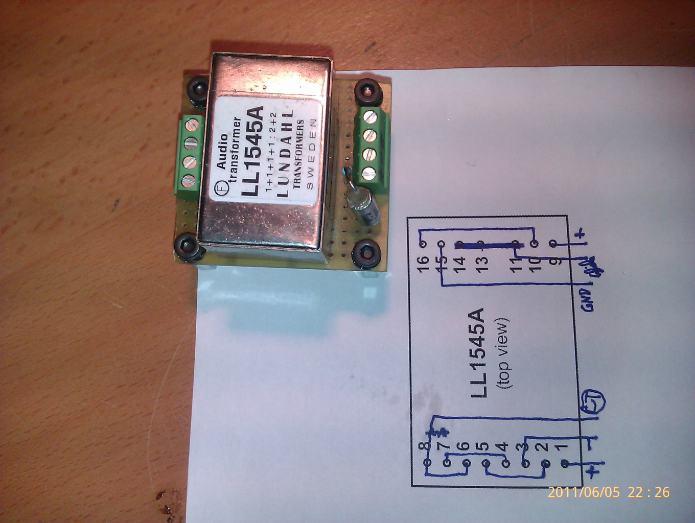

Hello,
I have already tested the LL1545A input tx but I have still one doubt. Attached is the connection I've used (R4U-L4B). May I assume that in the input side, where it says "Grounded at source", it refers to both pins 11-13-14 and 15, and not only pin 15?
Thanks!
Regards
