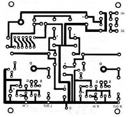

The values of resistors must exactly the same as in the circuit? I'm abit lazy not to make the 33.2K and 22.1k, or 4.75K, in stead I just make it 33k, 22k, 4.7 respectively. Would it be much difference?

It's blown up !!!!!
After connecting to the AC source, it's blown up :-(
The two resitors R2 and R3 are the first to get fire...
Please help, what is the problem? I'm quite sure that I connect the polar of the components correctly.
Your amp is drawing a lot of current! What sets the current is the voltage at the mosfet's Source and the source resistor; are R101, P102, and R108 correct value and placement? Or maybe you have a short circuit (to gnd) somewhere? Did you smoke any other components?
I used a photo editor to mirror it before get it printed. Then make the PCB. The bottom view of my PCB is mirror with that from original article.
This is the topview of my PCB
