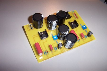

I have checked the PCB for a couple of times and couldnt find any short circuits as well as wrong polar. But I still got blown up for these resistors (R2, R3). Dont know what to do next !!!
Do I have to isolate the transistors from the heat sink? The heat sink is very small and do not connect to anything else.

BOZ should work with any TO-220 NPN transistor like BD243 (in my case). TIP41 have same pinout as TIP29, so go with it.
If your heatsinks are not touching other parts on the board (or the chassis), you don't need any isolation between heatsink and transistor case. Just don't forget adding some silicon grease 😉
Try disconnecting R2/R3 and measuring voltages around Q1. You would expect something like 85VDC across C1, 60VDC on Q1 emitter.
If these voltages are OK, something in preamp is drawing more power than supply can provide.
As previously said, try powering up one channel at a time and see what happens.

Check the trimpots. When I powered up mine, one was wrong, and the R1 was very hot. If you able to set up 25 V on at IRF 610 drain, it will be ok. After I replaced the faulty trimpot, I was able to set up the quiescent current.

I have seen this guy soldering the transistors which is different from mine. The plate can be used as middle pin? and in this case, the middle pin is just no use?

After removing the resistors, I got voltage at C1 is around 80V, emitter of Q1 is around 60V, BUT, after about 10mins, the C2 is exploded. Definitely there is some shorting somewhere.
So I decided to redo it from begining which I will test as I go, and very careful about the short circuit. :-(

No, I relised that the current drawn form the the power supply was high on on channel. I had the possibility to compare the voltages between the two channels. Then I found the faulty 10K trimmer.
