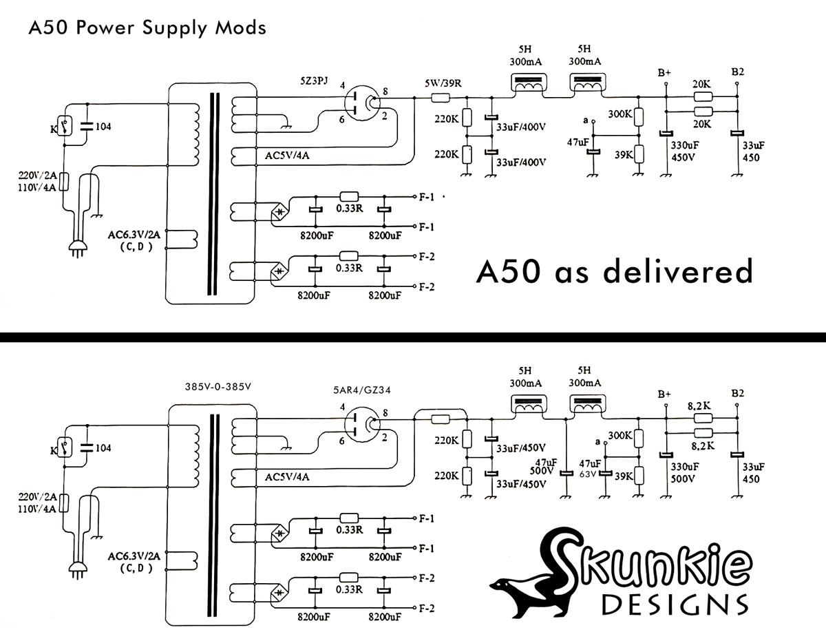

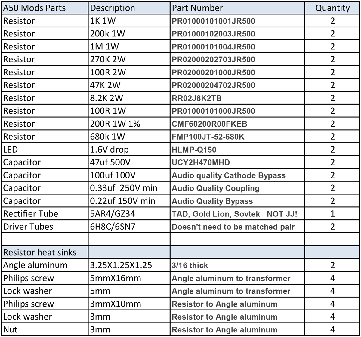

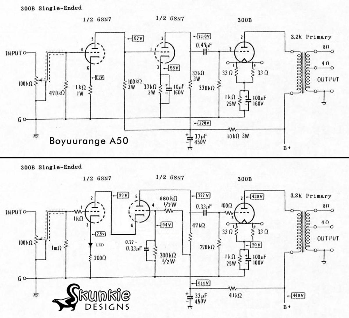

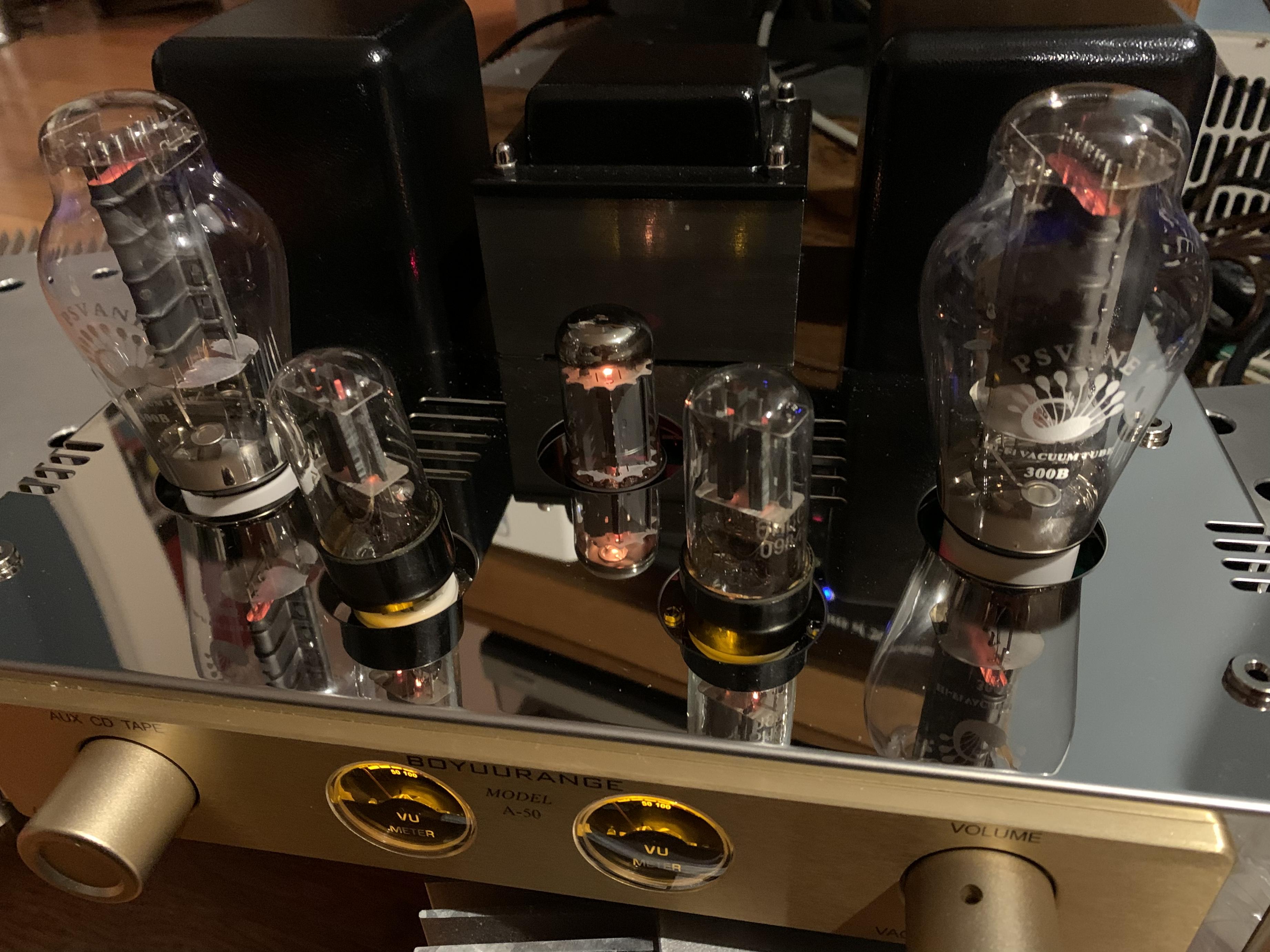

I also wanted to add the final schematic changes + BOM of parts needed, in case videos disappear in the future. The BOM xlsx spreadsheet is on my website Boyuurange A50 Modifications
Stephe - great video series! I just finished re-watching and making some "how-to" build notes. I'm planning to do the full bunch of mods to an A50 this weekend. Between the notes and schematics, I'll have 2 checksheets to know the work is done. And if something isn't clear, I marked the video name and timestamp in the notes.
example: Advanced Video 2 - 13:00 - 680K from B1 to 6SN7 Pin 4.
Thank you for the clear side-by-side schematics, BOM, and videos. Absolutely super work!!!

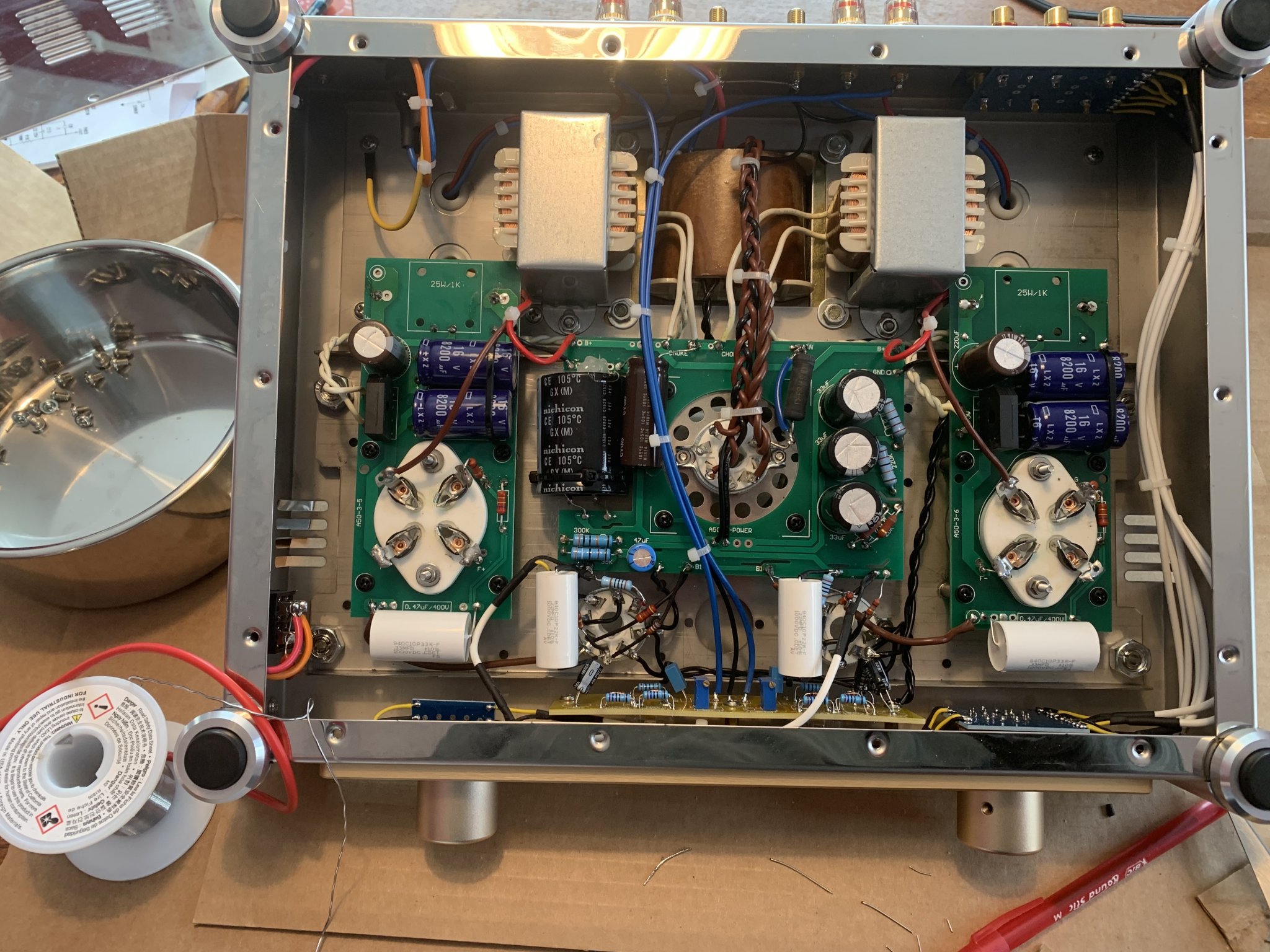

Done! Updated amp is sounding great! I used Elna silmic II 300b cathode bypass caps and CDE 940C series coupling and 6SN7 cathode bypass caps. Only comment on BOM is that I used M4 x 16mm screws for the transformer / 25w resistor heatsink. 5mm looked a bit big, so I tried M4 and they worked. I ended up tapping the heatsink / 90 degree aluminum for the 25W resistor.

And thanks for the BOM note, I'll update it. That's one of the things I honestly hate dealing with and am not very good at.

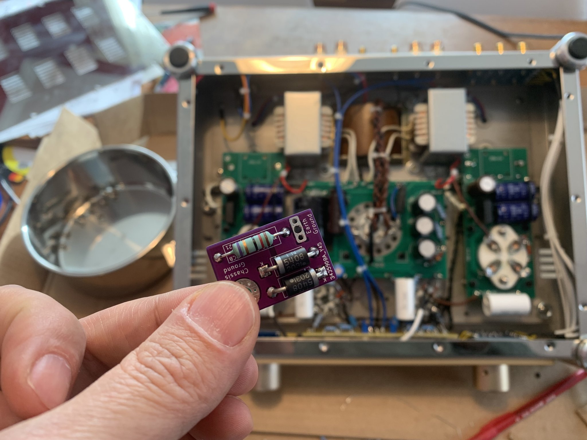

Stephe, have you tried this amp on horns? Did you have a hum problem?
I was testing on JBL 4410 monitors (91dB) and it sounded fine.
Then I put it into my active horn system (JBL Hartsfield, Fostex Supertweeters, Danley DTS-10 Sub). The 300B amp gets 500Hz and up duty. it was giving a whole lot of HUUUUMMMMMMM. I tried a cheater plug and it knocked the hum way down.
So I put a CL60 thermistor from chassis to AC Mains ground. Thus cuts hum down significantly. It's not totally gone, but it's much improved.
I think additional hum busting would probably have to involve more PSU filter work, maybe filament work, and maybe a ground lift resistor/thermistor between channel grounds. I've been playing with solid-state amps for the past few years, so that would be my thought process. Perhaps a SET like this requires other techniques.

But seriously, hum issues like this are almost always something about the particular local hookup. Plug everything! into the same power distribution strip, etc. I cannot recommend a thermistor as a ground isolating device - they can't survive long enough to throw the breaker, so become a safety issue.

None of your circuit recommendations would effect either hum or safety. Both of these are issues primarily in the primary circuit. Although written for an Ozzy/Kiwi audience, your reference seems true enough for Americans too. Safety is well addressed, and safety first and last for responsible adults.
The 35A bridge plus 10R resistor, maybe with the 100nF cap, is currently the best available option for isolating signal "ground" from safety earth / PE in American lingo. The resistor never sees more than about a Volt and a half, so doesn't need to be very big. Most folks don't even need to bother with this, if everything else is hooked up right, but it's *reasonably* safe.

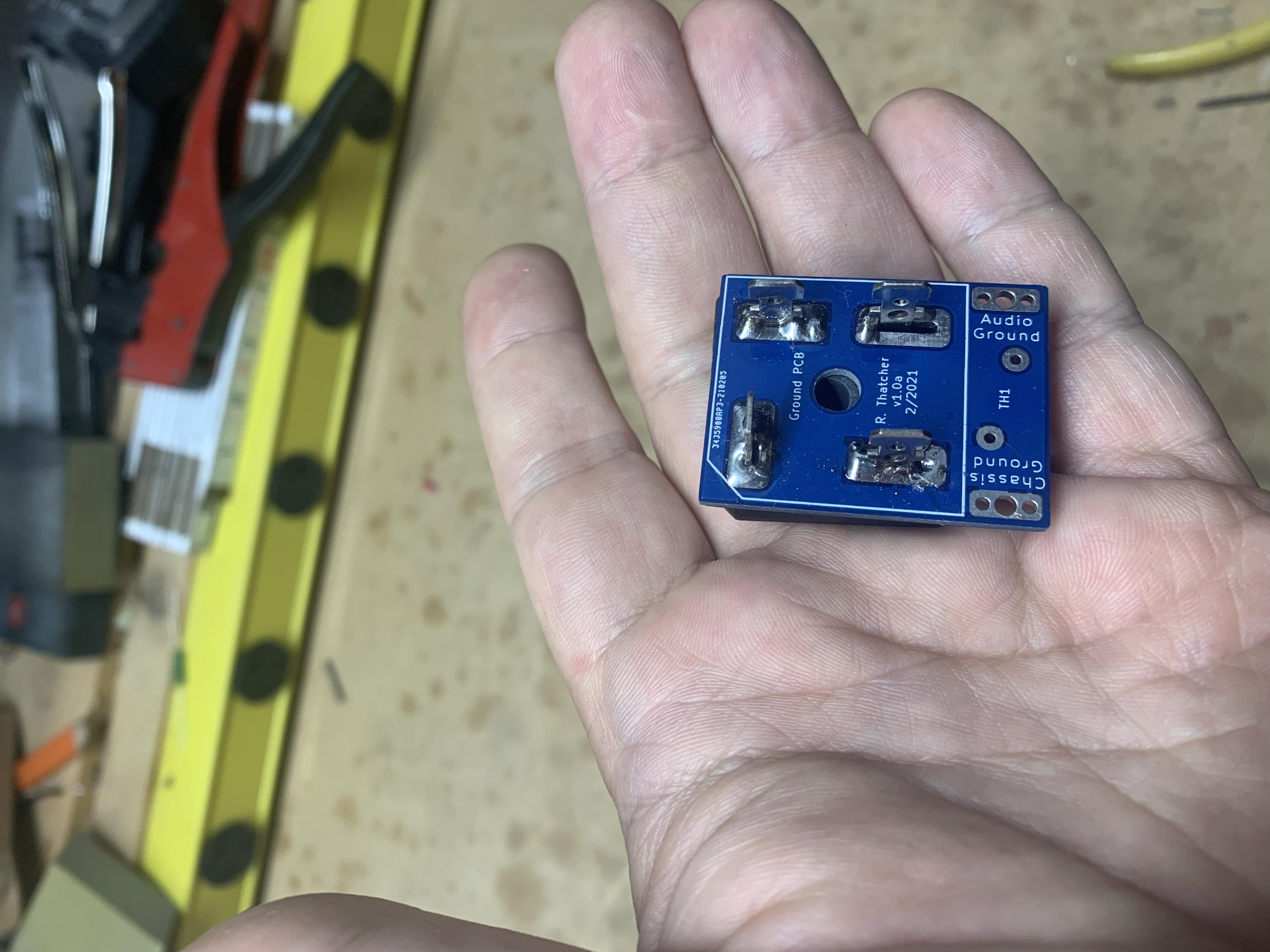

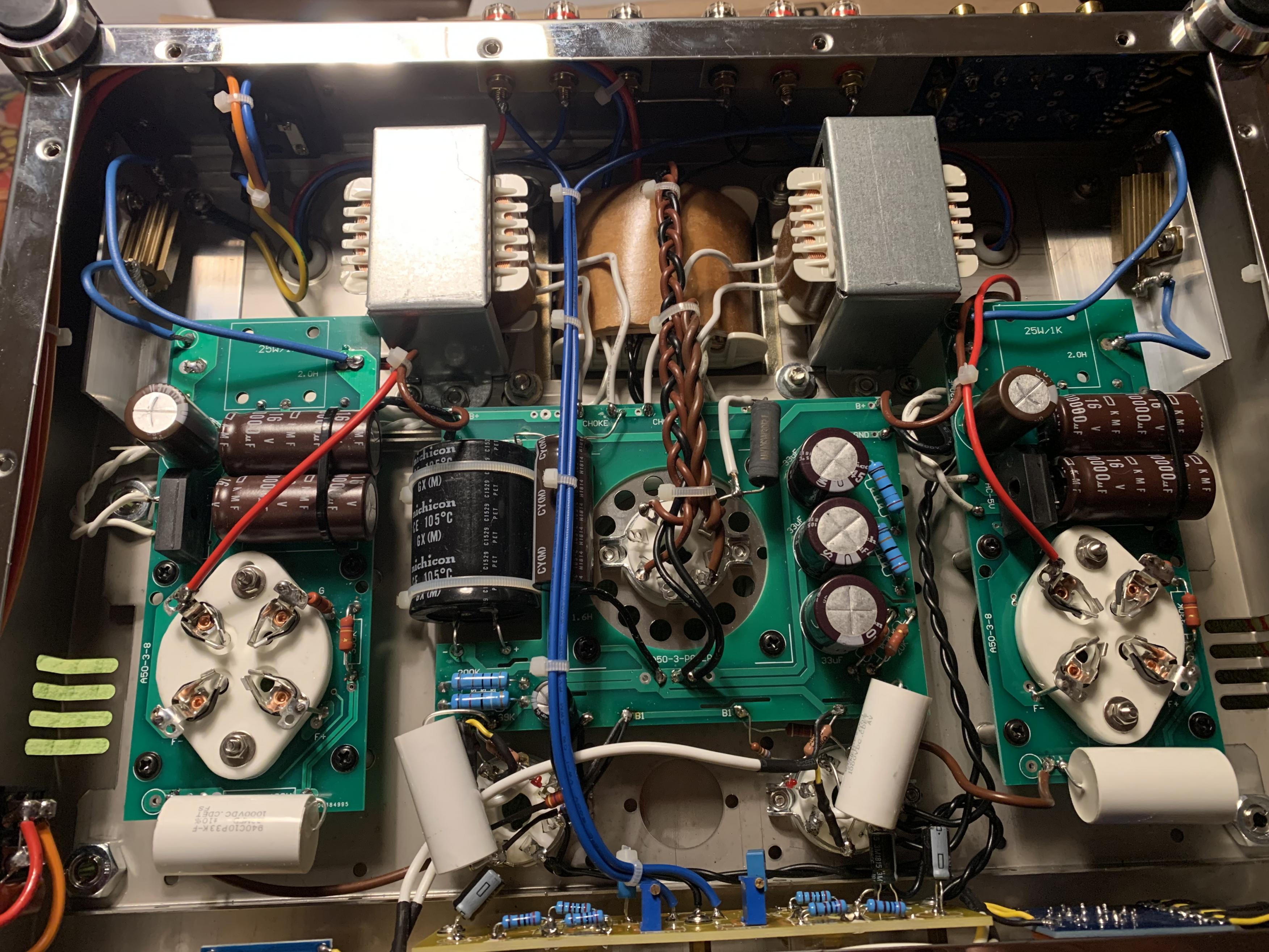

I just modded another one. This time I added a new way to address the ground. 12R resistor with 2 diodes as a ground lift / hum breaker in between the IEC ground wire and a screw that holds the 25w resistor L bracket / heatsink to the chassis. It’s sounding really nice!

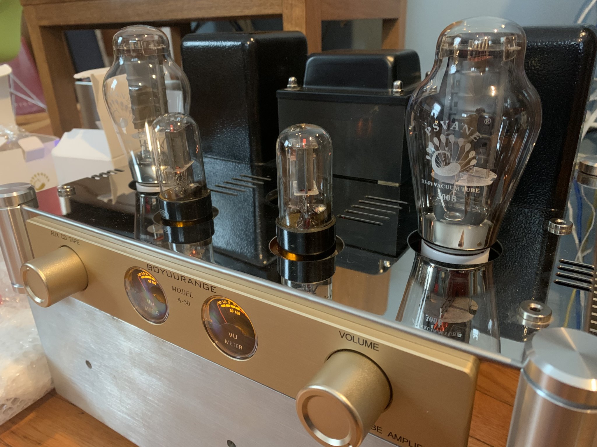

One of the best video segments I have ever seen...great Job Steffe....are you still planning to offer a 300B Kit, would love to have your build cant seem to get the point to point build...am simple soldering guyAnd here is the final video as a wrap-up with listening impressions and recommendations. There is a point where you have to say "Stop here" and I think these fairly inexpensive mods were a good place to end. Spending over 1/2 of what the Amp costs just doesn't make sense and that's what replacing the output transformers would be, plus I'm honestly not sure there is even room to do that on this chassis. It produces over 2X the power it did as delivered and at 3W the distortion dropped from 3% to well under 1%. Sonically it's much improved and with some easy to drive speakers, is a joy to listen to now.

Stephe,The original kinda looks like the first stage was supposed to be a 12AX7 or 6SL7...
maybe I missed it, but was input sensitivity changed after your mods? Can you detail what input signal is need to reach rated output w/ this amp?

Yes the input sensitivity is lower but a normal CD deck output will still easily drive the modded amp to full power.Stephe,

They sound similar as the schematic is almost the same on my design vs the mod A50. Honestly I basically just adapted my design to this amp. Mine still sounds a bit better, in most part I believe due to having better output transformers. I'm soon going to post a minor modification to my design but I need to test my idea first.
