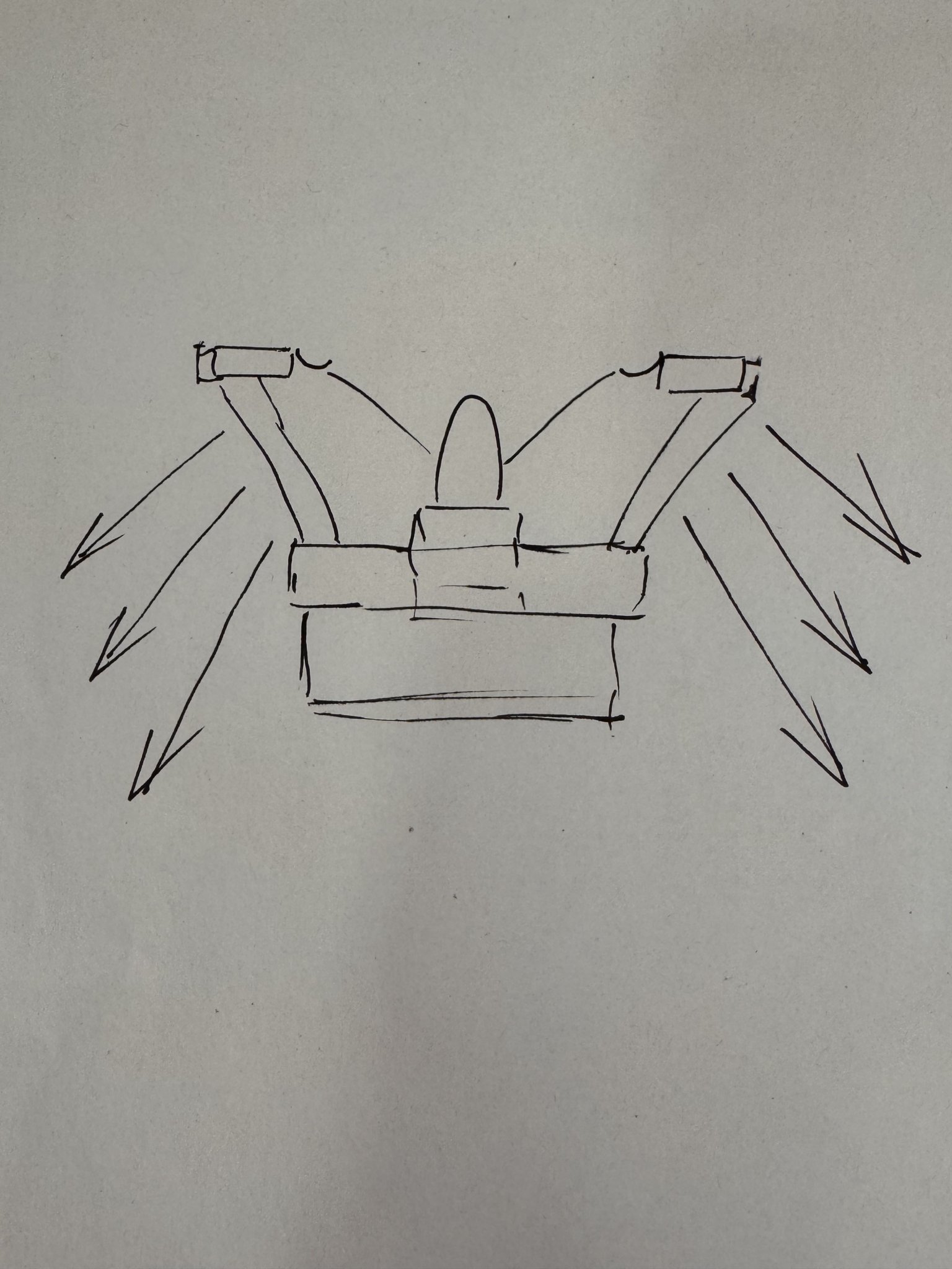

Am I correct in assuming that as mid and higher frequencies radiate more direct, much of these are directed at the near sidewalls first as the magnet structure itself is in the way?
Would it not make sense to tackle these there?

Sound propagation hardly isn’t ray tracing at the frequencies involved (<3kHz). Don’t think of it that way.

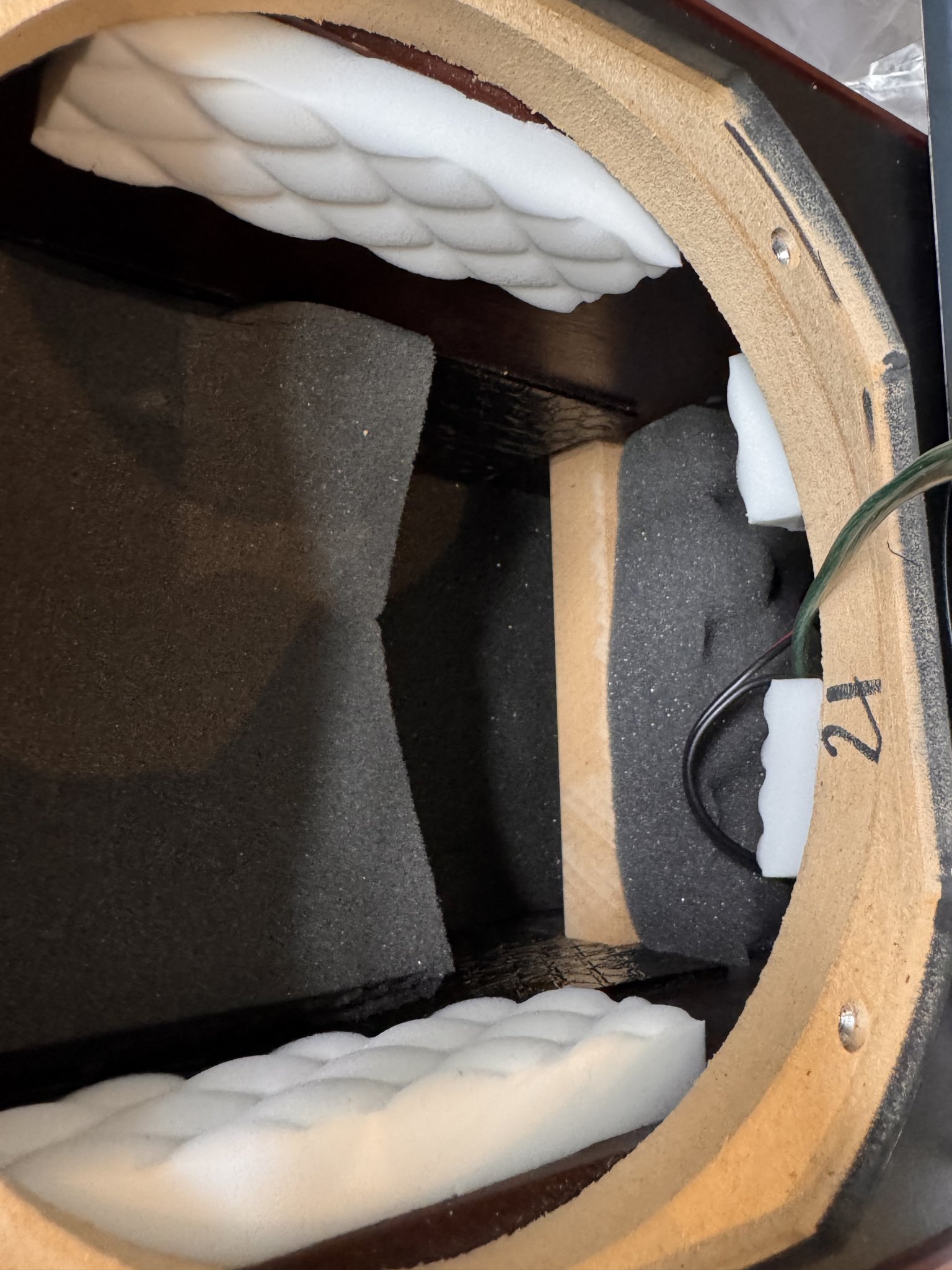

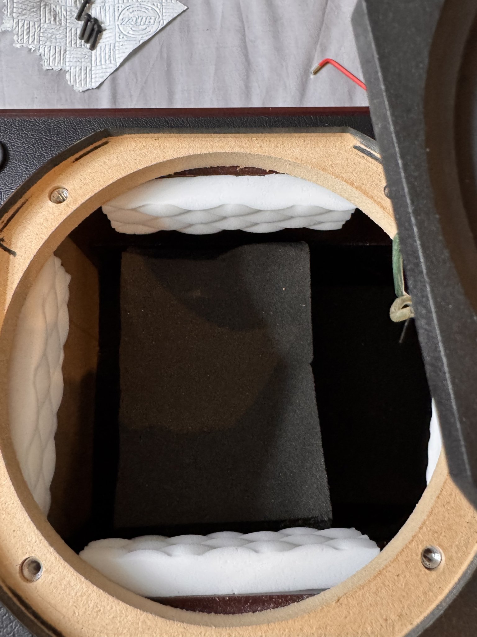

I’ve changed the configuration of damping; I halfed the size of the pad direct behind the driver leaving space to either side. Added ‘miracle’ sponge (melanine foam?) to either side of the driver.
The result is similar to before adding any damping/stock insofar that lifeliness has been restored at cost to a slight ‘boxyness’.
I guess the melanine foam pads don't do much as a/ they are attached to the walls rather than in free space and b/they are to thin to be effective.
Onwards to find an in between solution 😀.

To be honest, I would consider stuffing is used to try and cure a problem rather than solve it; a tapering wedge, even if folded, works much better than stuffing a box. I wonder if blu-tacking in some thin wood or cardboard panels inside might be worth playing around with.

Well, it continuous (my by ear tuning attempts); Having added the additional foam the top enclosure now excites a (very) strong mode. Further underlined by quite some resonance through the front 3 ports. Putting my hand over the ports I can feel all 3 resonating/vibrating.
I guess (!) the added foam has increased the top cabinet enclosure. The outcome ... not good. I will remove some of the foam and just leave one piece mid cabinet behind the driver. That seemed to have been the best compromise.
I may continue after this with some front port obstruction and see what the outcome of that is. Far easier to do than continuously taking the drivers out too.

Not that strongly. It literally is one mode, very strong that was not there before. The change of volume/foam has clearly excited the enclosure, not in a particular enjoyable way I may add.
I won’t say it’s not true, but think it’s unlikely that absorbing stuff causes resonances. The only possibility I see is that a standing wave has changed due to the damping and somehow its velocity node ended up at the port end inside. But without measurements it’s just guessing.
