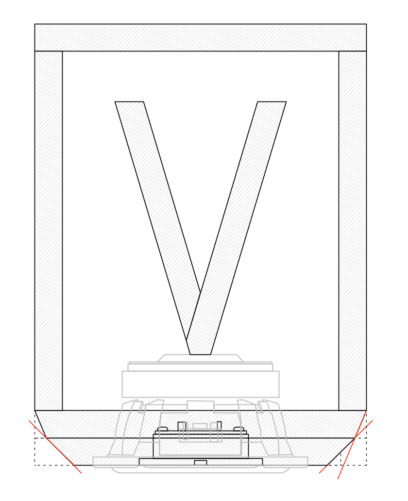

The previous answers are all great. My two cents, or maybe it's a dollar with inflation. It's not very scientific but I find pulling the driver out and then just singing a range of notes into the opening for the woofer will immediately reveal any resonances that cause boxy vocals directly to your ear. If you own a dog, it may join in with a howl. You can also place a speaker near the empty opening and drive it with a generator and slowly sweep through the frequencies. I find that the Hornresp free software can model a cabinet cavity and accurately calculate and plot the internal acoustic resonances. It also has the ability to model added damping with adjustable thickness against the walls. You will quickly find that longer / slender cabinets have a low internal mode frequency that is very difficult to damp as damping material effectiveness drops off at low frequencies (below ~ 300 Hz or so ). I only build half cube shaped enclosures for this reason. I've found that rockwool, fiberglass batting, lambswool and engineered fire retardant acoustic foam all work. The effectiveness is proportional to the density, so the acoustic foam works, but due to its fixed density, is the least effective. The others can just be packed in as loosely or tightly as desired. As velocity is zero at a wall surface (perpendicular to the wall) only putting thin layers on the walls is less effective than filling the open space. Adding stuffing to ported speakers will lower the Q of the port and reduce the output. It works well to put fiberglass or rockwool into a fabric bag to make an acoustic pillow that is easy to place or remove.
I use a U shaped baffle made from a section of R13 rockwool hung behind the driver. Its suspended by shoelace material so it hangs firmly behind the driver basket. If the driver has an exposed VC gap which could be susceptible to loose debris or particles getting inside, i use a piece of grille cloth to contain the dampening material.

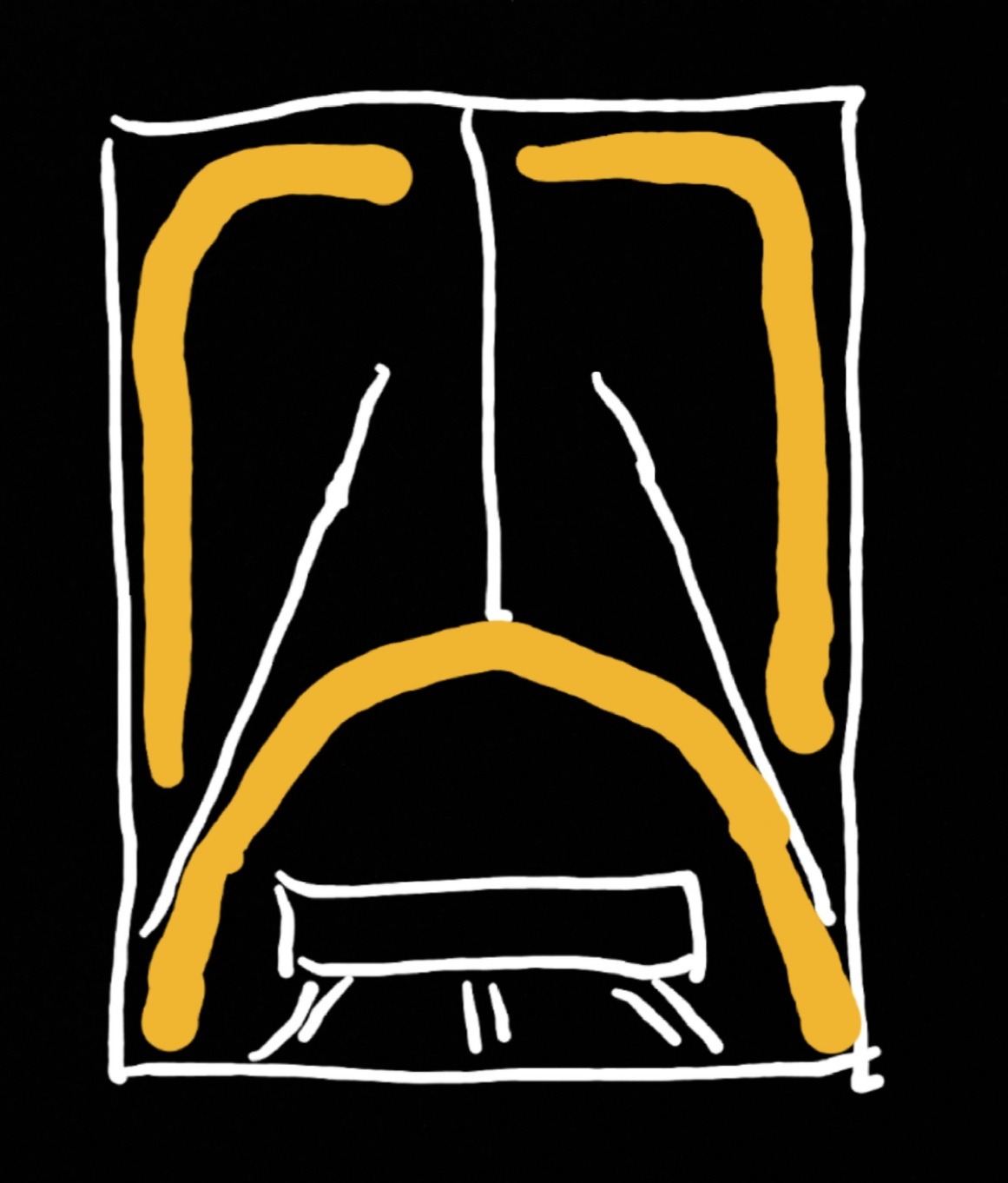

For new designs, I also build internal baffling to break up parallel walls, as seen in the rough sketch below.
The divider perpendicular with the back is extraneous. What we have is a closed midTL. Dampl heavily to push aperiodic.
This accomplishes the same thing.
proi’s sketch is much like my quarter-wave midTLs.

I put in the rear devider on larger enclosures to break the 1/4 WL width mode. It doesn't do much on smaller drivers but sometimes it can help clean up that last little bit on a 12" or 15" midbass.
Making it a holey brace and spreading the side to side might be more beneficial. And i’d use it to bnracve the driver to the backof the box.
dave
dave
The width shouldn't behave any differently with/without a divider if everything is symmetrical in that dimension. A mode is only effective if it is driven.to break the 1/4 WL width mode.

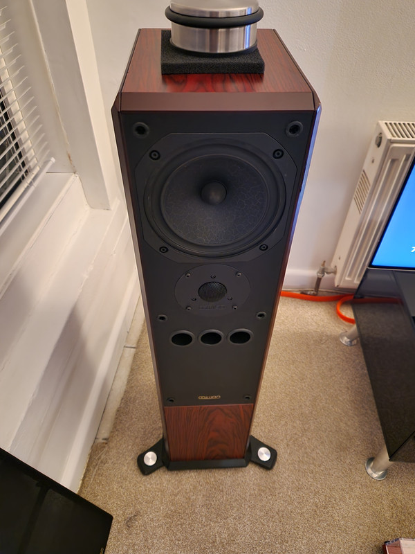

All very interesting and I am learning. So I bought a couple of speaker damping open cell foam 'panels', 5 cm thick with 'wedges'. For ease, I will just attach them at the rear of the main driver magnet. I don't think I want to add any bracing as access is limited. The internal width of the enclosure is approx 20cm so I will cut the to size. I am not sure just how flexible that foam will be in such a small size but if I understand correctly, it (foam piece) should ideally be mounted on a perforated sheet of ... (?) to prevent flexing?

4 vents is a bit weird. The tweeter is quite interesting (i guess it is a superTweeter given what looks like a tweeter at about knee height under the woofer. Note that given the XO of a superTweeter, it should be as close tothe tweeter as possible.
This loudspeaker will be an ML-TL given the aspect ratio of the box, the placement of the woofer, and vents. From the vents placement one would suspect that the designer didn’t know that (where is the one on the back?)
I am not a big fan of foam for damping*, but it does not need to be firmy attached, but it shoulod be sliceable such that it iis friction fit. In an ML-TL damping can range from lining of the walls, to completely filling it will some variety of polyfluff.
*(i like using it foraperiodicm venting.)
How is the bass? What are the internal dimensions? How far from the bottom are the vents? Distance of driver centre from top.
Without the T/S of the driver it is not really possible to simulate it, but someone like Scott (@Scottmoose) can probably offer some inights intothe resonant structure in the box.
One start to specualte how one could rejug all the bits to get better performance.
