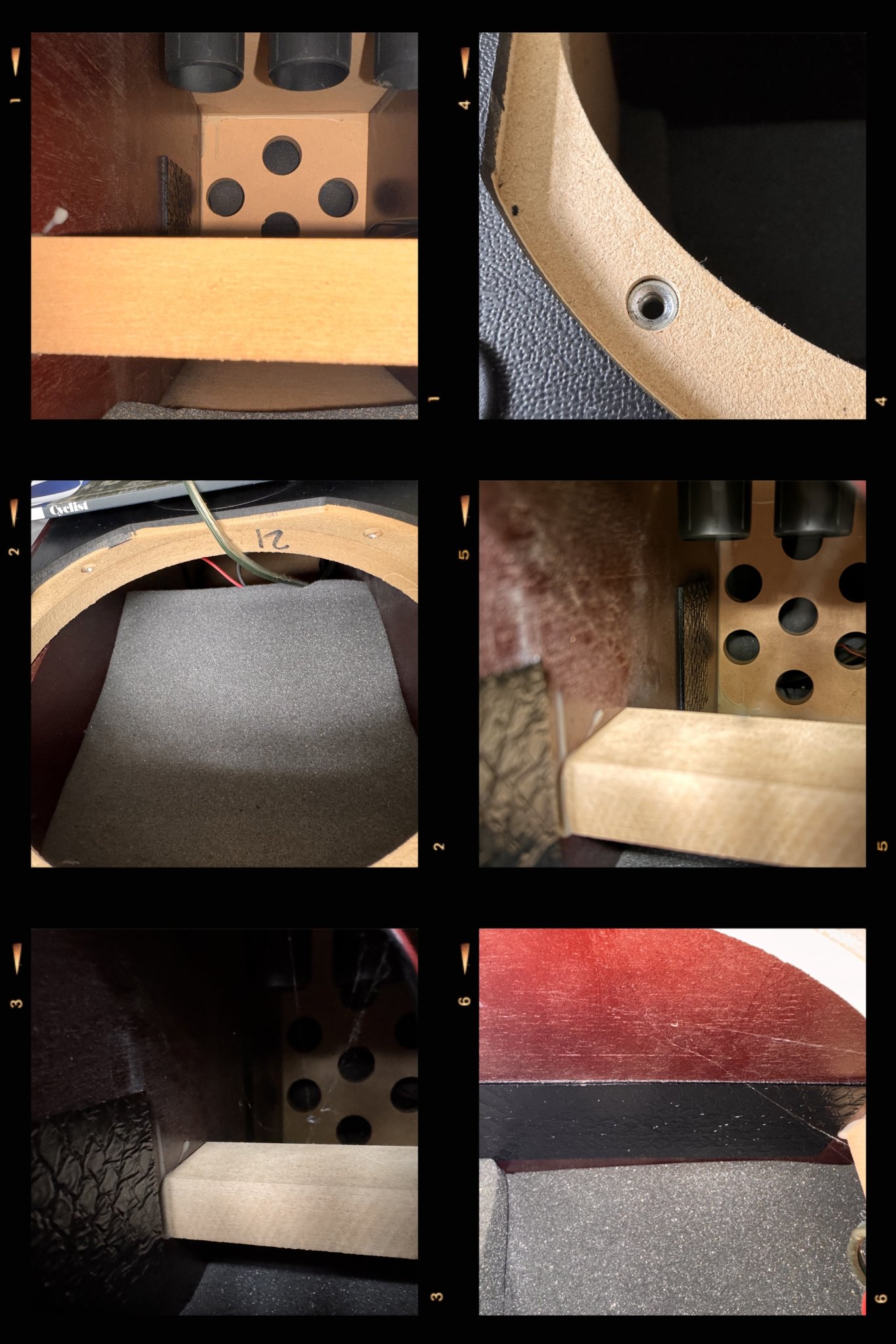

Yes, it's a rather unusual arrangement. Here are some details:![]()
4 vents is a bit weird. The tweeter is quite interesting (i guess it is a superTweeter given what looks like a tweeter at about knee height under the woofer. Note that given the XO of a superTweeter, it should be as close tothe tweeter as possible.
This loudspeaker will be an ML-TL given the aspect ratio of the box, the placement of the woofer, and vents. From the vents placement one would suspect that the designer didn’t know that (where is the one on the back?)
I am not a big fan of foam for damping*, but it does not need to be firmy attached, but it shoulod be sliceable such that it iis friction fit. In an ML-TL damping can range from lining of the walls, to completely filling it will some variety of polyfluff.
*(i like using it foraperiodicm venting.)
How is the bass? What are the internal dimensions? How far from the bottom are the vents? Distance of driver centre from top.
Without the T/S of the driver it is not really possible to simulate it, but someone like Scott (@Scottmoose) can probably offer some inights intothe resonant structure in the box.
One start to specualte how one could rejug all the bits to get better performance.

I like the bass and have no issues with it. The rear port is not that far off the ground, so much lower than the front ones.
It's a double-chamber reflex (DCR), with some asymmetry to the venting. The larger upper chamber has the three forward-facing ducts, and it vented internally to the smaller lower chamber through five or six (IIRC) holes that were simply of panel-thickness length. The lower chamber had a single rear-firing duct to the external air. As a minor addition, the larger upper chamber had a longidudinal panel open at the top & bottom (since this was nominally a Helmholtz design). Mission described this as their 'Transverse Folding Technology' -which speaking under correction was basically a synonym for a bracing panel for the side baffles. 😉
From the measurements I've seen, it's classic DCR: unequal triple impedance peak, and the usual cancellation null just above the nominal second tuning. Presumably the asymmetry of the 'external' venting was to maintain some visual connection with its 752 predecessor and they'll have juggled the proportions of the holes in the internal baffle to avoid the need for an extra duct there, and reduce the requirement for more on the rear. This is mid-larger scale commercial audio, so saving a pound or so makes sense when possible. What measurements I've seen, from memory, suggests to me it was slightly detuned / or not optimally so anyway, resulting in a bit more cancellation from that cause than you'd hope for, though it wasn't terrible: a reasonable tradeoff in the eternal performance / profit scale.

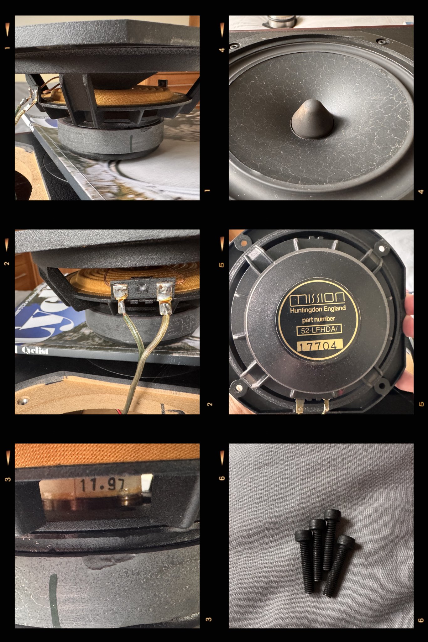

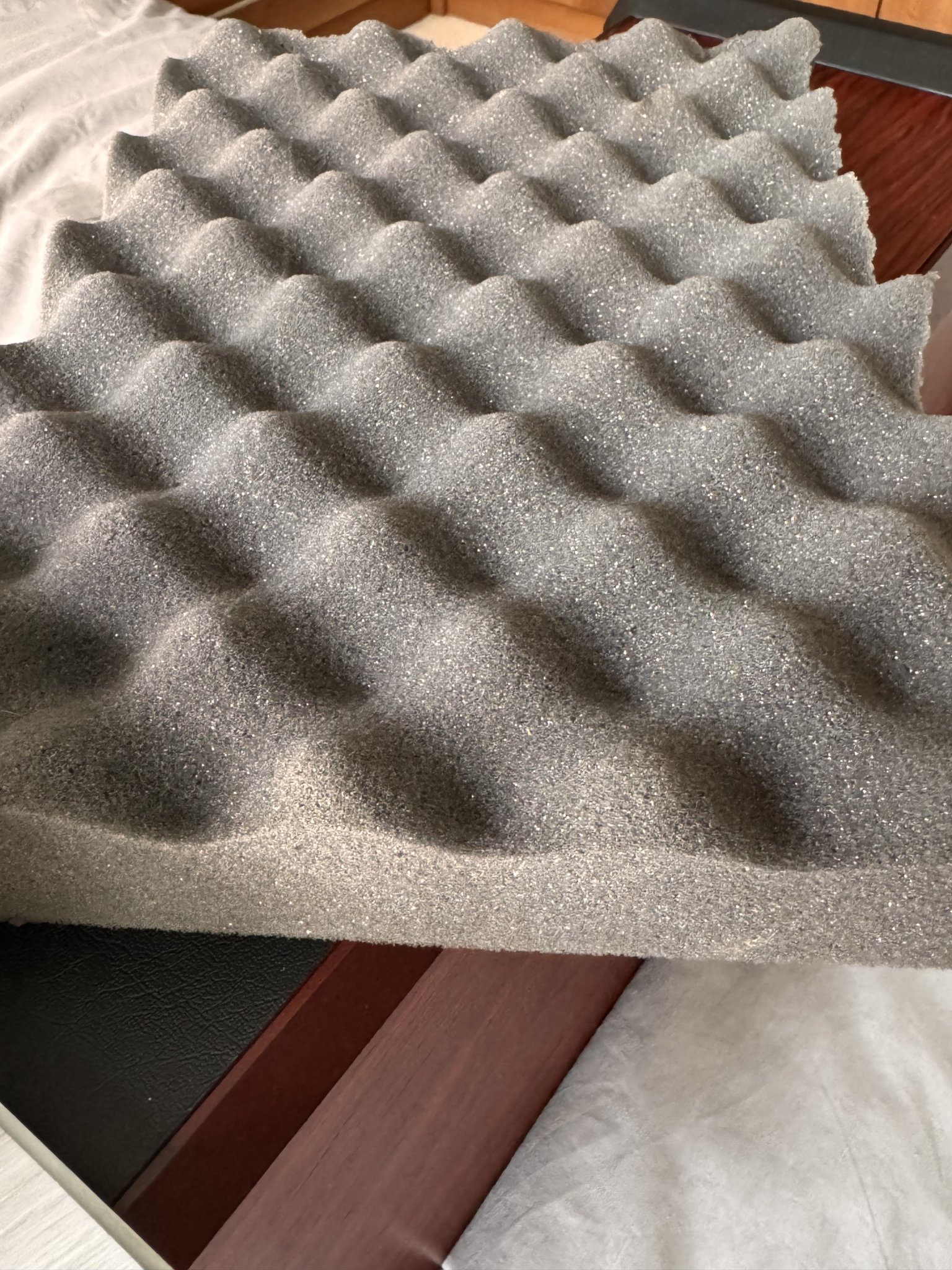

I've now added the foam to the upper enclosure. Solid cast driver and again, nice to see proper bolt and nut fixtures rather than wood screws! Internally, damping was minimal in the upper enclosure with only some mastic sound deadening pads applied to the side walls and foam attached to the rear. There is cross bracing as well as a division with holes which, underneath (lower enclosure) is damped with foam. The cabinet walls seemed to be veneered inside too and thick, an inch by my estimate. I have cut the 5 cm foam to size so in now is the width of the internal cabinet and extends approx 3/4 down the upper enclosure, half way between front baffle and rear wall ie. free in space, leaving the front ports unobstructed.
The result, listening to voices only (BBC Radio) is fuller, more direct with less of that (very slight) hollow/resonant sound I commented on before. I was nitpicking before as I really liked the sound already but it is definitively audible (or not audible anymore more correctly). I acknowledge this is a highly unsophisticated method with absolutely no measurements, but it's the best I can do for the moment and I am very happy with the result. The side walls immediately to left and right of the driver are still bare and I may try and put a little foam there too, leaving the side vent structure of the driver unobstructed but for now I will just try and listen to some different material, then evaluate.

After listening to music I have the impression that transients are now slightly compressed. Now I am not sure if this is the more accurate version but it takes a little bit of ‘fun’ out of the equation. Not too much but its noticeable. Great for timbre, a little bit less for PRAT. I will perhaps try and cut the foam to a round shape, matching the driver basket in its entire width and attach this directly to the magnet. As is, it (foam) forms a complete division between driver and rear wall, open only downwards.
My guess is it impedes the air flow to the driver somehow even though my belief was, probably wrongly, that open cell foam shouldn't do this.
The other option, as mentioned before, would be to just use foam in strips all around the driver inside the front baffle, leaving some gaps for venting.
