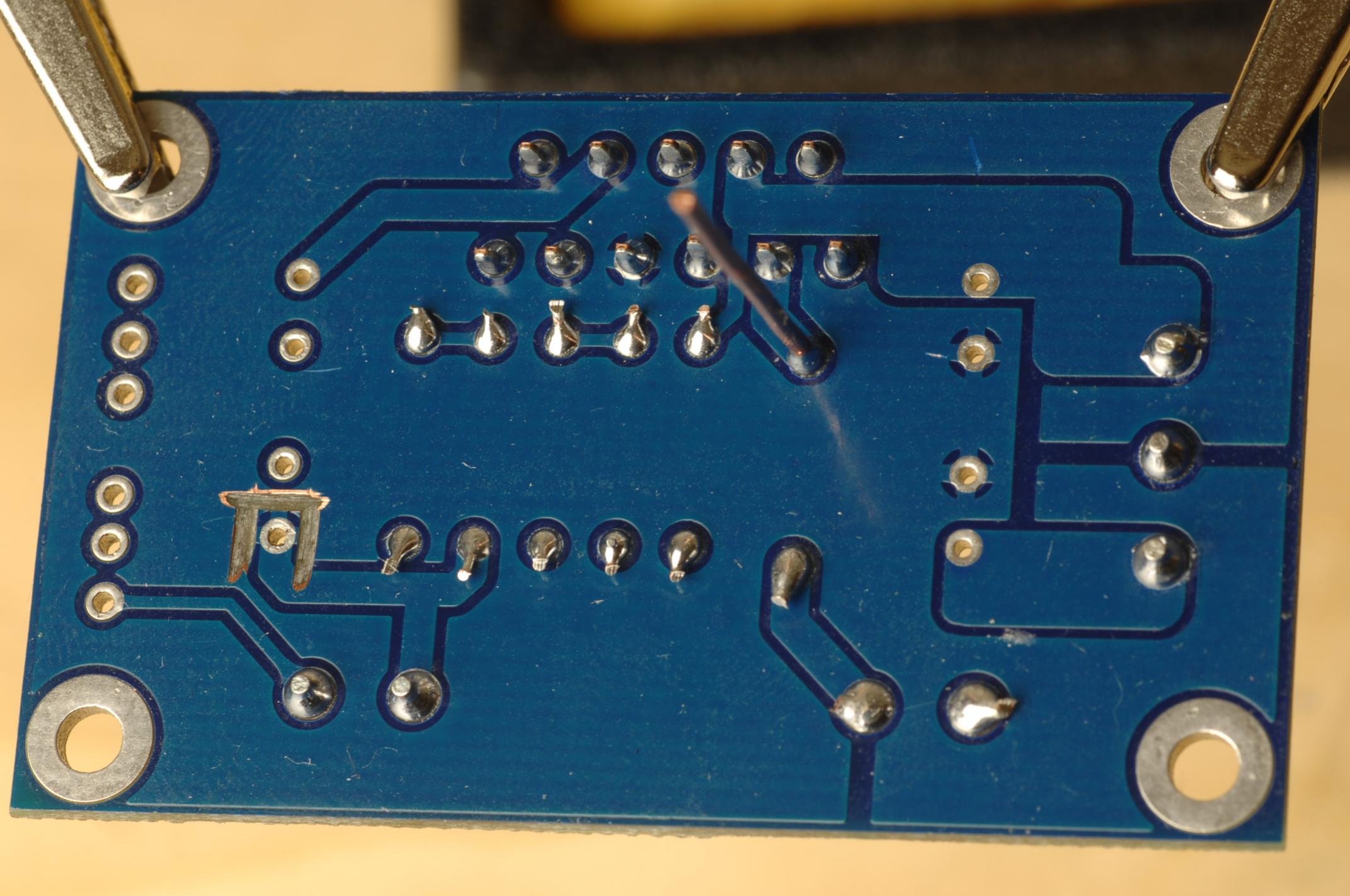

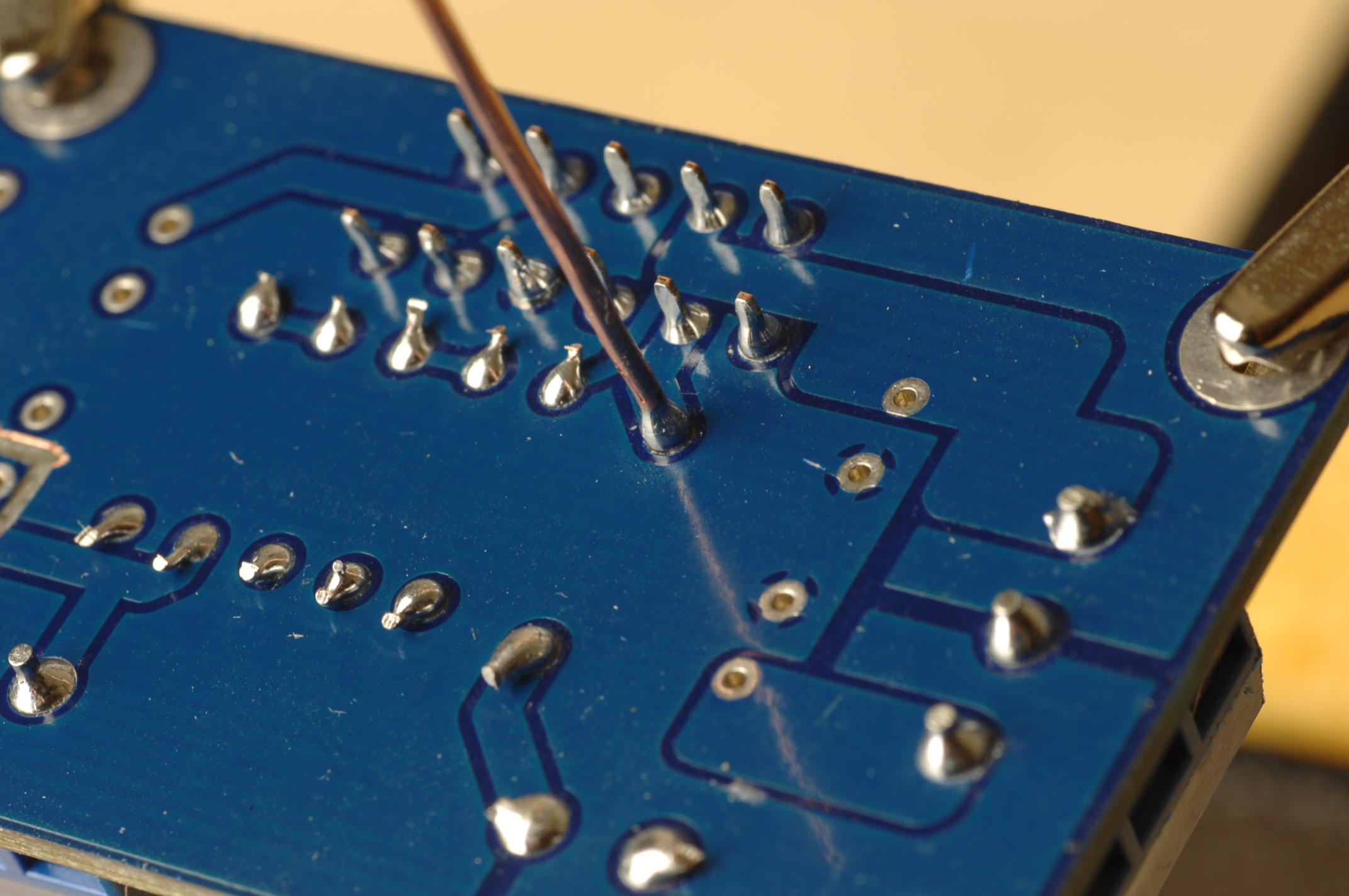

Bought a XY LM3886 Kit
The last two pictures.
Here, the last two pictures.

Hi AndrewT:
The RF capacitor is 0.001uF (not 0.01uF), I bought it taking the value from your previous post, where you recommended a capacitor from 220pF to 1nF. I decided to go with the higher values of all your recommendations, since I couldn't find any 1nF capacitor listed in any of the online catalogs because they use uF values, I used an online calculator that produced the 0.001uF equivalence to 1nF. Is this then right?.
Yes, I know what you mean with the "blob soldering joins", I have to get better at this, I was practicing a lot before with old PCB boards I have from computer upgrades, soldering and desoldering, this is my first time doing this, but yes, I know I need to get better.
Let me know about the 0.001uF, which according to the calculator I used is equal to 1000pF.
Thank you!
Lanchile, thanks for the advice, I cleaned the boards with 91% alcohol before soldering, also the legs of all components, and most of them got scraped when I inserted them into the holes, since I used bigger 1/2 watt resistors, the legs were a little tighter in the board's holes. I don't have any cold joints, I think that what AndrewT is saying is basically that I used too much solder in some of the joints on the upper side of the board. I need to get better at soldering components together (not through hole) using less solder.
Fabricated, all the amp chip legs are very well soldered at the bottom of the PCB, I checked every solder joint using a very strong LED flashlight, when I place the flashlight right under the PCB, I can't see any light filtering through the LM3886 or any other component's hole.
I appreciate your observations and suggestions anyway, thank you.
