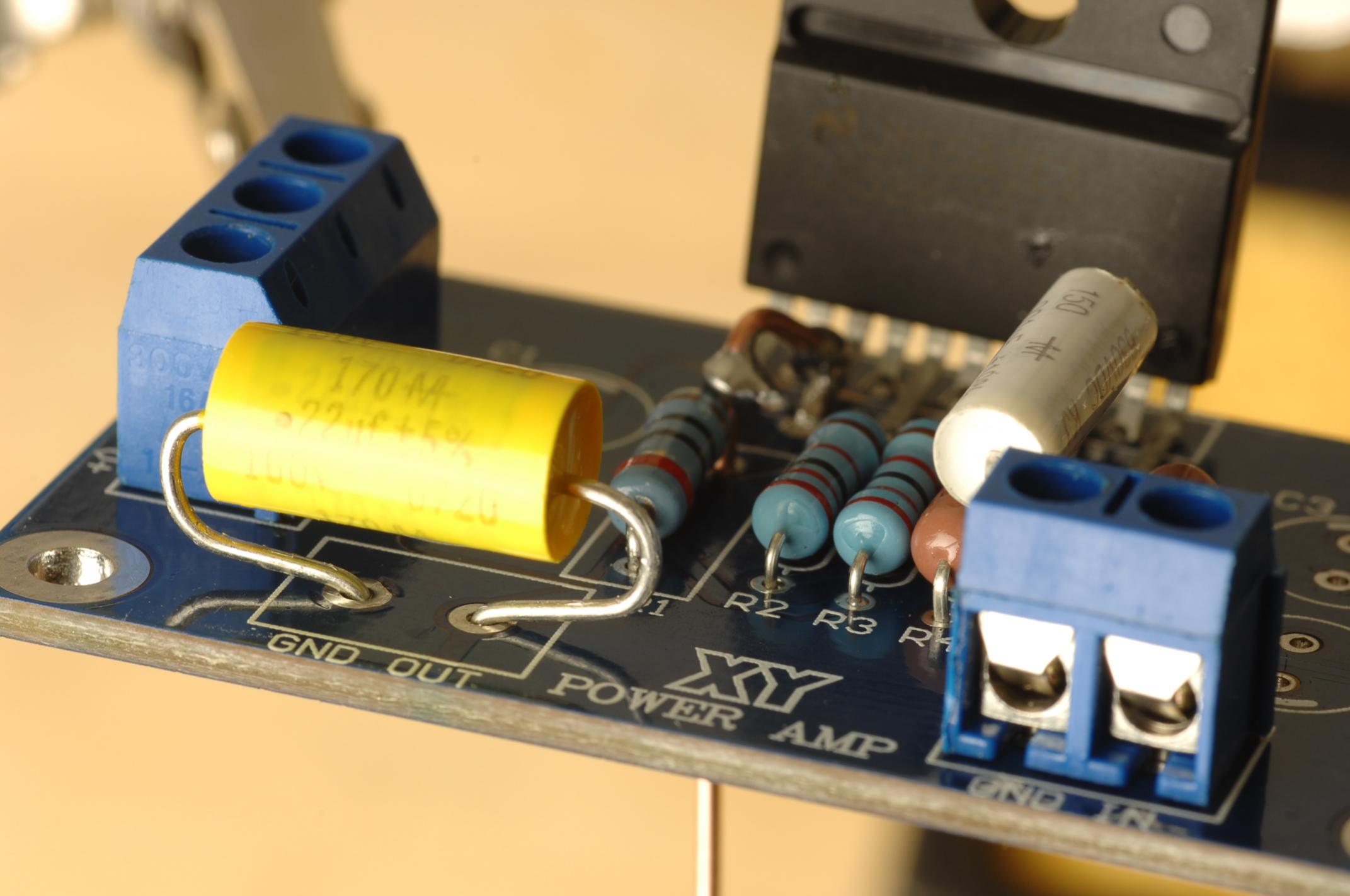

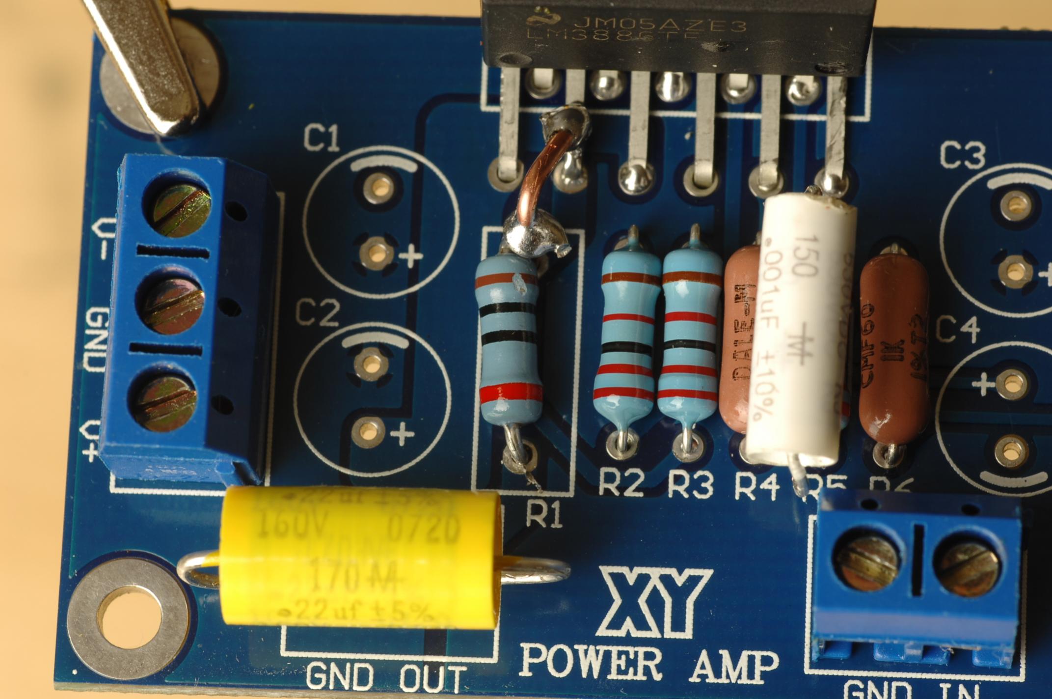

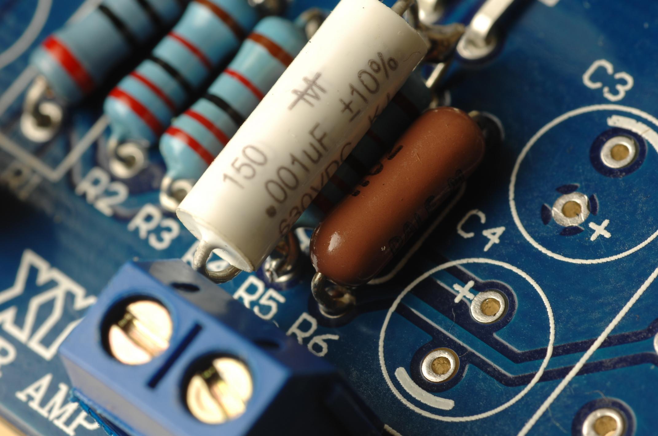

Not quite.
The R1 bottom hole takes the lower end of the Zobel resistor.
The R1 top hole takes the copper lead. Make the lead about 12mm long. 4mm below the PCB and 7mm above the PCB. Attach the speaker output cable to the 4mm of copper lead below the PCB.
Attach the Zobel resistor to the 7mm of top side copper lead.
The Zobel capacitor connects to PCB instead of the speaker terminal block.
One leg of the cap connects to the trace of R1 The other leg of the capacitor connects to the Ground trace.
That 7mm of copper lead is left long to allow you to bend it to an L shape. The short leg of the L gets soldered to the leadout of the chipamp.

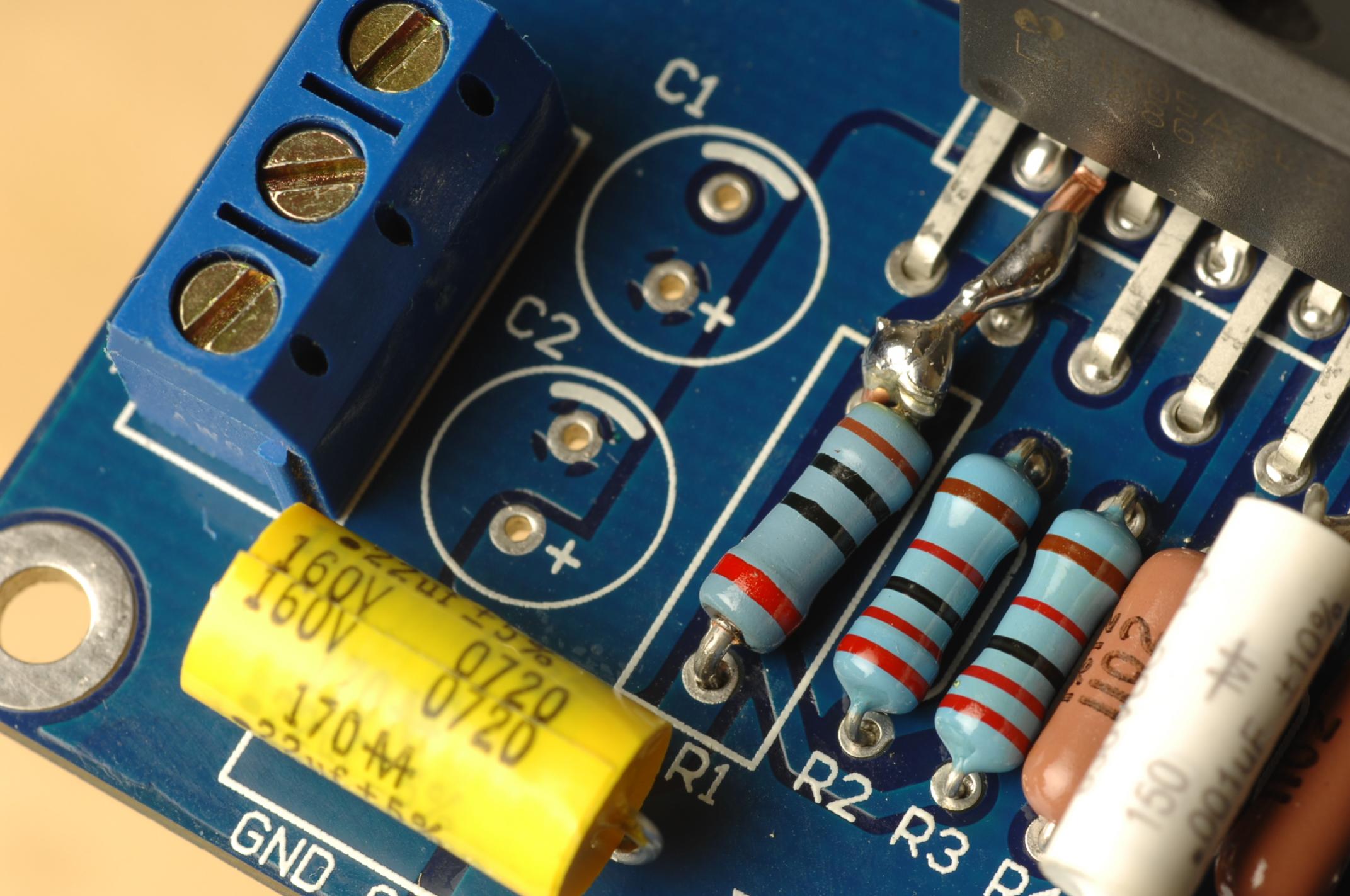

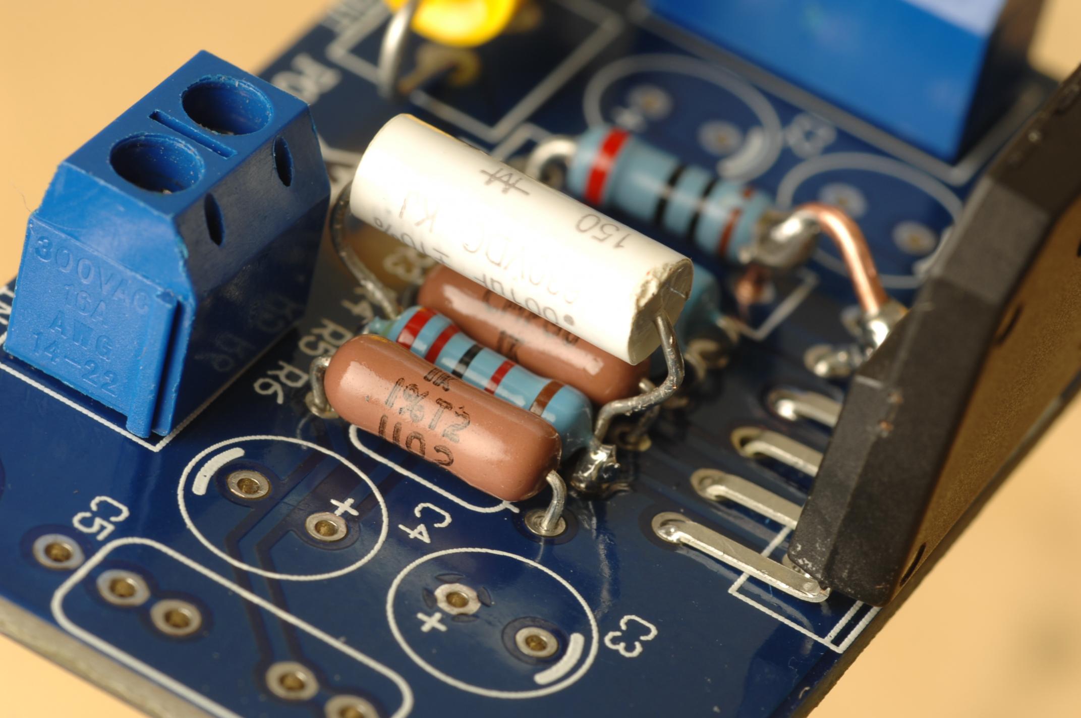

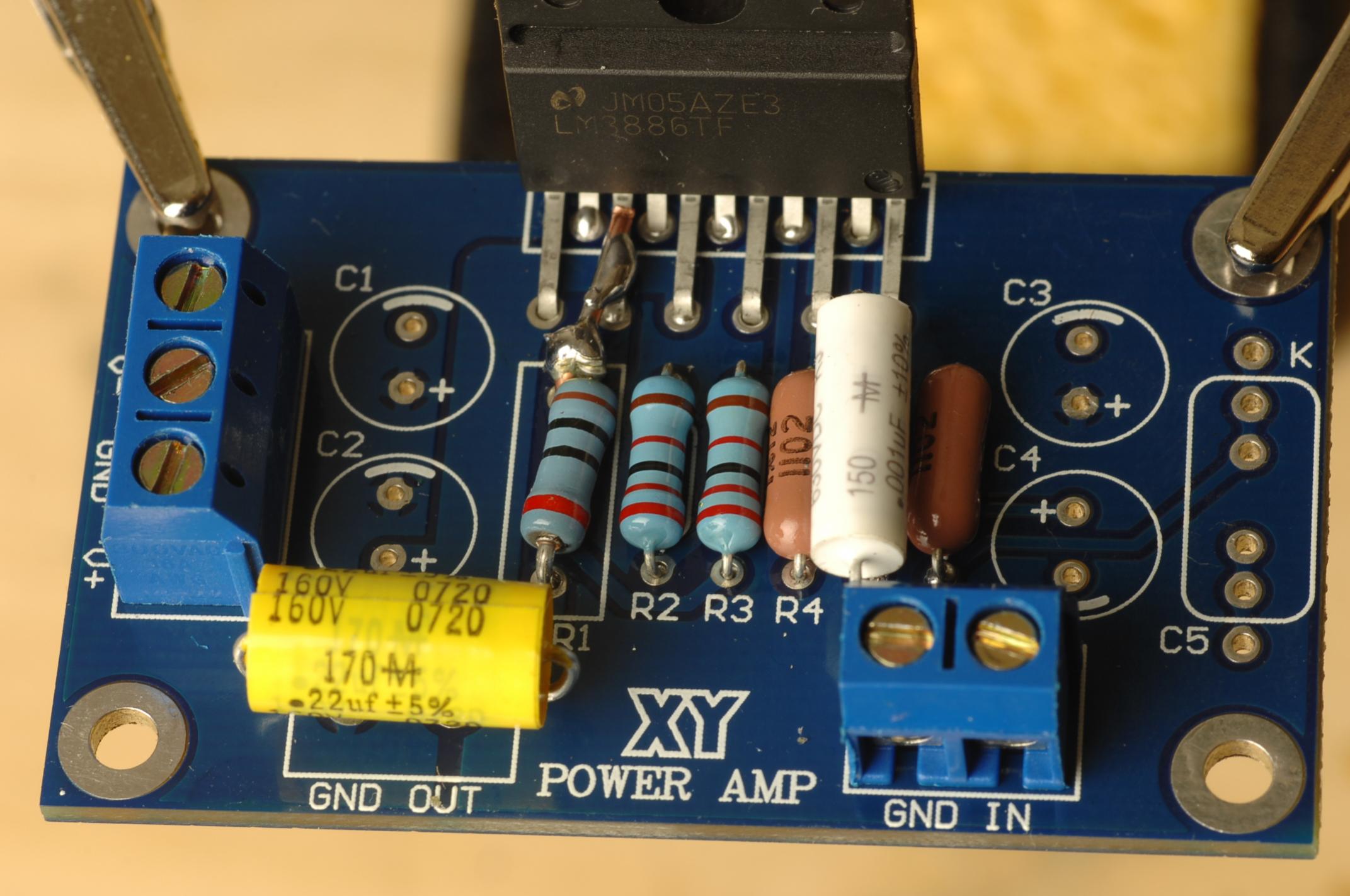

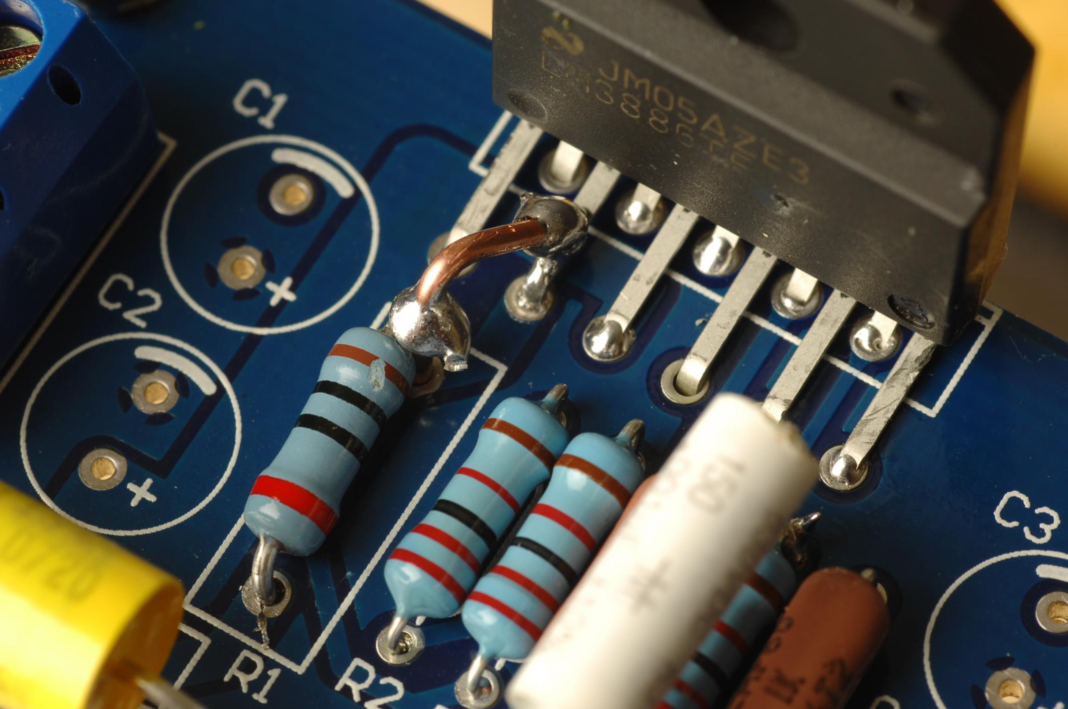

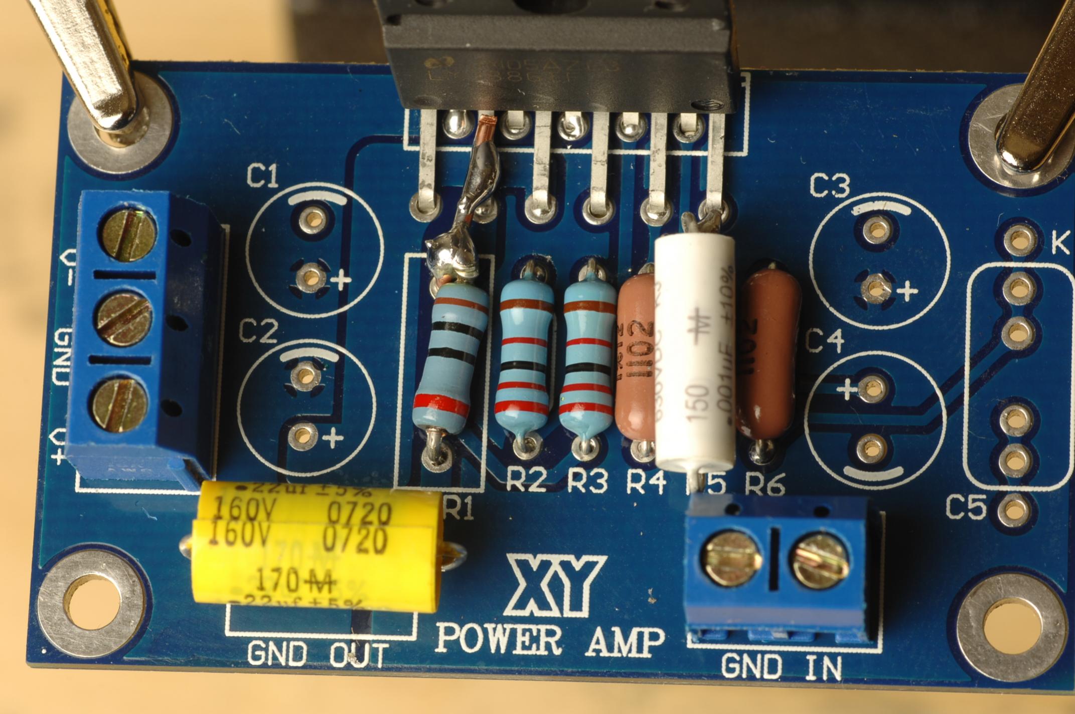

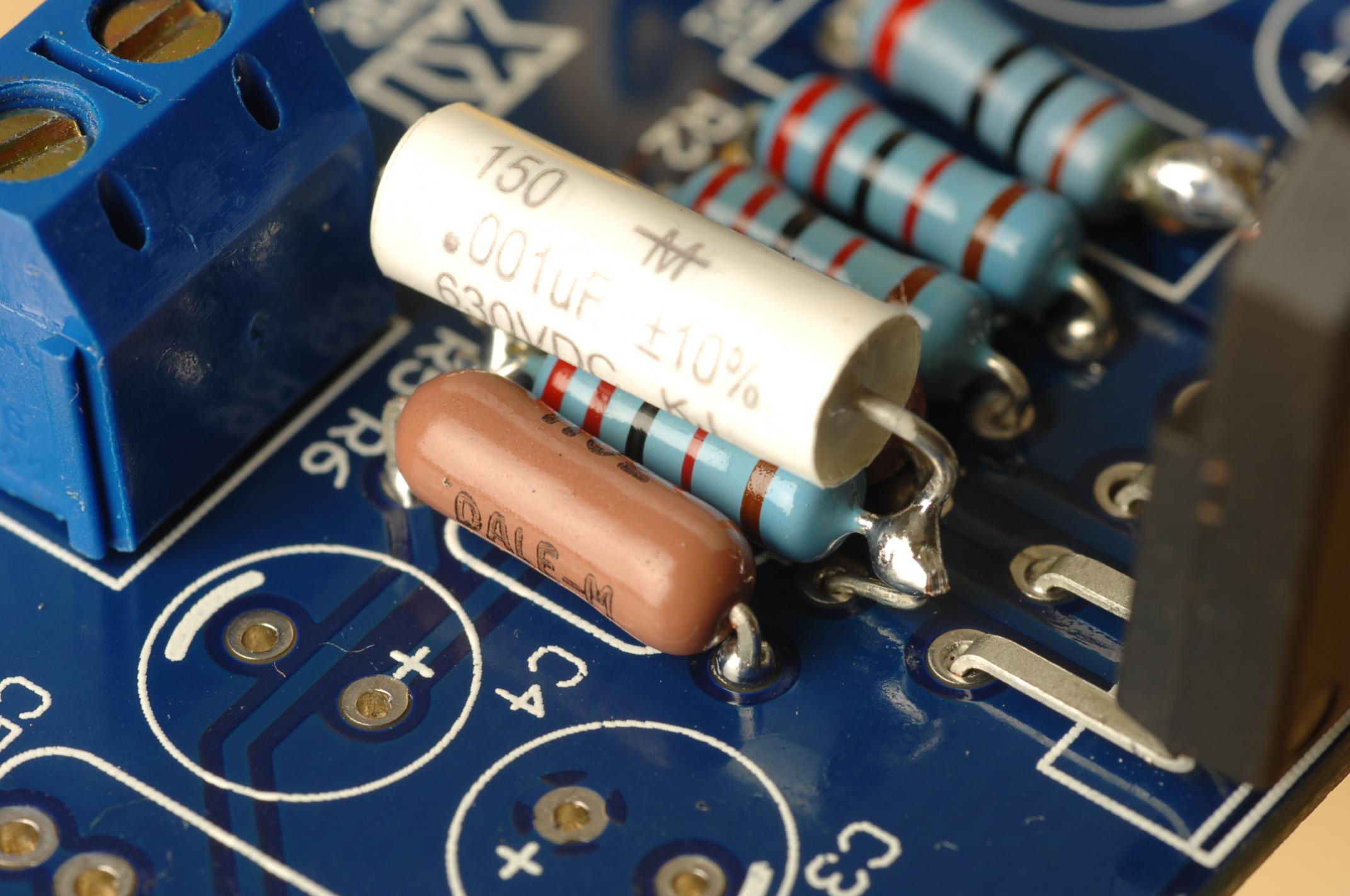

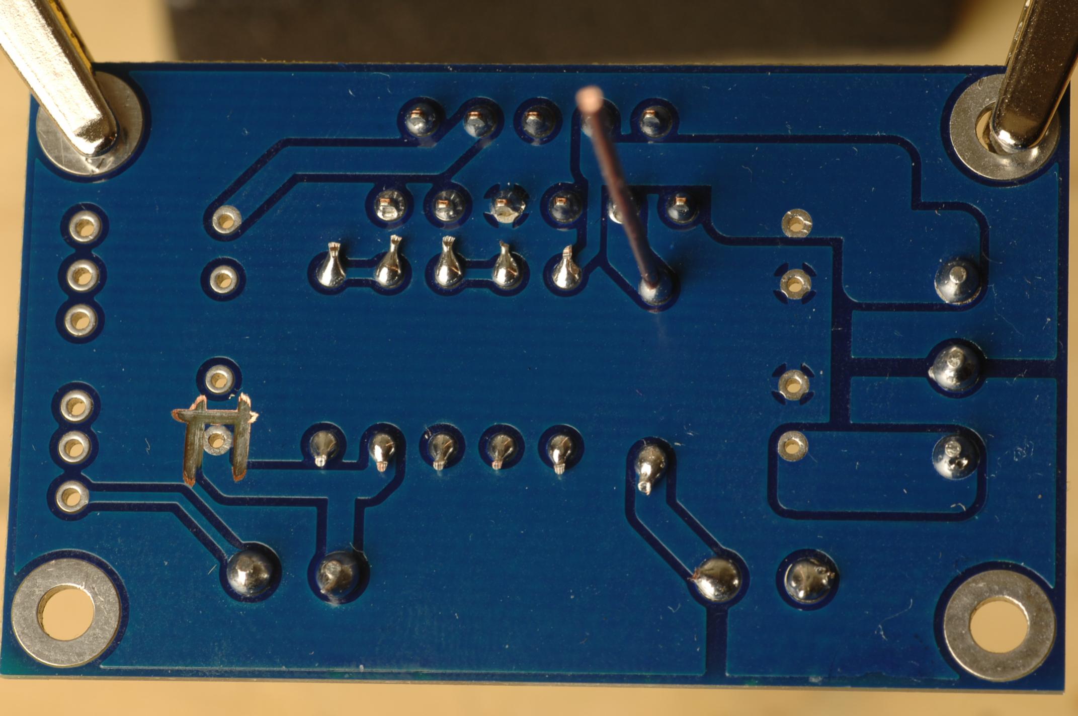

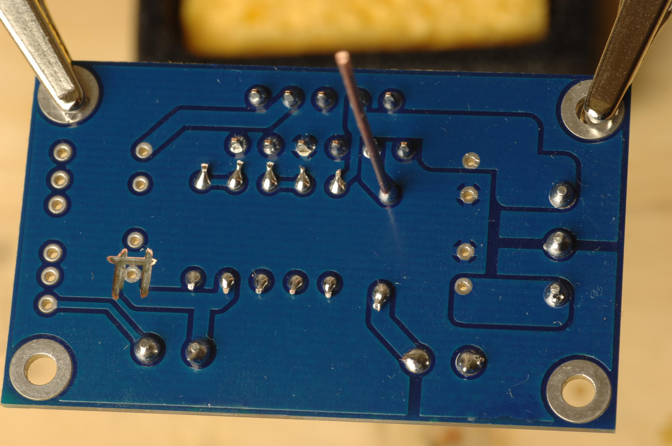

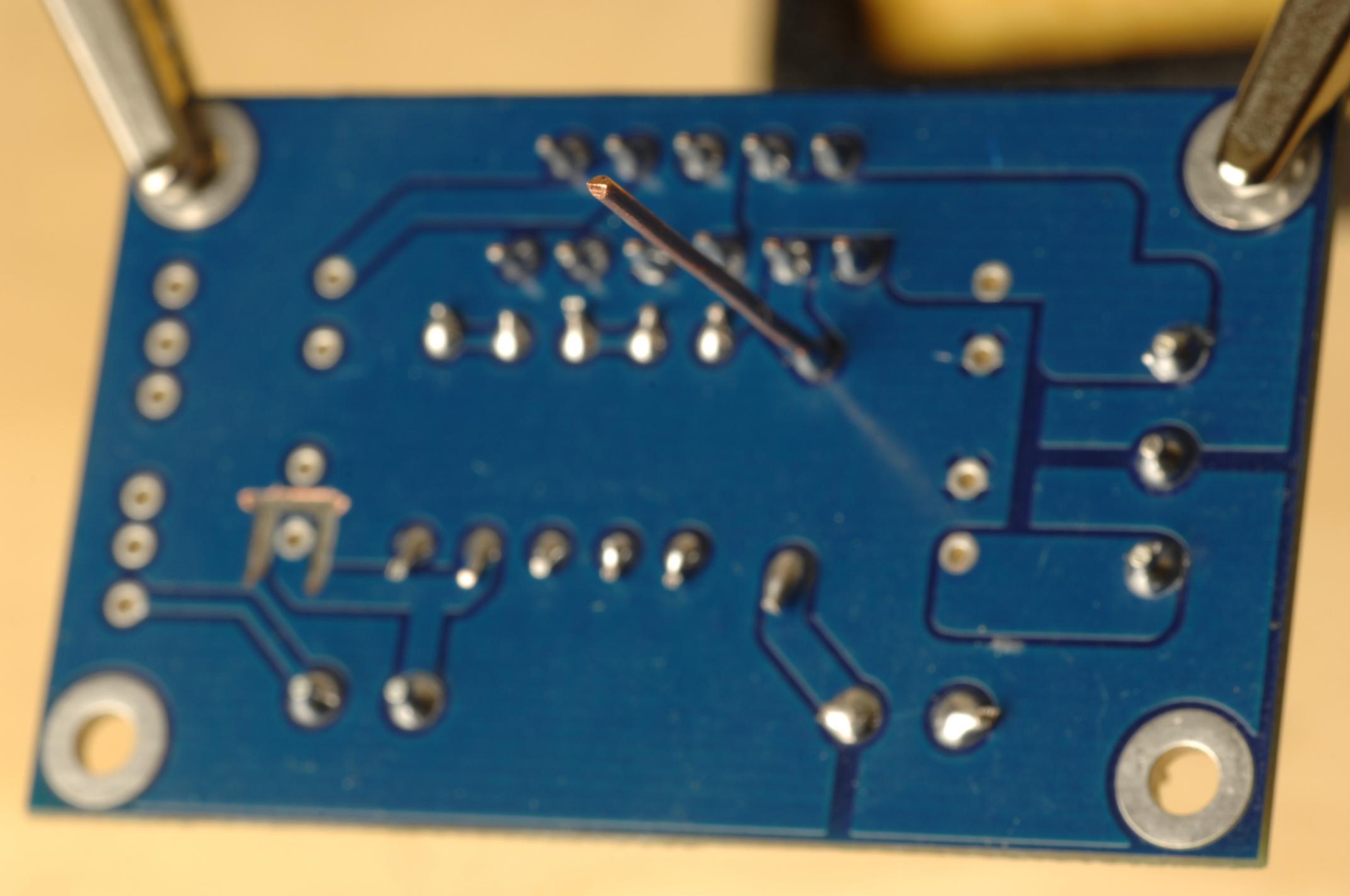

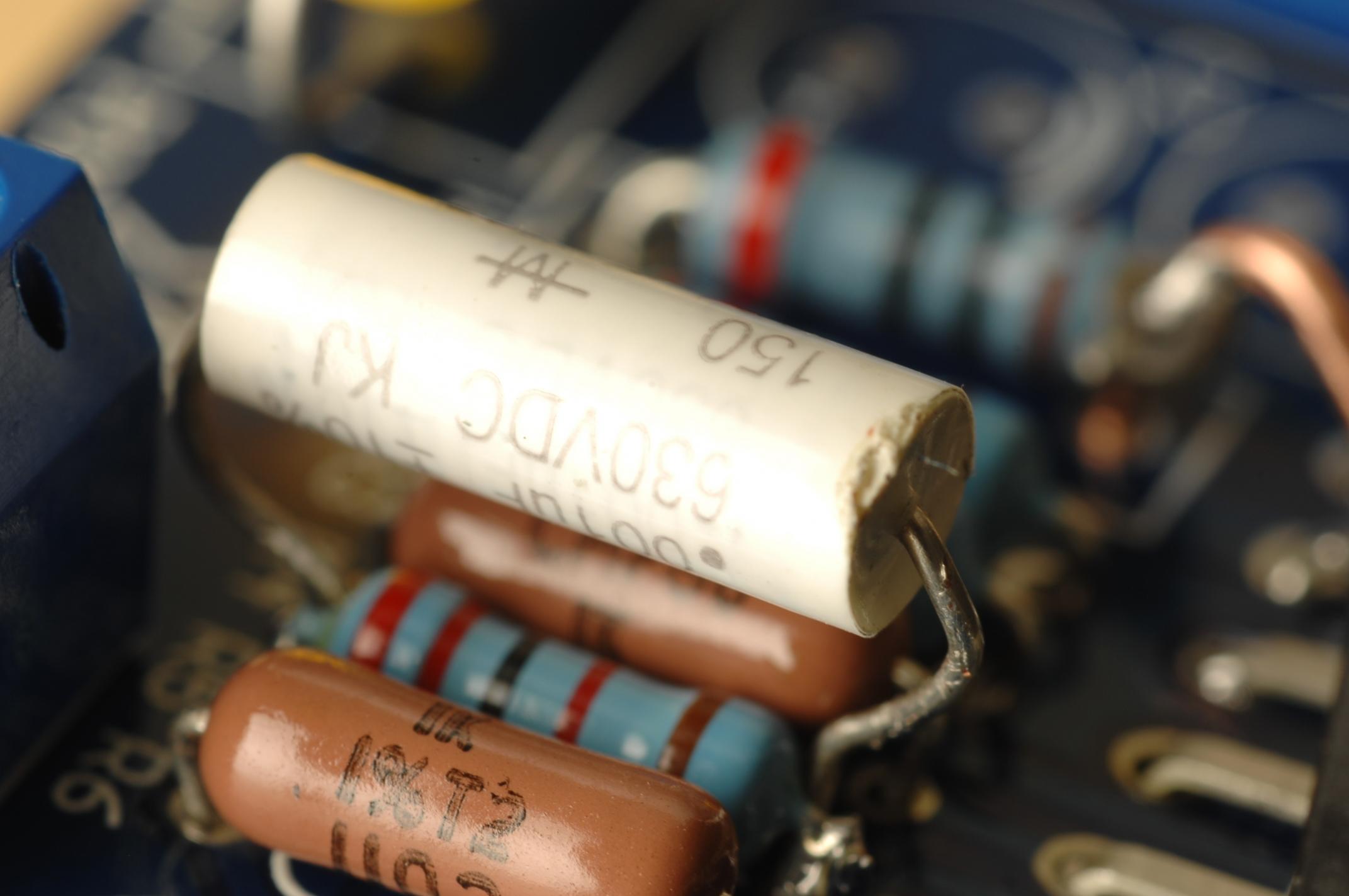

Zobel R+C Implemantation by AndrewT
Hi:
Here are some pictures of the modification made to the XY LM3886 boards to include the Zobel R+C network, a very clever way of doing it, all credits go to AndrewT who gave me all the instructions and component values.
I just hope I got it right...!
You can also see the RF filter capacitor on top of the R5 resistor. That is a 0.01uF polyester film capacitor.
The resistor used in R1 for the Zobel is a 10 Ohm resistor. The rest are 22K Ohm and 1K Ohm, I just upgraded to 1/2 watt resistors instead of using the microscopic ones that came with the kit.
The capacitor located in the speaker output connection is a 0.22uF polypropylene capacitor.
The rest of the capacitors (C1, C2, C3, C4 and C5) are missing, I am still waiting for them, they should be here either monday or tuesday. I will post more pictures as soon as I have the boards totally finished.
The bare copper wire that goes in the top of R1 location is a piece of 18 AWG solid core wire I got at Radio Shack, it fits the hole perfectly. I know I have to cut it, it is too long now, but I want to finish the boards to see how I am going to solder the speaker + output to it. The soldering in the "shorter L shaped end" that joins the copper wire, resistor and pin #3 of the LM3886 is kind of hard because of the location, one has to be extremely careful not to hit something else with the hot tip of the soldering iron, perhaps it might be a better idea to solder the copper wire to the leg of the LM3886 before installing it in the board.
I have included more pictures in the next few posts, I couldn't upload them all in this one.
I have more questions, but I'll save them for later, for now, I just want to know I got this right, and again, thank you very much to all of you that have been here sharing your time and your knowledge so generously, specially AndrewT, Pacificblue, Fabricated and all others.
