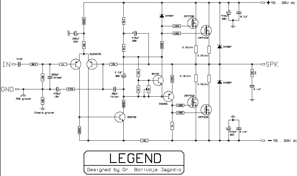

the original problem was when tryied to operate boras amp legend 4 with voltage 60-66vdc per rail ......
it all end up to almost 150 very expensive mosfets send to outer space while testing and trying to make it work ......
input was to sensitive to anything like a hot suap of plugs or just a litle bit of overdrive
bora of course recomended to add 0.18R 5W to the out of every mosfet as first change
and then a 33-56 pf miller styroflex capacitor between b and c on the MJE 340 vas amplifier to improove some ocilation was there
schematic is also available ......
still didnt work

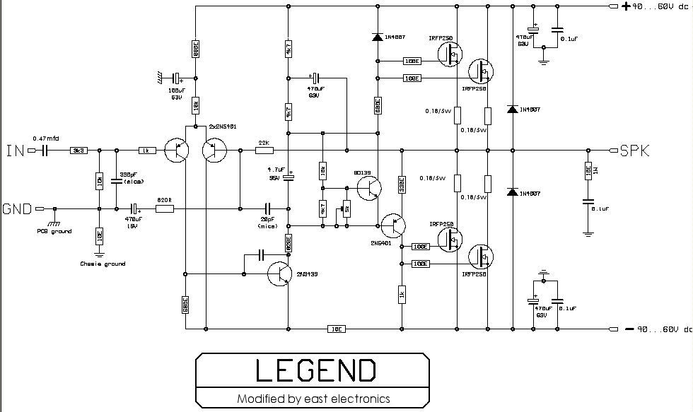

destroyer x a very nice guy from brasil his original name is Carlos Eugênio Mergulhão - Destroyer x and me worked out some mods and in real life this all seems to work no matter if used or abused ha ha ha ....
the new schematic is also available

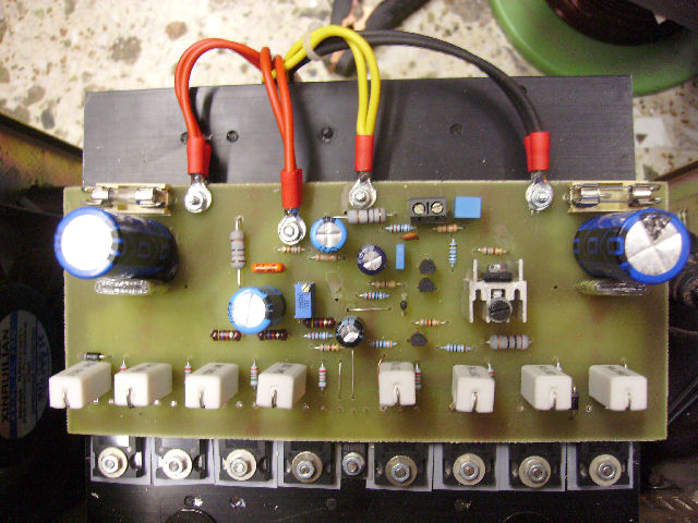

irfp 250 attachment to board
well this wasnt easy thing to do ...... i had to first solder all fets to board plan to fit them with 3mm metric allen screw but then in the heatsink was drills with 4mm diameter ....so any soldering mistake was covered by the tolerance of the hole .....
could also use a gamma corner to attach fets into hetasink but didnt want to use the efficiency of that particular hetasink cause is made from better quality alouminioum than the corner i had ....

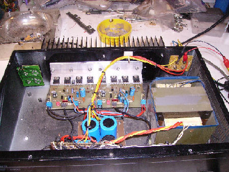

nice though ...produces about 240w and its very very stable ...... bench tests all come out very good but real life .....will see after easter ...i have some small show to produce and planing to use that ....just for fun !!!!!
irf atach....
well the truth is that i first soldered all irf in the board very very carefully and i used 3mm metric allen screws but in 4mm hole ...so lets say if a made soldering mistakes of 0.5 mm this could be covered by the tollerance of the hole ....
not very practical and it was done on existing heatsink didnt want to attach an alouminioum corner on it cause of size but also cooling effectivity .....
