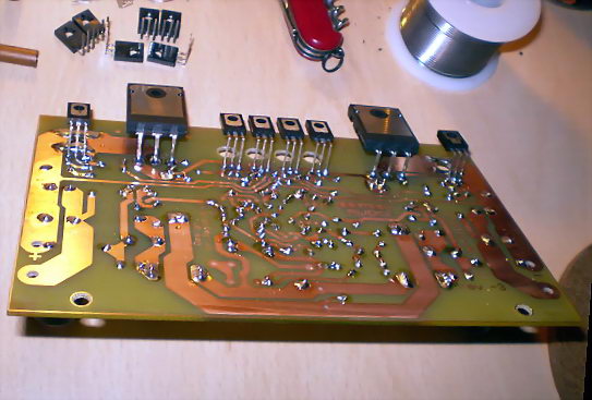

Final PCB
Hi ,
thanks , now I have soldered the last two component 1K trimpot
Hi ,
. About the sound ,maybe in this weekend I will testing 😀 Cheers Alex mmConstructed ?????

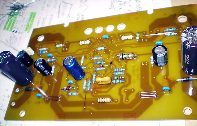

Studio from Bora.... this amplifier is sounding great
And more than that..... reproduces wonderfull sound stage, and this is a rarity.... we feel as the amplifier is "alive"
Those informations came to me from Eastern Europe... from a very good friend from Croatia.
I will try Studio Special Edition from Bora very soon.
And will not be the first Bora design i have built.... the man is very good.

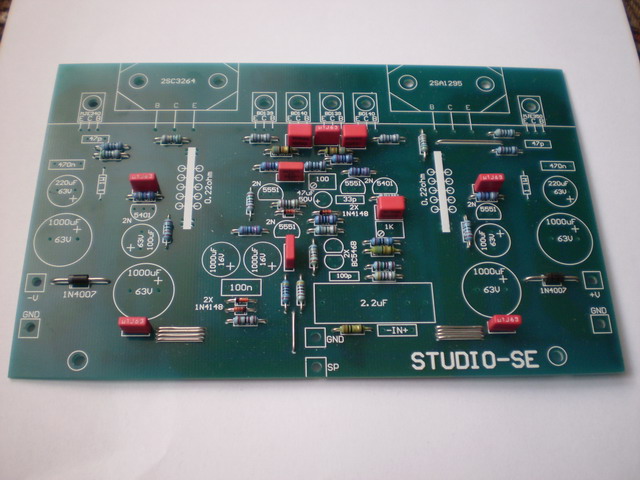

Studio was compared with many good brands
And have "eated" all them.... it is a very serious amplifier... a winner.
I will not be surprised if result better sounding than mine amplifiers... in reality i am afraid to compare, because i think it will eat my amplifiers.
Bora has discovered "what" into the circuit results in more perfect sound stage than others... and this is something no one knows...only he knows.

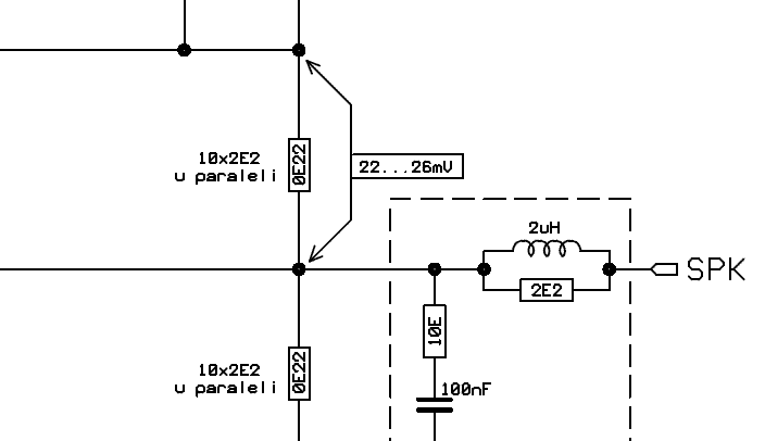

I am not sure dear Jacco.... i have to study the schematics
Into fast observation... first analisis.... previous inspection, seems many resistances in parallel to obtain lower resistance, and a better quality, low price, non inductive unit because all those ones in parallel.... four 1 ohm resistances, 1 watt each one, will result a better resistance of 0.25 ohm and 4 watts.
But can be other thing... i have to check into the schematic and think about.

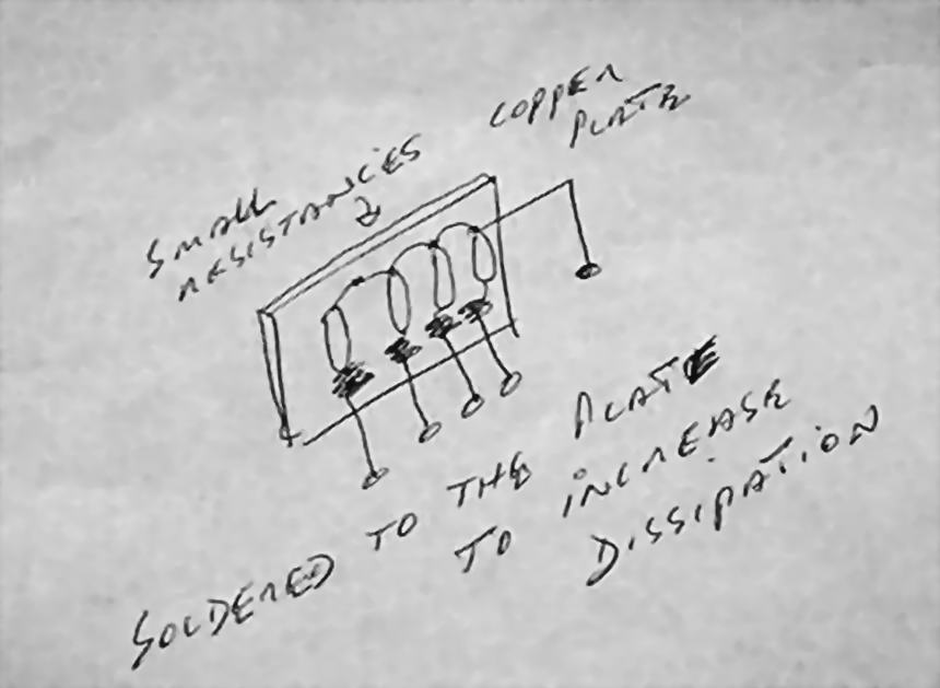

Maybe to increase power dissipation soldering small resistances into
a small copper plate.
alike this way.
But will see the schematic...can be something different too.
Or one resistance to each emitter...well....we gonna see observing the schematics.

Exactly....Bora is great!...one of the 10 best designers we have in whole world!
The guy is great....you see how he was carefull.
Avoiding inductances and allowing the use of smaller resistances..increasing a lot the dissipation and can made very pretty soldering into a beautifull golden colour copper bar.
Details.... i found sound better without emitter resistances...he found better without inductances.... very good.

Carlos: "Exactly....Bora is great!...one of the 10 best designers we have in whole world! "
Such a praise from you Carlos, is already a remarkable reward for any designer! Putting me amongst 10 best designers is likely to be seen as gross exaggeration by many, but I will strive to keep that position at least in your eyes.. and hopefully few others...
This emitter resistors assembly is something I am using for many many years to replace expensive brand name components without compromising ANY of relevant characteristics. Only real "minus" is additional labor for assembling those small boards. In any other relevant aspect famous brand name resistors have no advantages at all... proven in practice!
