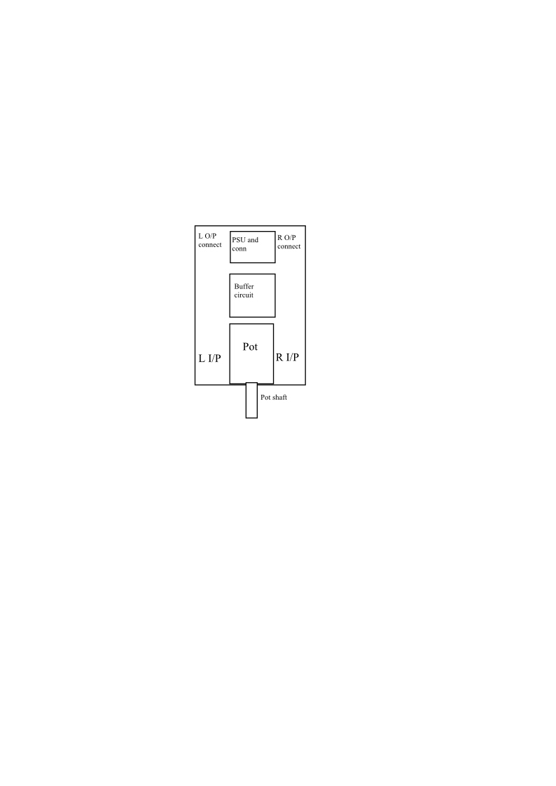

If I have only one precious pcb, I dislike the idea to experiment with it by first time SMD soldering. I could try with something that I won't regret if I ruin, may be some cheap SMD kit. Of course that I fear to ruin very good pcb by soldering SMD components. Also, I am 50, my sight is not as it used to be and sometimes soldering TH parts could be drag if the pads are too close, let alone SMD.
If the name of the site is diy(something) it means that it is (mostly) for amateurs, not for pros. Sometimes I visit EETimes and other pro sites, but 99% of us here are amateurs.
This is what I had in mind. Pcb can have additional holes for chassis mounting, and two sets of holes for both RK27 and RK16 (=standard) pots. If pcb pot is not desired one can solder pcb pins instead and connect pot with pcb using shielded or unshielded cables. Maximum flexibility!

It's very easy to transform this simple project into diyer's nightmare by two simple steps:
1. use hard to obtain expensive parts from many different sources
2. use miniature SMD parts that many diyers find difficult to solder
We do not want to compete with Nagra Kudelski in miniaturization game, don't we?
No we don't. I am looking forward to getting my "Subbu V3 DAC", and I would be surprised to find any TO-92's in the BOM there. I also do not plan on experimenting with it, it is pretty much a complete product.
Hiding one's head in the sand (or silicon) has nothing to do with it.
I do not think that potential users should have to jump through any hoops for a manual volume control with a unity buffer, whose main purpose is to attenuate a line level signal, so it can be amplified again in another circuit six inches away.
Small size is not a factor, because it will be installed inside a chassis which is a minimum 4 inches (10 cm) deep, and probably close to 6 inches (15 cm). It's closest neighbor will probably be a transformer which weighs in at 5-7 lbs. It simply has to fit behind the front panel, that is the only constraint.
The challenge is not designing the most technically elegant circuit with exotic components. I can already buy or build one of those, for less than what I have spent on Starbucks while reading some of those threads... 😉 Tying the design to surface mount components, or to unique components makes it attractive to fewer people.

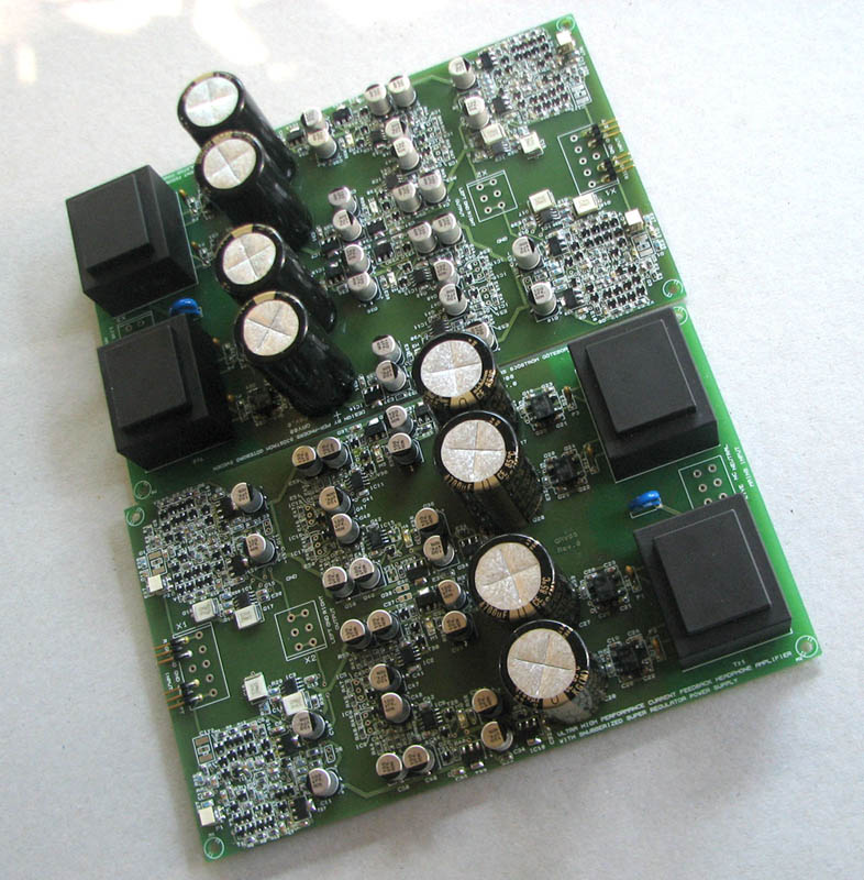

seriously,its pretty clear you are now just talking about stuff youve never even attempted. time to solder sot23 jfet : 1 second, looking at one side of the board. pick it up with tweezers, place it on the board, solder it, done. time to solder to92 jfet, probably around 5-10 seconds, since you need to insert, then flip the board over, maybe youve even had had to prep the leads, then you need to trim the leads.
but its so much easier… not.
its the same for resistors, or caps, no need to prep/bend the leads, no need to trim the leads, things get in your way less often too.
the parts we are talking about here are dead easy to work with, no need for a machine, I am not a robot, I use it out of preference, not just for performance. then of course if you need to do oarts that dont have any leads, or more than a few boards, build a reflow oven for less than $120 and solder the whole thing at once; several boards at once.
but I repeat, this board and these parts, far quicker to build SMD, by hand, as a non cyborg human.
youve got all these reasons youve been collecting, sorry but nothing so far holds water.

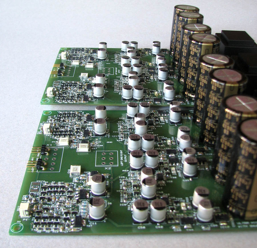

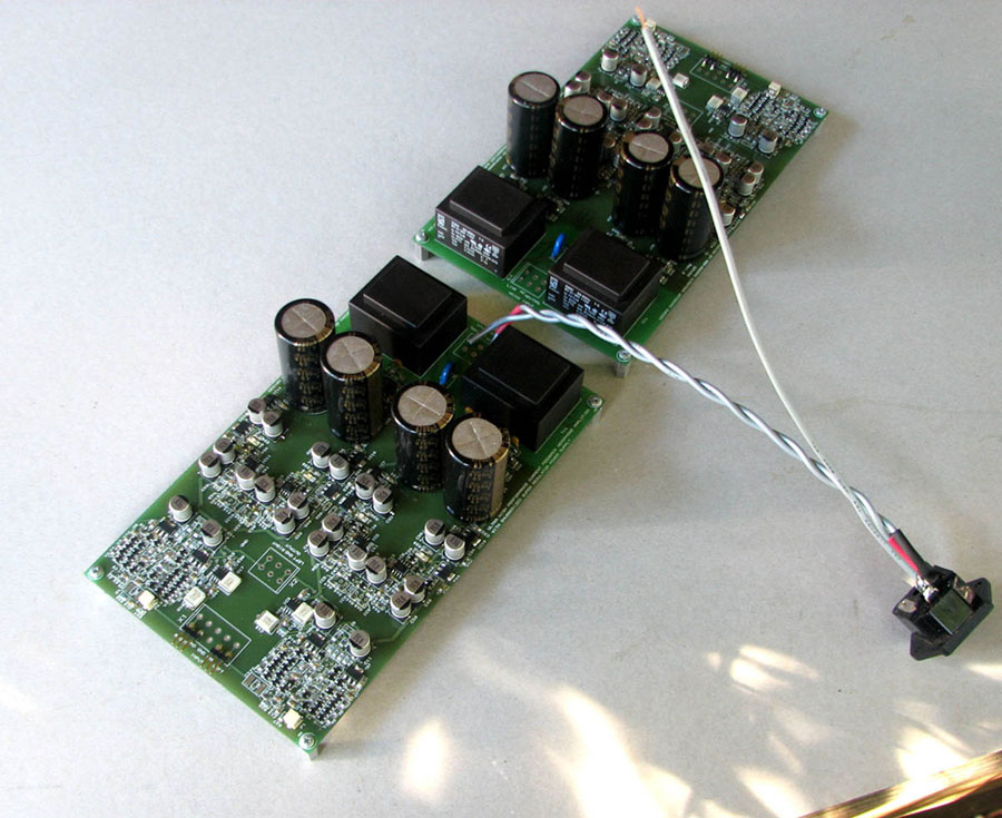

this was one of the first SMD builds I ever did, about 5 years ago (one of the first more involved diy audio builds I did fullstop). its a little bit messy, but once I got into the swing of it, no problem. I did this with an el-cheapo hakko clone and the stock tip
its a Sjorstrom Audio headphone amp, yes I bridged 2 of them for even more overkill. each amp has 4 discrete diamond buffers and 4 Jung type super regulators
you just need to practice and get yourself an illuminated magnifier

I didnt say what I said about speed as a point of pride, just that it was presented as something more difficult somehow, when with practice, the will and/or the right tools, its the opposite. pin spacing of sot23 vs to92 really isnt even very different.
we all have our humanity that catches up with us, I wouldnt attempt to do the boards above without magnification these days I dont think. hot air and sot232/323 might be a bit of an issue, depends how adjustable the flow is, but indeed very handy things; you can pick up a cheap one on ebay for ~$50 these days
I wish you all luck regardless. I just see a lot of people on this forum resisting this so very strongly and I dont really get it, the parts will continue to shrink, better get to terms with that.
I think that for the group buy we should use "big" pcbs with all TH parts so that "standard" diy-ers (old folks) can do it. We should provide another "ultra compact" all-SMD option with pcb files for "advanced" builders and let them organize their own production of pcbs because this version will be less attractive for the majority of builders.
