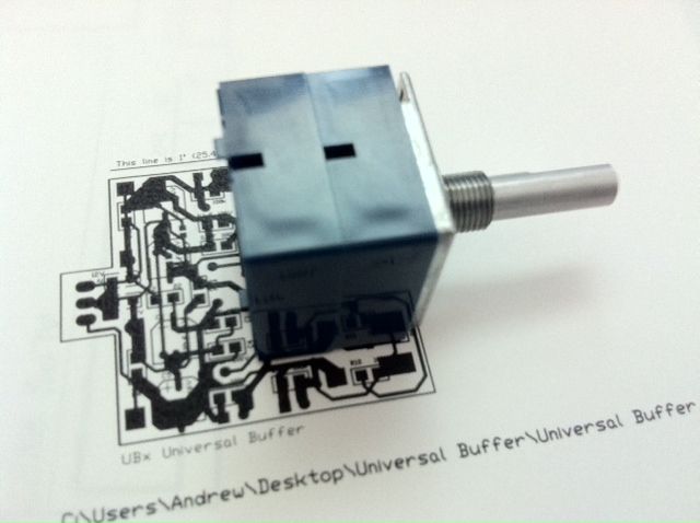

Guys, I already laid the board out. I will order this week 2 for testing.
I've written up an article as well, but can only publish after I test the board. ( gotta get it 100% right ya know!)
I will post up the layout and schema later tonight.
I designed it for an Alps RK27. The board measures 25mm x 48mm and sits on the Alps pot directly.

Yes you are right Calvin, it is quite possible to get the offset very low. But the FETs need to be well matched - I think dual LSK489 would be good here but they are hard to get and without the cascode, you need low input capacitance. Other option is a trim pot, but I tried to avoid that.
This design does not need matched FETs because the lower FET sets the source current and is sized to fall below the worst case Idss
No originality claimed for the circuit (originally published in 1960s I believe) and indeed Borbely and Pass (B1buffer) are very good designs. Hopefully though, this one is very compact and uses a high quality pot. Sims indicate very low distortion, as reported by NP and EB.

Here's the link Bonsai: RK09L12D0A1T ALPS | Mouser
But the way you have designed it for the RK27 is even better!
