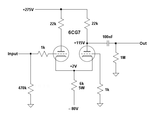

Well, there's one more trick left. If we use a resistor in the LTP tail instead of using the extra triode in the first tube as a CCS, we can use the first tube as a half an LTP, or a grounded-grid amplifier. Basically, you make an LTP, then you take only the non-inverting output and couple that to the following stage. As in the picture attached. That gives you half the gain (like an LTP) but a single-ended output. It is a waste of gain, but will certainly reduce distortion.

OK, here's the 6CG7 LTP with 1/2 6DJ8 CCS in the tail.
If you decide to change the first stage to a cathode follower, at least you'll have a good (high gm) tube in there for that use. And a negative supply for it too!
That cathode-biased CCS circuit came out of Bruce Rozenblit's "Beginner's Guide to Tube Audio Design" (page 39). I double-checked it by reading in Morgan Jones' "Valve Amplifiers" (page 105).
Incidentally, those 20k plate resistors for the 6CG7 should be rated 3W, minimum. You might want to get some good quality wirewounds. Not necessary to get non-inductive, but you probably should get something better than the cheap cement coffins.

Looking at the CCS supply:
Remember that there will be 14mA of current going through each 6DJ8 CCS, and that's a fair amount of current. You have 21,600 ohms worth of resistance in the negative supply to the CCS's. 21,600 x .028A = 610.4 volts dropped there! That won't work; needs to be re-thought.
If you have -300V available, and you want to get that down to -235V, you take that voltage (-65V to be dropped from the -300V supply) and divide it by the current that will be drawn (2 x 14mA in this case, so 28mA).
65V / .028A = 2,321 ohms
I think each channel should get its own negative supply. You could put a shared CRC first, maybe 100uF-1k-100uF, then each channel could get its own RC "leg" of 2k7-47uF. Each of those resistors should be rated 2W. the caps should be 400V.
1M grid leak resistor from the 6DJ8 grid may need to be reduced in value, but only if necessary.

That negative supply is correct? Are you sure?
That 15k resistor alone will drop 210V. That leaves only 38V for the 6DJ8 and its load resistor. That just can't be right. Please explain.
I used the values from the 6l6 schematic I found. This is more along the lines of something I would trial and error to get my voltages. I thought that 15K looked a bit high too, but he is using a resistor for cathode bias and not a tube, so pulling the 15K all together is the thing to do and just using a single stage CRC.
