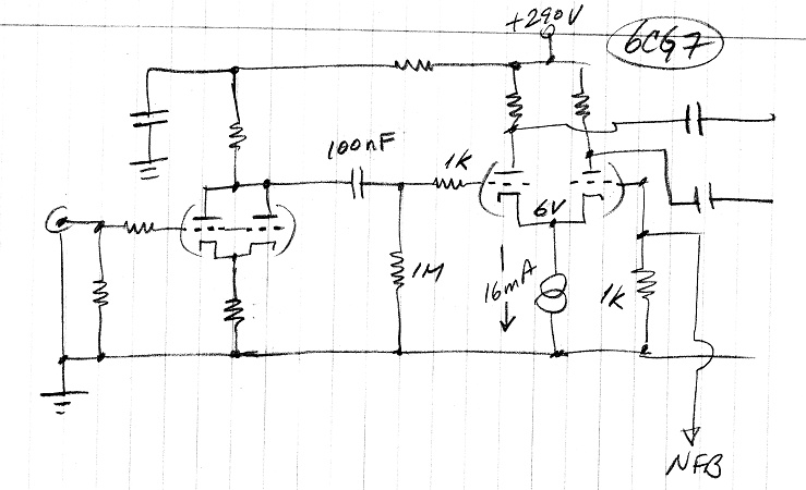

Now that I look at it some more...
Since the grids will be at ground in the LTP 2nd stage, you won't be able to get the cathodes more than a few volts above ground, which means the "tail" resistor will be of a small value. That means the balance of that phase splitter won't be very good at all.
One way to make it work would be to bring the common cathode "tail" resistor to a negative supply, so that the tail resistor can be made of as large a value as possible (the bigger the better).
Or you could put a constant-current source in the tail of the 2nd stage, from the joined cathodes to ground.
Then the grids of the LTP would be at ground potential, and you can easily put the NFB into the grounded grid side of the LTP. Like so...

Poinz' Music Machine and Eli's El Cheapo are actually similar. Both use a high-mu LTP-phase splitter-driver to (basically) triode-wired 6V6's. FWIW, I'm all in favor of adapting either one to 6L6 pentodes run at a lower voltage (to suit Blair's 3k6 OPT's). I think that would work really well.
Also, there's gingertube's Baby Huey, of which there is a version with 6SL7's driving 6V6's. That could be adapted to use 12AX7's in place of the 6SL7's and 6L6's in place of the 6V6's.
It's even possible to re-hash a classic Dyna A-410 schematic using a 12AX7 LTP-PS-DRVR, and switch the 6V6's to 6L6's.
There are lots of options. Ain't it fun?
