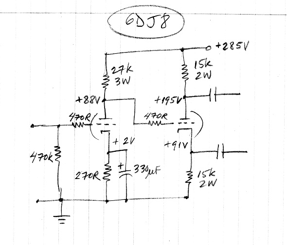

A cool circuit would be the dual-differential style, with two 12AU7's or 6CG7's, the first stage a LTP-phase splitter, the second stage a push-pull driver. But again, that would make a lot of gain, which you'd want to use for NFB.
The all-in-one 12AT7 LTP-phase splitter-driver with a pentode as current source would be trick. The problem is the low 300V B+ you have available. The 12AT7 would normally need a higher B+ to work with to get a decent amount of output swing (i.e. enough for 6dB of NFB).
You could use the voltage amplifier to concertina (split-load or cathodyne) phase splitter topology (as in the Dyna ST35 amp). Because of the really low B+, I'd try to use 6DJ8 or 5687, because they have high transconductance (good for the concertina part) and operate well with low plate voltage. I'm pretty sure either one would have enough gain (6DJ8 has mu = 30, 5687 mu = 16)... But either one would only require one 9-pin socket per channel. How would you feel about leaving an empty socket per side?

Aw, and I just whipped this up too...
