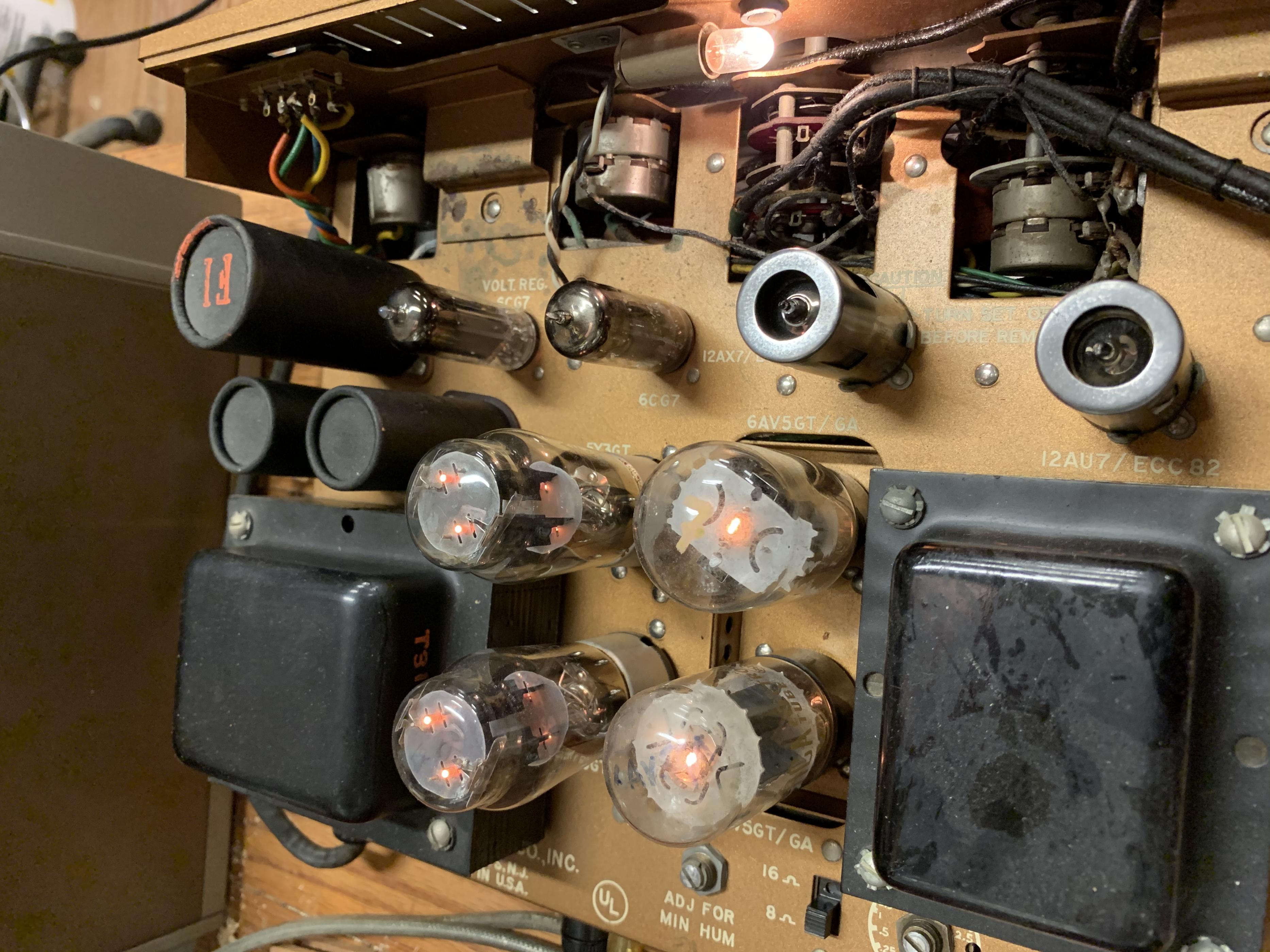

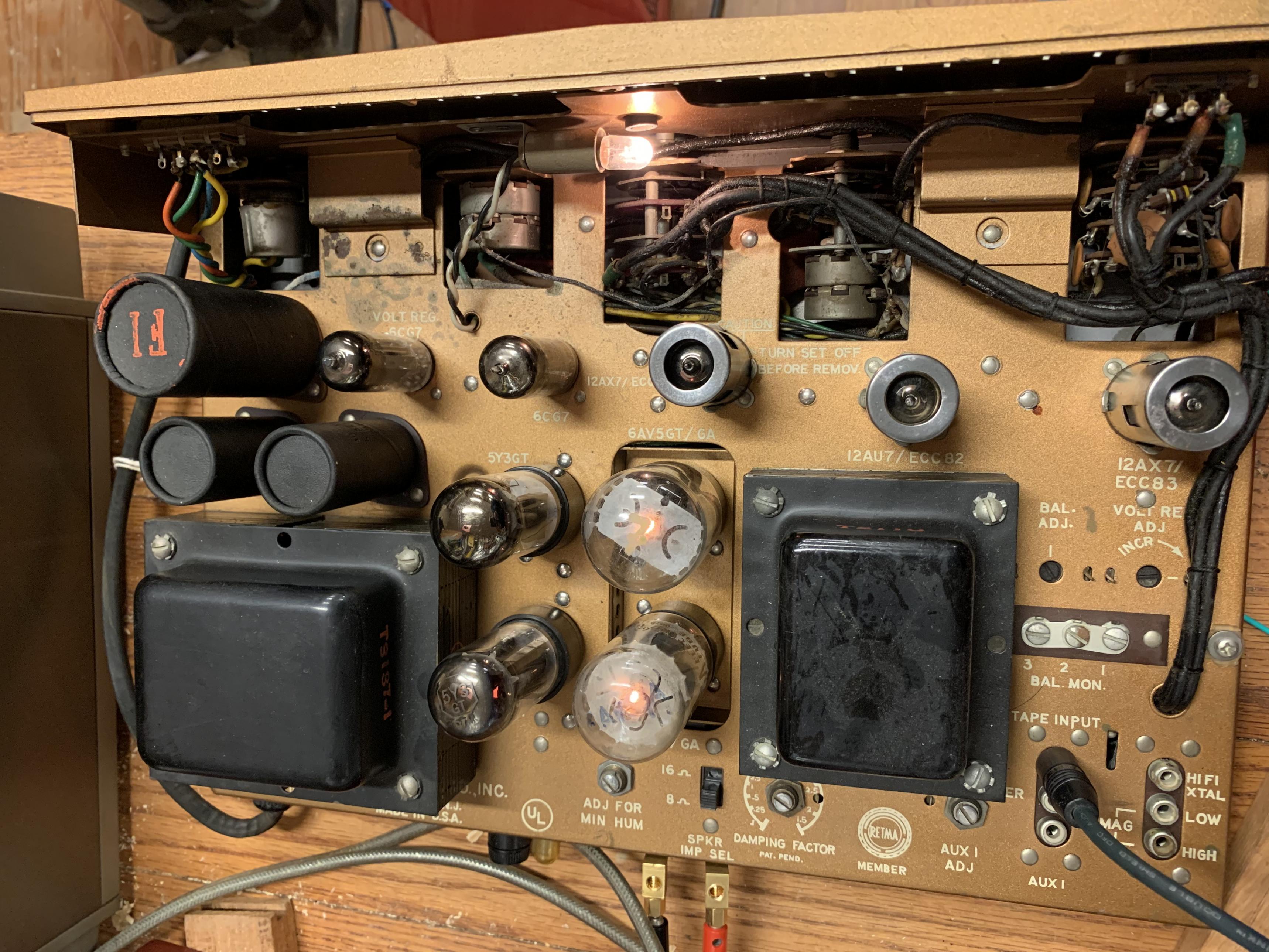

Fired-Up(!)
The cheap 6CG7s arrived from FleaBay.
I scrounged up the rest of the tubes and warmed it up gradually on the VARIAC.
Used a Y adapter from the Spotify DAC.
Figured “Songs for Swingin’ Lovers” would be period-correct, so as to not shock the components.
First, one of the rectifiers (one of only two 5Y3s I have; must have come out of this amp) started a fireworks display. SHUT-DOWN! Crash the Control Rods!
Turns out the box had “one bad diode” written on it. You know you’re a scrounge when you keep a bad 5Y3.
Back to the rectifier box: AHA, Chinese 5Z4P with their pert little bottles. Close enuf. See photos below.
Took a minute to find a good input (tape monitor, it so happens) but then BOOM, there’s Frank crooning at his peak.
Wow. Volume & tone work good, but most of the inputs are dead or near-dead.
So the power end is near-perfect (BEFORE bias check or adjustment) but the front-end needs some tracing work...
Bogen’s component quality must have been pretty good, if those power supply caps reformed (at least partially) after all these years. The caps on my Quad 303 were in the picofarad region; completely SHOT.
Also, the Bogen is super quiet between tracks, which is amazing, as I have Frank cranked up pretty good. The shop is 750 ft2 with a cathedral ceiling covered in Homosote board, and the Bogen fills all of it....
More later. Looks like I’ll be putting on the Fleabay at “Asian Audiophile” price. If it sells, fine. Otherwise this thing deserves a little work under the chassis.
