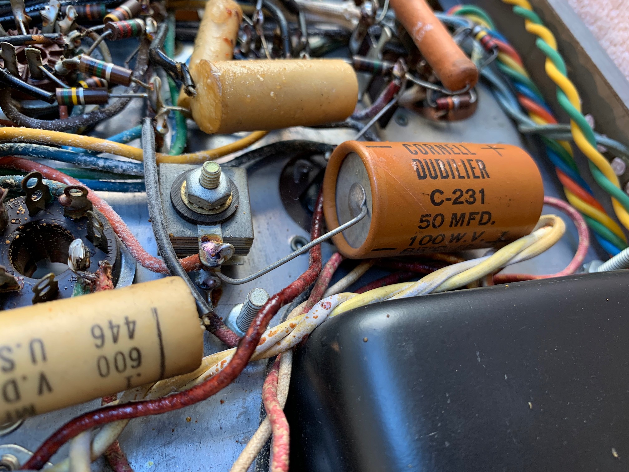

Thar she blows...
You can't quite see it in the photo, but the "hot" lead from the PST is bare for about 1/2" where it's soldered to the rectifier.
The more I study this thing below-decks, the less inclined I am to power it up on the VARIAC. Looks like the bilge of a typical DYNACO kit, minus the ultralinear Iron.

Your wife's nail polish "rides" to the rescue. 2 layers of that stuff on the uninsulated section of wire should restore a margin of safety. Thankfully, this is a comparatively low voltage situation.
You may be dealing with deteriorating cloth wire insulation. Nail polish, followed by polyolefin heatshrink tubing, can resolve the matter.

In the normal scheme of things, The Chief Cook & Bottle Washer (aka "Oma") does not wear nail polish.
Fortunately, I gave her a bottle of Jet Black (goth) nail polish in her stocking for Xmas as a bit of a joke; the CC&BW is pretty much the OPPOSITE of "goth".
And, of course, I have meters & meters of polyolefin shrink wrap.
The issue is what happens at VARIAC power-up, since I want not to touch the thing until I see what I got. Guess I'll just browse through the circuit looking for suspect areas...
