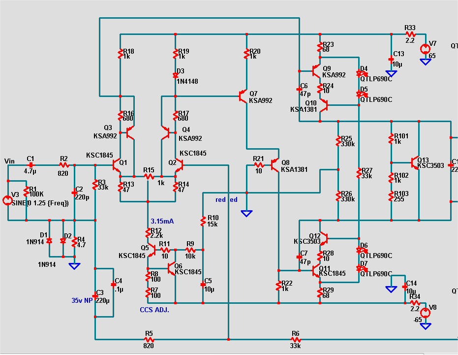

I'm now back to my Hawksford cascode binge. I could not find much reference to it in Bob's book. Combining chapters 3.6 (cascoded Vas) ,7.4 (unipolar IPS/push-pull VAS) , and 10.4 (OP stages - DBT) I've come up with a real good DIY amp.
In the book , I also could not find much on CFP input stages besides the cascomp in ch 25.2. I've noticed superior THD and linearity in simulation and it actually works in real life. Combining this with the cascoded push-pull VAS (luxman like) and the DBT , I've achieved 3-10ppm 40v p-p 1k-20k without TMC "tricks". I actually built this before but with a EF2 - not too bad at low levels but "non-engaging" at high levels. The triple makes all the difference.
The IPS/voltage stage is (below 1) , and book's "DBT" is (below 2).

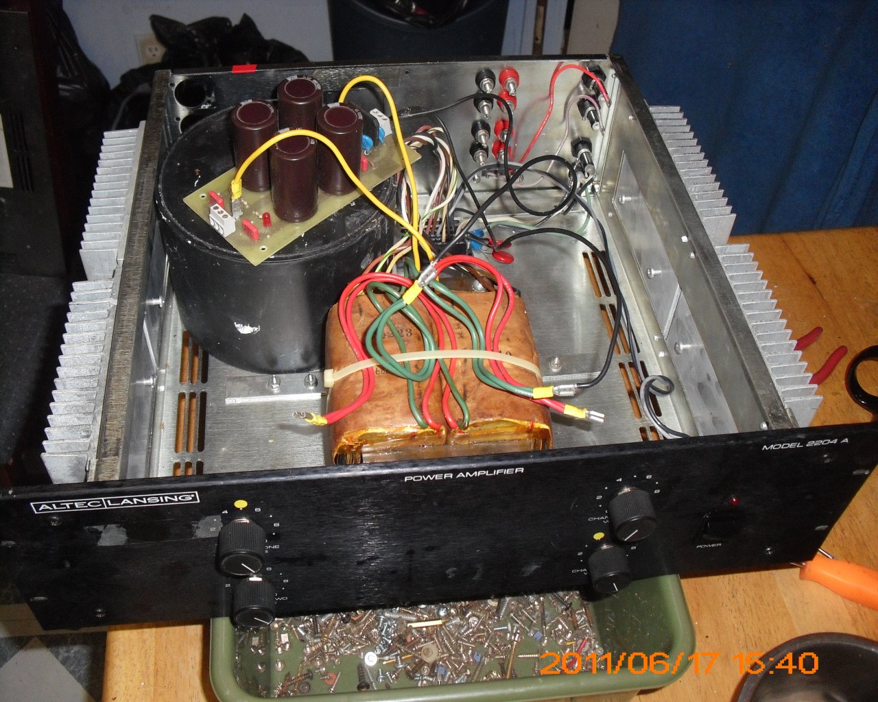

This is the my first amp that will use this book as a "filter" , the reference to the Holman amp (7.4) was a unexpected bonus, (ps-the holman does not have the cascode as level shifter and uses a standard fixed bias-zener VAS cascode). (below 3) is the testbed for the new contraption.
The trafo is a R-core ... a ?? It is said both windings of a R-core cancel each others field out. If both windings have primary and secondary and one uses them individually for each channel and loads one amp down (loading the secondary of one winding down as well) will this "unbalance" the trafo (the R-core) ?

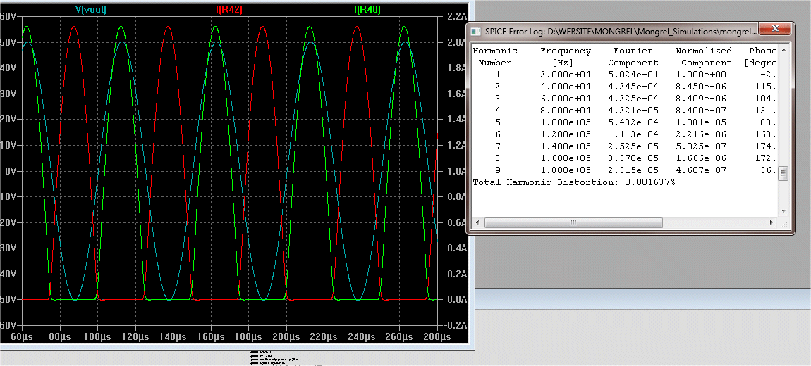

16 ppm @ 102v p-p thd20

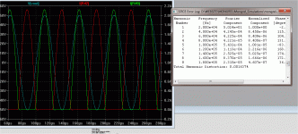

(below) is "ultra nice" (simulation only) at mega voltage swings. For this level of simplicity ... quite the deal. 🙂 Sound wise , the real thing reflects this performance (spine chillin'). Eliminating (or greatly reducing) early effect/memory distortion makes this amp " lock on " to ultra low THD regardless of frequency / amplitude or even load (2R is the load at 100v p-p). Thd is mostly H2 and 3 (-115db). PPM will go only to 20 ... right at clipping (107 Vp-p).
I KNOW the real thing most likely will not do quite as well, but it sounds "golden" (better than my previous creations). I'm only running this amp off of my B._S (40-0-40vdc OEM) power supply now .. can't wait to hook it to the ALTEC PS. 😎

I would never tell someone how to write a book 😀 , but look to the Japanese OEM's for some of the best topologies. The OEM's are not dumb (economically driven sometimes) in their design choices. For high MTBF and cheap STK module offerings they use the standard 3-stage LIN topology with varying degrees of refinement. For a real "listening amp" (mid to audiophile) Push -pull VAS's and triple OP's are the rule. The pioneer amps are quite revered in their MTBF and sound.
Thank you , padamiecki .. for the M7 schema. It looks different than the "DBT", more like the voltage follower DB current amp (my nakamitchi 620 example). This means that Bob's "DBT" is unique to the book , no exact commercial equivalent. More "DIY" friendly as well , it can be used with any popular IPS/VAS combo plus is quite easy to thermally stabilize. I would say it's ultimate form would be with the Thermaltrack's , 2 of the internal diodes controlling the Vbe (like the leach). Njl3281/1302 is out of the reach of some hobbyist's ... 5.41 X 12 = $65usd for a 2 X 150W amps. Same power with the NJW's is only 1.80 X 12 = $21usd for the same 150W !
