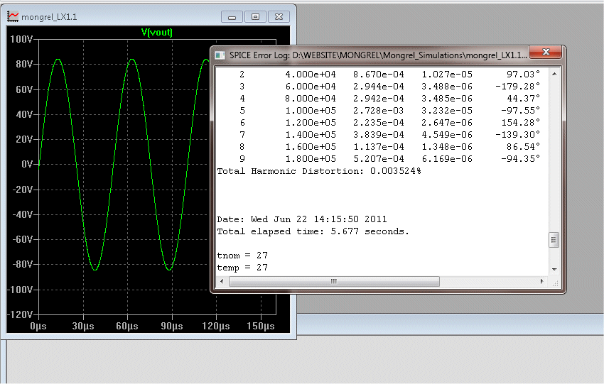

I could imagine a fet-based "my-dream-amp", with a "single current stage", consisting of one "input+VAS" stage with 150V shunt PS rail (2N5278 j-FET), which drives the follower-like output stage based on radar-LDMOSfet, with 600W dissipation, Ciss near 100pF and near 10S transconductance at 5A idle current (can be chosen among NXP products).
Although not realistic for DIYers, but quite real and unbeatable sound-wise.

Thanks for clarifying that. I think that keeping the number of stages to a minimum is a central MISGUIDED issue.
I'm not saying that we just throw transistors at a problem, but there is an optimum approach that should not be constrained by some one-size-fits-all philosophy.
Have you simulated the kind of design that you are talking about? Have you built and measured the kind of design you are talking about? When you express concern about nonlinearities of multiple stages adding up, you are talking about something that is readily simulatable or measurable.
Bob

Do you have any evidence that would help such an opinion? How can we speak about electromagnetic or interaction if nobody makes measurement (correct or not) to support this? If measurements or simulation can't bring any evidence, how can a listening test point out the precise point of dissatisfaction?
That would help me to clarify what to correct if I hear something strange I can't imagine how to correct on the basis of measurement and that appears only by listenig. Well I know my ears are not perfect either.
To add some points, EMC simulation softwares exists (we use them in my company), it is today possible to extract all parasitics and coupling from any pcb (or integrated circuit!), and any component can be measured to define its parameters up to a few GHz. I guess it would not be usefull to correct a subjective listening feeling.
