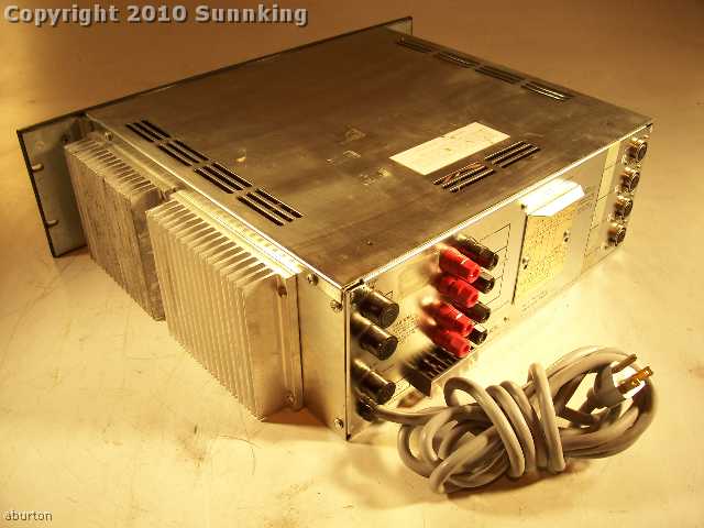

Just bought a vintage altec lansing 2204 for US$20 (rare-below) to put my "bobamp" in , huge 800VA trafo and large heatsinks ... just have to choose my outputs and final layout
