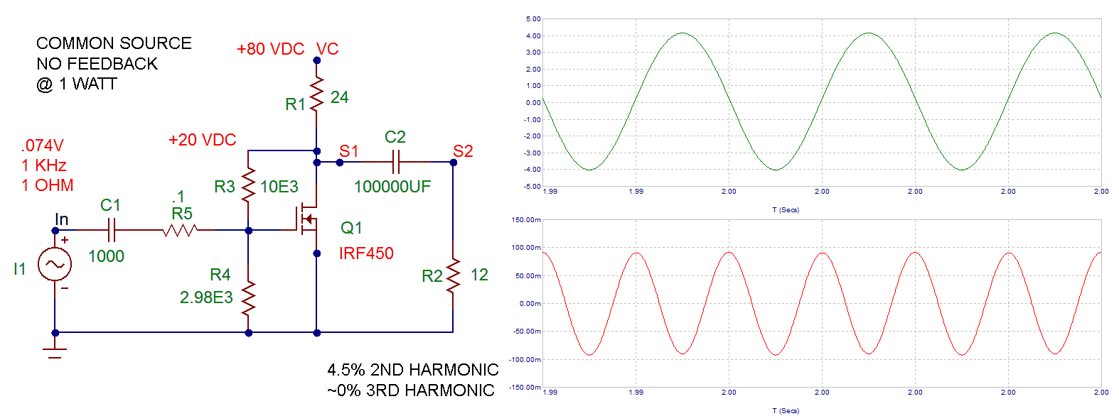

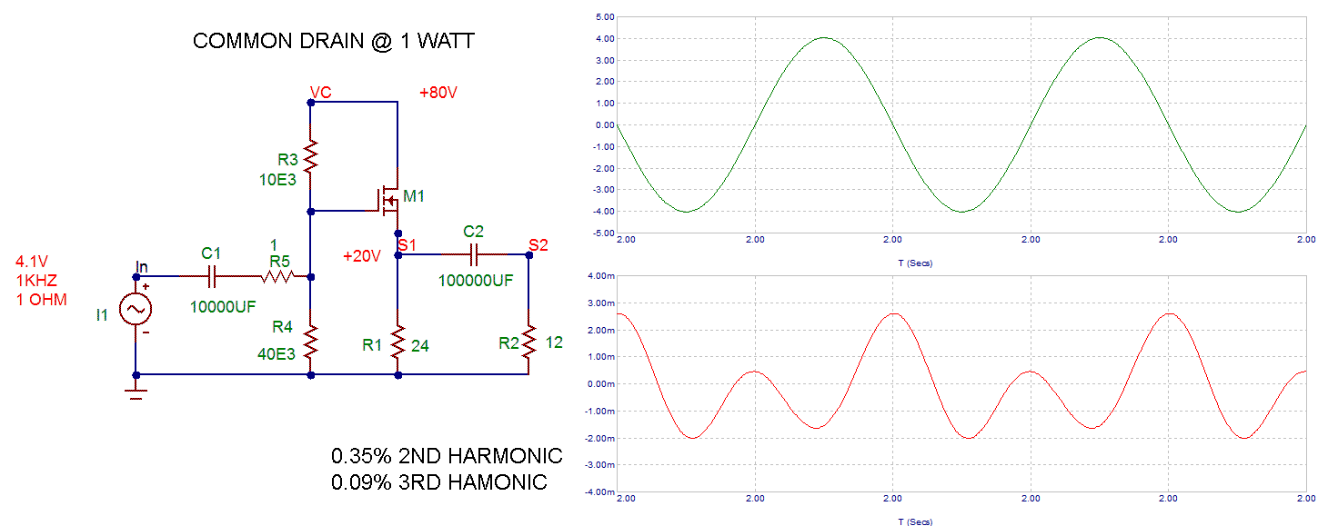

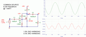

OK, here's some entertainment:
Three circuits using the same gain device and running the same load
line, which is 1 watt into 8 ohms single-ended Class A.
The 1st is Common Source with no feedback
The 2nd is the same with 6db of feedback
The 3rd is Common Drain (follower)
The lower curve on each shows the distortion waveform.

Nelson, yes, not only entertaining but also very expressive (sp?).
It illustrates several issues, for instance that the effect of an EF (SF) looks a lot like 100% feedback.
It also illustrates the so called 'Baxandall curves'; showing that increasing the feedback around a single non-linear device may lower the total THD but may increase the higher harmonics, until you get to high enough feedback that the higher ones start to decrease as well. Very nice illustrations!
I like to approach this more from a conceptual view. If you look at the attached figure, the topological similarities are quite clear. The EF has the drawback that one of the input- and the output terminal are intrinsically connected and cannot easily be separated so it's difficult to determine an EF 'with and without fb' situation.
In my opinion, showing the conceptual similarities help you to clarify both circuits with the same explanation. Considering them as conceptually different, despite the similarities, would require two different explanations and that doesn't seem like a good career move.
jan didden
jan didden
One of the things I find interesting is that the ratio of 2nd and 3rd harmonic
is about the same in the latter two cases, even though the distortion figure
is quite different.

From Nelson's third figure it appears that the load makes up part of the degeneration.
In a EF or SF push pull configuration any amount of applied bias loads the respective halves.
Is there ever an instance where some amount of feedback in not directly applied to the output of an EF or SF?
David.
David.
