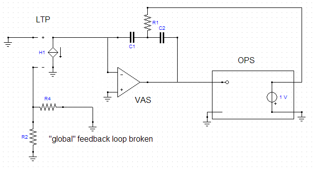

Are you talking of the main loop with beta attenuation to the input stage?
JPV
I don't understand what you are referring to here.
It is, in a multiloop description, the minor loop enclosing both the VAS and output stage back into the VAS through R1. I approximated the VAS by an ideal opamp which is a good approximation at the frequency this loop crosses over.

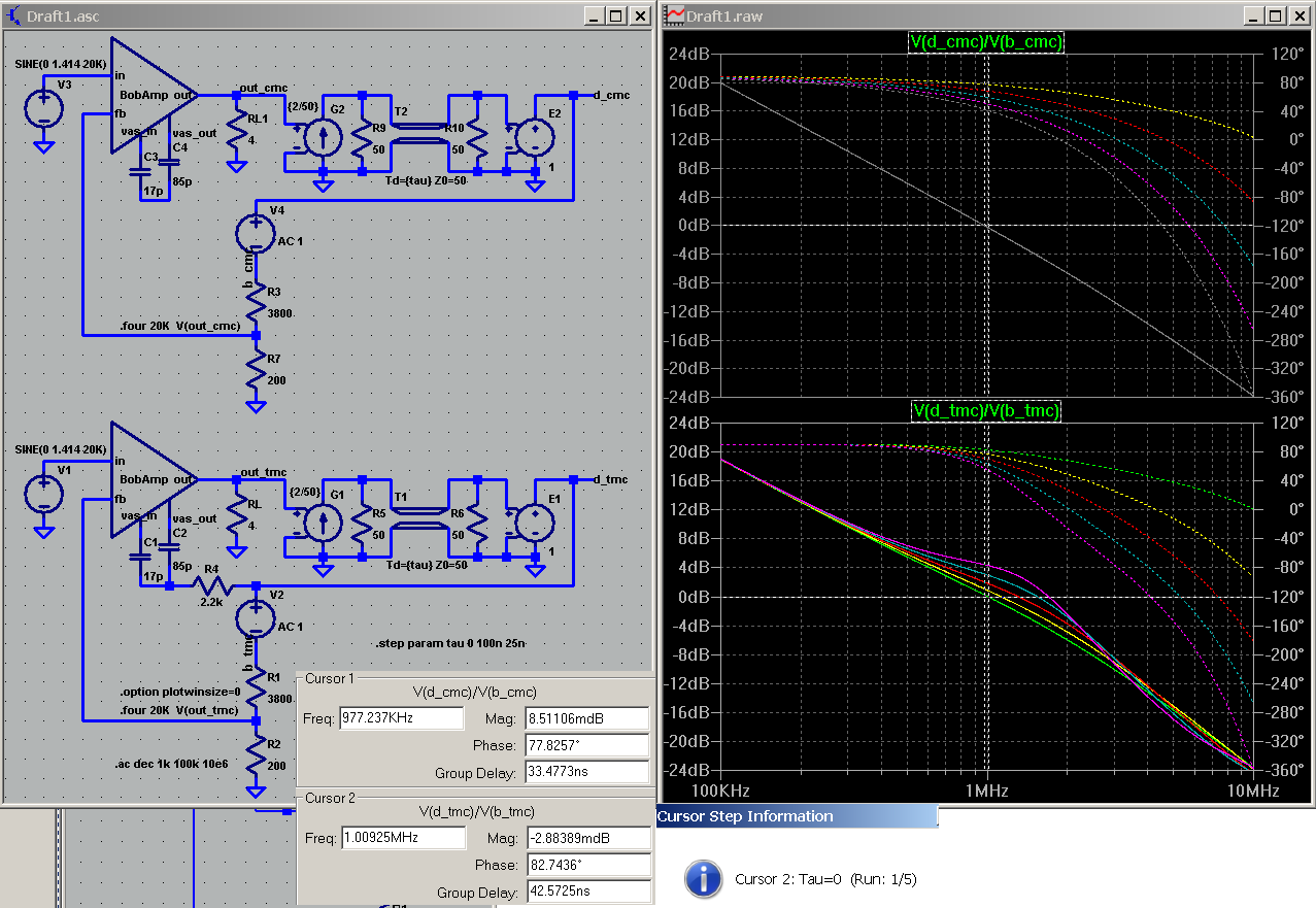

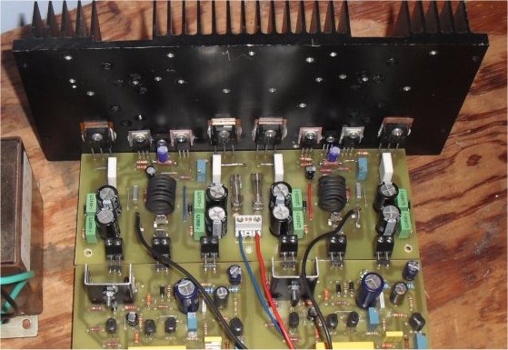

In an "unscientific way" , I put a traditional miller comp. amp up against the TMC one at the new years party. Since I am a prolific builder , I could care less about blown OP devices. We , at the party .. clipped , overloaded , actually tried to blow out 2 pairs of amplifiers. The traditional one sounded terrible well into clipping as it should .. we blew a fuse on them but everthing survived with a new fuse. The TMC enhanced blameless actually had a less fatiguing sound as it clipped. Neither amp had ANY hot devices in the IPS/VAS (the OPS was a nice hand warmer) no tweeters blew , no warm zobles. We tried to FRY these amps for the "hell of it". This is a good testament that Bob's amplifier examples are robust and reliable and that TMC does not detract from those strengths AT ALL. One amp we even shorted out at full power ... it actually survived with a blown fuse. 😱
Below- the "sacrificial amp" , 80W...
OS
the "spice tricks" are meant to illuminate not confound
I don't suppose a direct sim of robustness to added output delay will cause anyone to rethink?
As I stated earlier in this thread a sticking point seems to be people wanting to believe that the outer loop gain/phase margin Bode plot of TMC looking like CMC means you managed greater loop gain/distortion reduction - "for free"
I find it hard to believe the resistance to the TANSTAAFL principle among a engineering oriented community
Specifically I have pointed to Bode's Integral relations and BJ Lurie's work that shows how this "conservation law" for feedback is applied
My earlier output conductance sim clearly established that the added feedback is externally visible - simply by "tugging" on the output node you can tell TMC from CMC
the Bode Integral relations lead me to expect more feedback has a cost in loop gain slope and phase margin - the extra distortion reduction performance of TMC - is not "free"

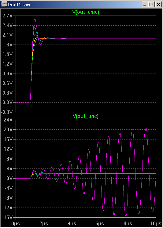

Now I have another sim - this time I packaged up Bob's amp, bringing out the VAS connections so compensation can be seen as external components
I've added a pure delay to the output of the amp - between the loaded output and the normally output connected feedback components to sim variable "excess poles" - which Bob mentions in his book can be approximated as delay
To give a baseline I have a "CMC" amp on top and the TMC compensated amp on the bottom
I step the delay from 0 to 100 ns in 25 ns steps
You should see that the "simple Middlebrook" gain probe is in the "outer loop" in both sims - and "step 1: tau = 0" does make TMC look very similar to CMC as can be read from the cursors
however as output stage delay is added the crossover frequency jumps upward in the TMC sim and gain margin collaspes - not like your 1st order loop
other things you can do with the sim - plot V(out_Xmc) in .AC to see the TMC peaking with added delay
replace the sine source with a small amplitude step (with ~ 1 us delay) and run a .tran (very high resolution 10 us, 1 ns t_step_max) - and see the TMC sim break into oscillation at higher delays
In sum: You Have been bitten by those inner loops - TMC is not as stable as CMC, the gain/phase measured in the outer loop is not informative in the TMC case
  • BobAmp.zip
    BobAmp.zip

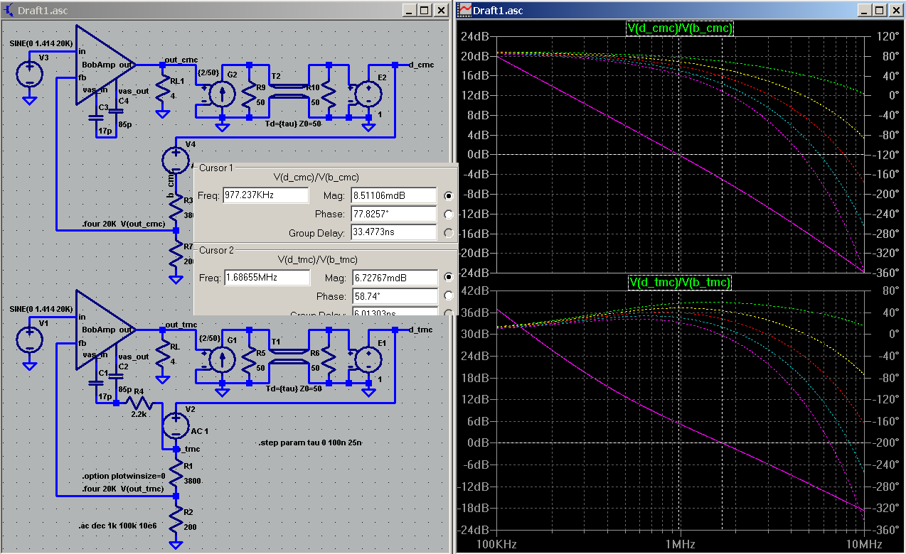

This sim moves the simple Middlebrook gain probe to the “inner” feedback loop, measuring all of the gain around the output stage
I think you can see it is a much more useful way to view the stability margin of TMC
To look at the phase margin numbers with the added delay we have to convert the delay time into phase – since delay has linear phase with frequency the phase depends on the frequency
For the CMC loop 100 nS delay at the 977KHz gain intercept is:
100ns * 977kHz * 360 degrees = 35 degrees added phase shift
the cursor reading gives 77.8 degrees phase margin for the CMC at 0 delay,
42.6 degrees at 100 ns (append @5 to both V in the waveform formula, ie V(d_cmc)@5/V(b_cmc)@5)
77.8 - 35.2 = 42.6 which agrees with the idea that the added delay is a fair measure of phase margin
the numbers clearly don’t work so neatly in the outer loop gain/phase plot of TMC because the gain intercept is a moving target
the Inner loop Bode gain/phase measurement of TMC below Is well behaved and we can do the same calculation:
100ns * 1.69MHz * 360 = 60.8 degrees added phase shift
the cursor reading gives 58.7 degrees phase margin for the CMC at 0 delay,
-2 degrees at tau = 100 ns, step 5
58.7 – 60.8 = -2.1 which again agrees and predicts that the TMC loop will be unstable with 100 ns added delay – as the tran sim pic above shows
as a further check note that 100nS is just over the 0 degree line and the previous step at 75ns delay has poor but positive phase margin – and the tran sim shows it does settle out instead of oscillate
(Thanks to Mike Engelhardt of Linear Technology – you may have noticed the stepped waveform colors didn’t agree in the previous post Bode plot but they do match in this sims pic – the 1st time I’ve had a bug fixed over lunch! )
I assume anyone wanting to verify can mod the .asc in my previous post
OS
Hi OS,
Nice report! Sounds like you had fun! That's encouraging to hear that the TMC design sounded less fatiguing in clipping.
Can we deem these results credible in spite of the amount of liquor that was probably flowing?
Bob
