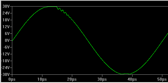

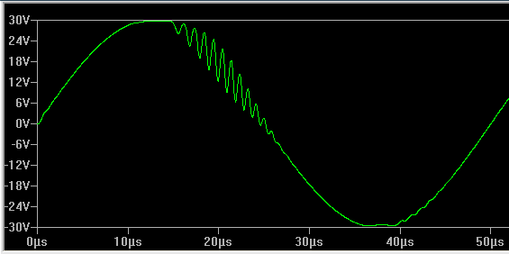

I've done some more simulations on CMC, TPC and TMC and have attached a zipped folder of three simulations (ready-to-run) of the three techniques showing how they behave when in modest clipping of a 20 kHz sinewave. All of these simulations are of the example amplifier I have used earlier, except that I lightened the HF load to 0.05uF and 2 ohms, doubled all of the base stopper resistors to 50 ohms and 5 ohms for the drivers and output transistors, respectively, and loaded the driver base stoppers with 100 pF to detract somewhat from the phase margin. Once again, the TPC and TMC designs were adjusted to give the same amount of THD-20 reduction as compared to CMC. THD-20 was on the order of 0.002%.
It is easy to see that both TPC and TMC do not recover from clipping as well as CMC. However, TPC is much worse than TMC, getting into an oscillation that does not cease until the polarity of the signal changes (interestingly, the negative polarity is more stable, probably due to differences in the output transistors.
BTW, the TPC and TMC versions have about the same amount of distortion reduction, and the total feedback around the output stage in each has about the same phase and gain margins. Also, small-signal squarewave response shows about the same amount of ringing.
Overall, TMC and TPC give up some stability in reducing distortion as compared to CMC, so they have to be evaluated carefully both in small signal and large signal. They are both very worthwhile techniques, but like any tool, must be properly applied. It appears that large-signal behavior of TPC is significantly worse than that of TMC when margins are close. Overall, I still am inclined to prefer TMC over TPC.

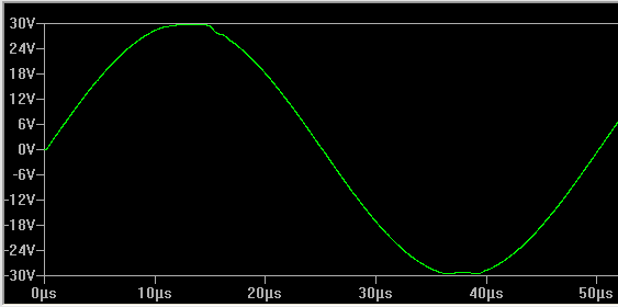

I stuck in 2 uH series output load isolation inductor and the clipping recovery ringing is pretty much gone with both TPC (well just 1 cycle), TMC (measured at the amp output)
I suppose Mr Curl will object that the 320 KHz low pass is "clearly audible", that would be -0.017 dB, 2nS group delay delta at 20 KHz re 1 KHz - them Golden Ears are pretty good!
it also hides the TPC "bump"
Hi jcx,
It makes sense that putting in the 2uH inductor improves dynamic performance of these compensation schemes. How much resistance did you have in parallel with the inductor?
Even John Curl agrees that 1 uH or less is OK. It would be interesting to see how well 1 uH and 2.2 ohms would do in this regard.
Bob
