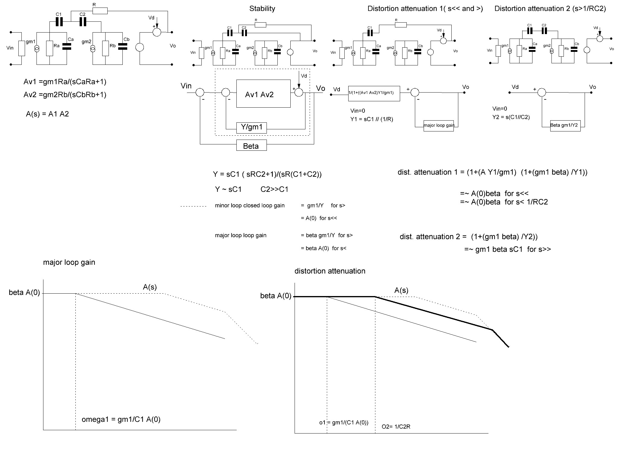

TMC vs TPC
I tried a simple analysis using the method developed by Roberge ( minor loop) and very well explained in Lundberg's tutorial.
In the TMC page annexed you will see that the loop gain is very well approximated by a firs order system as explained many times by E Stuart and B Cordell.
To analyse the distortion aspect I concentrated on the distortion generated at the output that can be modeled by a perturabation source added ( Vd).
We can analyze this in two steps: first when C2 impedance is large with respect to R and then when R is short circuited by C2.
An easy approach is to put Vin =0 and analyze the input output circuit where Vd is the input, the closed loop gain is then attenuation of the distortion.
The voltage distortion Vd can be moved out of the minor loop by dividing it by the loop gain of this minor loop then we can again attenuate it by the major loop loop gain. But in this one we can introduce the approximation of the minor loop closed loop gain as explained by Lundberg.
When R is conducting we have two attenuation loops and when R is short circuited we have a normal Miller loop.
The same approach is applied at TPC.
What can we conclude?
Both methods have the same output distortion attenuation at low frequencies but TMC can go higher in frequency. The zero in TPC ( 2RC ) may not be put to much to the right in the Bode plot otherwise the poles from the main amplifier will influence the phase shift of the loop gain and then the stability is at risk.
On the contrary, with TMC we have one more degree of freedom. We can adjust R to move the pole to the right while keeping the stability unchanged. We could then in theory gain some attenuation of the distortion without risking stability.
I hope I didn't make any mistake and your comments are welcome.

JPV
enlightening?
Very enlightening! 🙄
Normally, we put a schematic (544) and the results (682) in one and the same post, instead of 138 posts behind it. 😛
Except that the FB around the OPS is the same in both cases, I do NOT agree with your assertions.
edit: Having a closer look at your schematics, WTF what is the lead compensation (R29=2k2 and C11=68p) doing there in the TMC version?
Also, the lead compensation for the TPC is wrong. What a mess! 😡

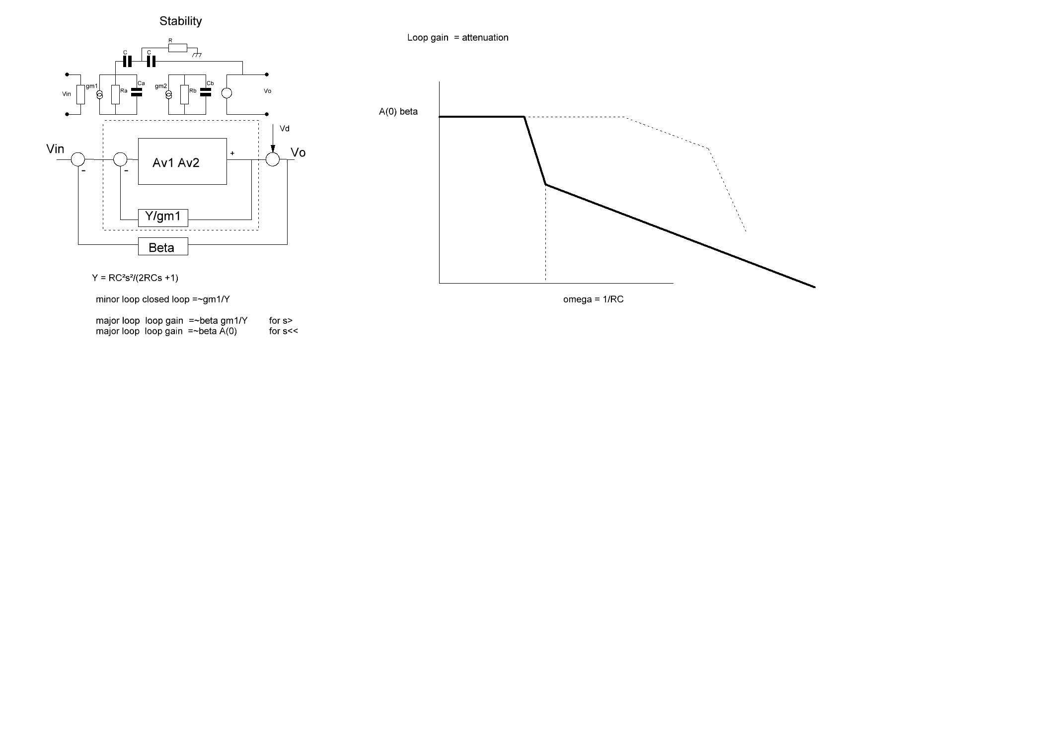

I do not understand your arguments.
TMC as TPC are minor loop compensation techniques
With respect to LTP they have both the same effect except for loading.
Circuits like these are very complex for analytical investigation and a mistake is quickly done.
In a two voltage gain stage, the forward path ( including LTP and output stage ) is modeled by its two main poles. This is done by all the main authors in the field when they analyze such a system ( Roberge, Sansen, Solomon, Lundberg, Gray). The key point for stability is to manage the dynamic below unity loop gain so that the influence of non dominant poles are not too detrimental at unity loop gain.
The analytical approach used and advocated by top players in the field has the beauty of keeping it simple and avoid the writing of node equations that makes it abstruse even in this simple case.
What this method shows is that the stability analysis must use a different loop transmission than the one attenuating the output stage distortion in case of TMC at low frequencies. In TPC the loop gain for stability is the same as the loop gain for attenuation.
Before arguing with different equations, I would appreciate to understand what is wrong with my method and derivation or which errors I have made in the derivation ( it is always possible).
To quote an author: "it greatly simplifies and generalize the analysis and design of opamp compensation networks. Intuition and insight into the solution are gained by using these feedback techniques".
Thanks for comments
JPV

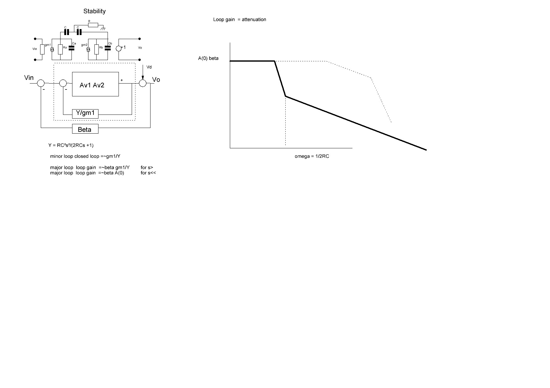

wrong TMC circuit
Results? The step response and distortion figures are missing.
Never mind, as the comparison is invalid anyhow.
Rather embarrassing, I would say!
