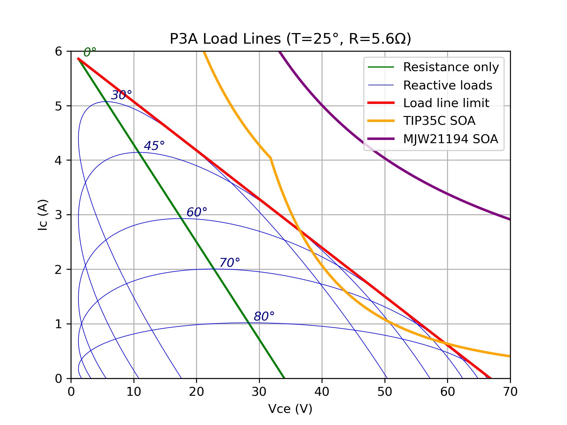

This may interest Mr Cordell and some others.
Recently I needed to calculate some load-lines for a bipolar transistor used in the output stage of a class AB amplifier. After some work with pencil and paper I managed to find a couple of simple formulas for plotting load lines. I have attached a pdf describing the formulas and a python script that calculates the load lines.
Very Nice! Would be very nice if you could add the transistor load line in as a set of points since you want to take account of device second breakdown. 🙂
And, a typical example of load lines and SOA. Will a TIP35C be sufficient for the amplifier? Maybe for domestic use, but forget it for industrial uses.
