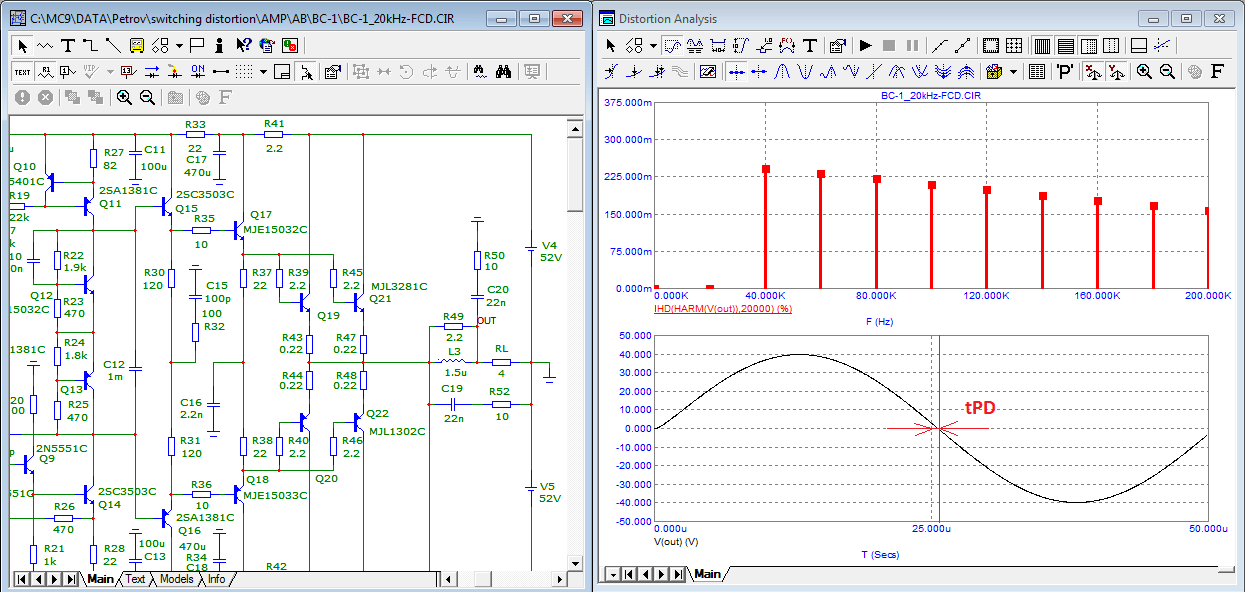

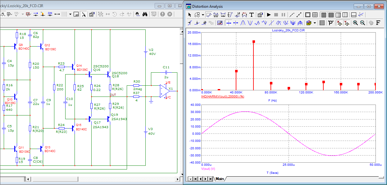

Markw4, you focus on FCD, although I mentioned it in passing as one of the methods for indirectly evaluating the performance of an amplifier and I don’t use it anywhere!
If I understand correctly, you completely negate the Hafler SWDT test for which the amplifier must have a signal propagation delay (tPD) of only 8 ns to pass.
I'm constantly told that I'm testing with unacceptable bursts of sinusoidal signals processed by 100 kHz low-pass filters. At the same time, square-wave testing for measuring SR without any filters is quite acceptable and does not cause any complaints.
I have shown real amplifiers with 3 times the delay time (tPD = 25nS) than required for SWDT, however, these amplifiers do not have information loss inherent in amplifiers with tPD = 0.2 ... .1.5 µs. I added a comparison of the two models in the introduction.

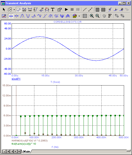

What petr_2009 has been doing is using the now freeware microcap simulator to simulate something that is impossible in nature, and treating as though it produces real effects in audio power amps. [...]
It's even more embarrassing: Mr P. doesn't even know how to use Microcap in a proper way. With correct settings of Microcap, I simmed Bod Cordell's EC amplifier and got a THD of 6ppm for the first cycle at 20kHz, (almost) exactly in accordance with real measurements on this amp.
Cheers, E.
Edmond, it confuses me personally how you managed to make an ideal amplifier out of an ordinary amplifier in which there is no signal delay.It's even more embarrassing: Mr P. doesn't even know how to use Microcap in a proper way. With correct settings of Microcap, I simmed Bod Cordell's EC amplifier and got a THD of 6ppm for the first cycle at 20kHz, (almost) exactly in accordance with real measurements on this amp.
p.s.
Edmond, you imposed this test yourself
