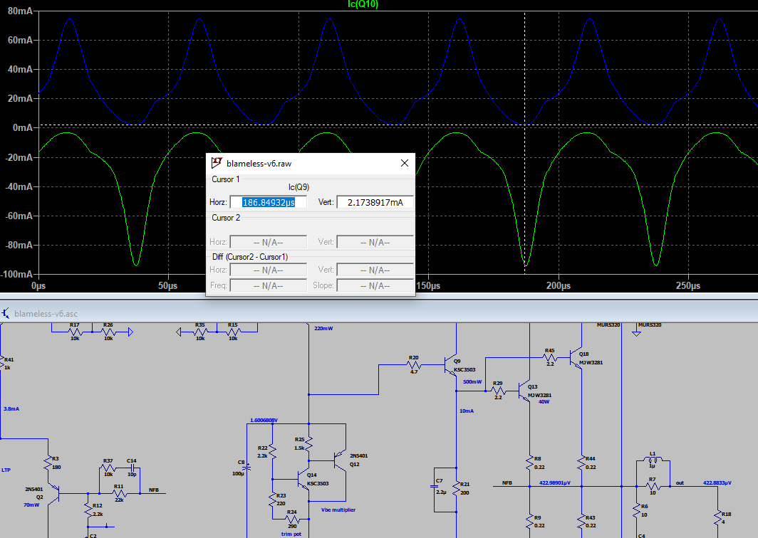

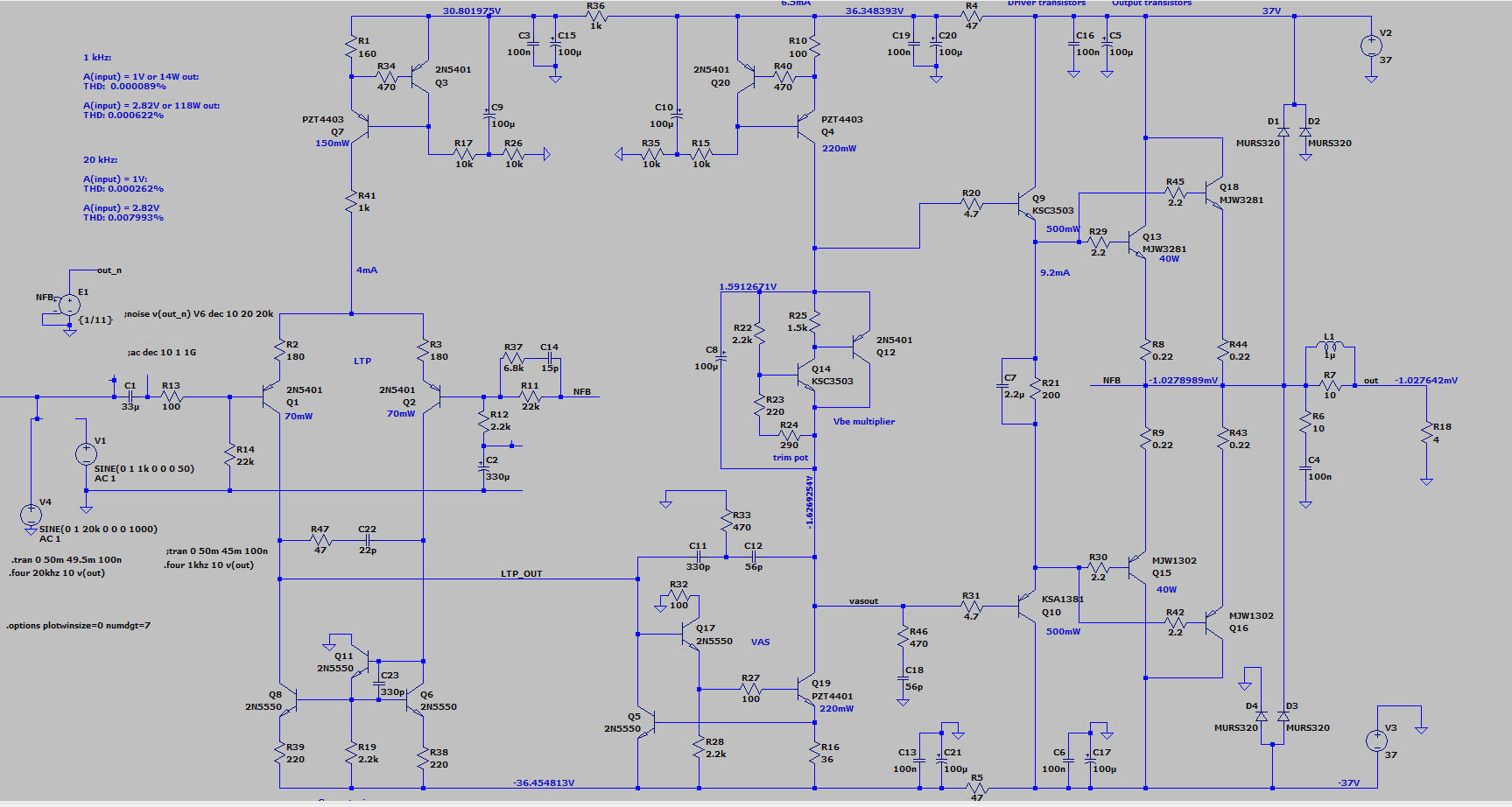

I have purchased the book and it serves me as a great reference for amplifier design and build. Thank you Bob for your work and contribution to the field.
I am still learning about EF3 OPS and have a few questions.
Would it make sense to use EF3 OPS for the amplifier with 37V-0-37V power supply voltage?
EF2 seems to be a tried and true stable version.
Using driver and two pairs of output transistors (EF2-2) delivers great results in simulation.
Amplifier in question is simple blameless concept with:
  • two transistors LTP - FMBM5401, each at 2mA
  • three transistors current mirror with helper transistor - FMBM5551,
  • CFP constant current sources for LTP and VAS - PZT4403,
  • emitter follower VAS - MMBT5551 + PZT4401 biased at 6.5mA
  • two pole compensation
  • driver transistors KSA1381 and KSC3503 biased at 9.2mA
  • two pairs of output transistors - MJW1302 and MJW3281
I am deciding if I should include triple emitter follower or if it is not worth it for such a low voltage?

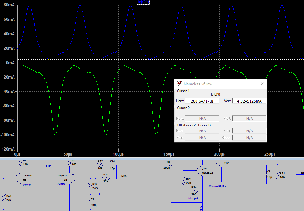

I am still learning and compensation parts like lead cap and RC networks across LTP and VAS output will need to be adjusted to correct values. Seems that I got two pole compensation along with LTP degeneration resistors adjusted correctly by using miller cap of 47p, and later series of 330p and 56p caps for TPC. What is interesting, I simulated and probed collector currents for driver transistors and adding speedup cap actually required drivers to be run at 2mA more current.
Thank you for your help!

Depending on the slew rate you need you may need a lot more current to drive a powerFET. The capacitance is not linear and when driving them as switches there is a point where you need more current than seems correct. The capacitance chage is pretty significant and chages with source drain and source gate voltage, which are all changing. The models in the simulations are sim0lified and usually work but I would add more current. It alsways helps overall linearity anyway.
I always drive the output FETs with driver FETs. It worked well. There is also the really wide bandwidth to manage- you can have the devices oscillationg independent of the surrounding circuits.
Yes, but because the junction is normally forward bias when it is active the changes are not as severe. You do still have to suck the charge out when turning it off.
Suffice to say all active devices need to have proper drive no matter the technology. Tubes are easier in that regard.
