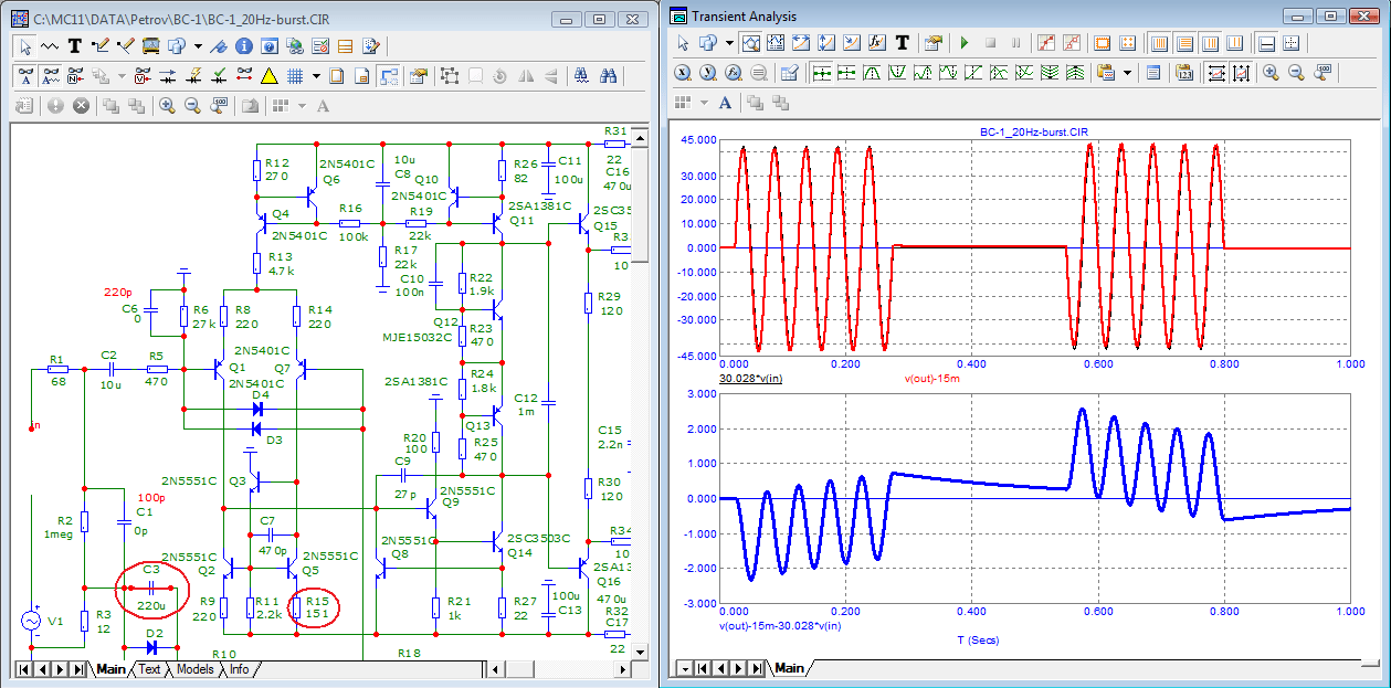

Bob, thanks for taking the time to answer!

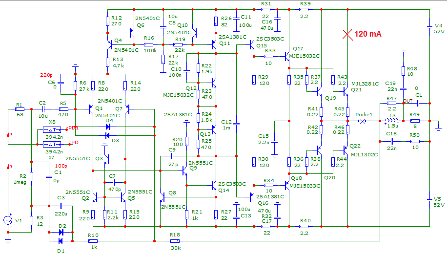

I already wrote that I typed the model of your last VS-1 amplifier on transistor models from your library.
Can I post a diagram of this model (SCH, maybe I made a mistake somewhere)?
May I post the results of the following tests:
- distortion at a frequency of 10 kHz;
- Bode diagram;
- loop gain graph;
- Hafler test;
- test with burst signal 20 Hz

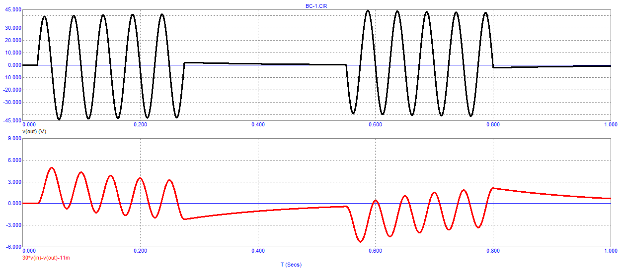

One day, a familiar saxophonist musician invited me to his concert in one of the halls of the city. During the concert, the musician went into the hall between rows of chairs. After the concert, the musician asked me a question: “why, while moving away (approaching) from the stage, did the sound timbre constantly change in waves? Some frequencies then weakened, then amplified. I had to go with him to the stage to the acoustic systems and show that the separate enclosures of the acoustic systems (especially the midrange and treble sections) were installed illiterately - the acoustic centers clearly did not match.
Frequency response, phase response and group delay were taken in the traditional way.

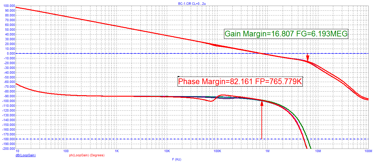

Similarly, the loop gain graph. (CL = 0, 50nF, 100 nF, 500nF and 2 uF)
Is obtained distortion of a signal with a frequency of 10 kHz in the steady state was obtained using a notch filter.
And although the amplifier does not have a servo control system, it works as an integrator and leads to an offset of up to + -2.5 Volts at low frequencies.
I believe that it is the group delay and its behavior both in the audio band and beyond the band at least up to 1 MHz that has the greatest influence on the difference in the sounds provided by the amplifiers.

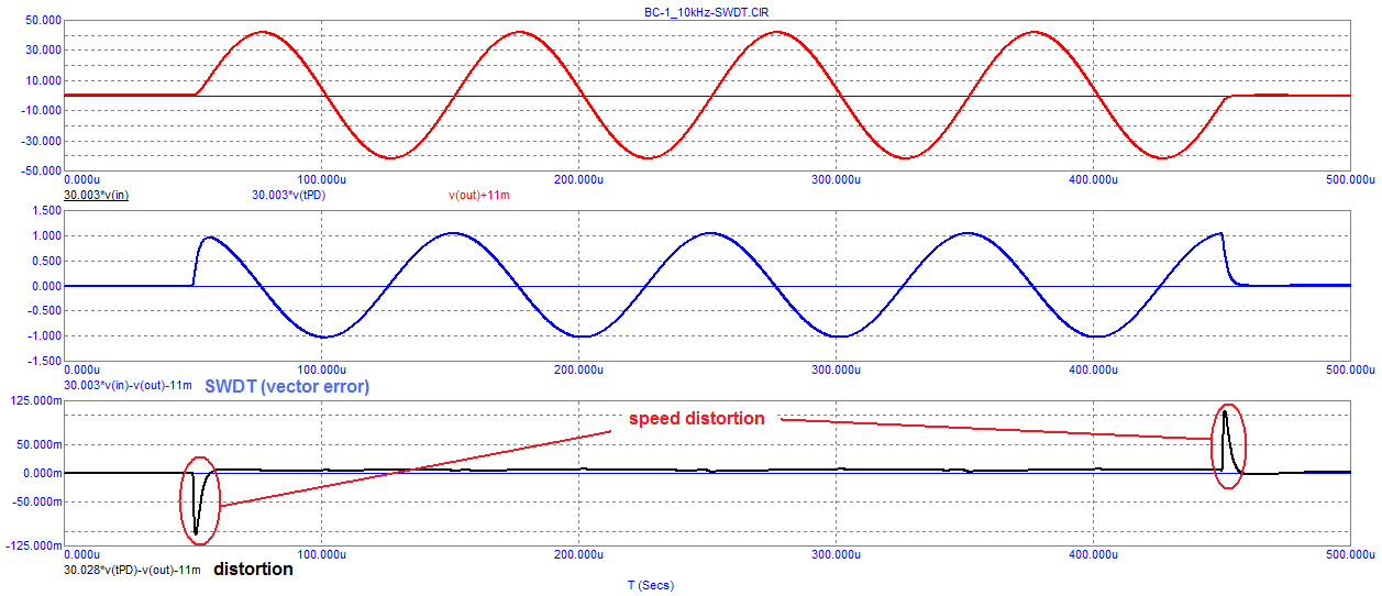

In the Hafler test, a comparison is made between the output voltage of the model and the normalized input voltage. before applying to the input of the amplifier, all signals are processed by a 100 kHz low-pass filter

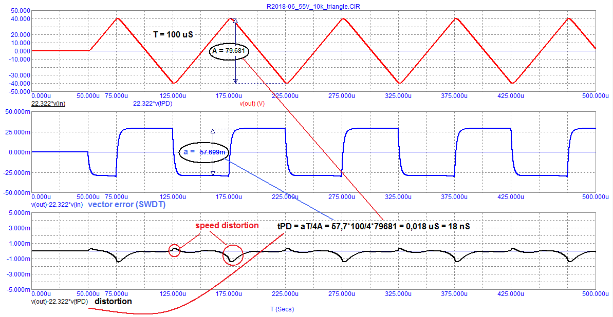

Distortions in amplifiers associated with the delay occur every time at the moments of change in both the amplitude of the vector and the frequency of its rotation (the angular velocity of rotation of the vector), that is, at the moments of change in dV / dt other than the sinusoidal voltage.

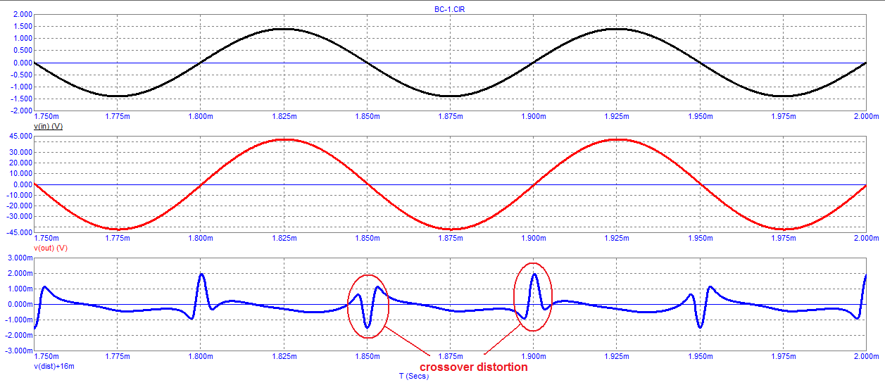

I noticed that the "errors" in your 20Hz bursts (~2Hz) are similar to those known as first cycle distortion in that they fall outside the audio spectrum. So, I would say they are not valid audio signals and of no interest to audio system design. Yes, you can connect an audio amplifier to a signal generator that creates these signals, but we spend little or no time listening to signal generators. We listen to music which contains no such frequencies or waveforms.

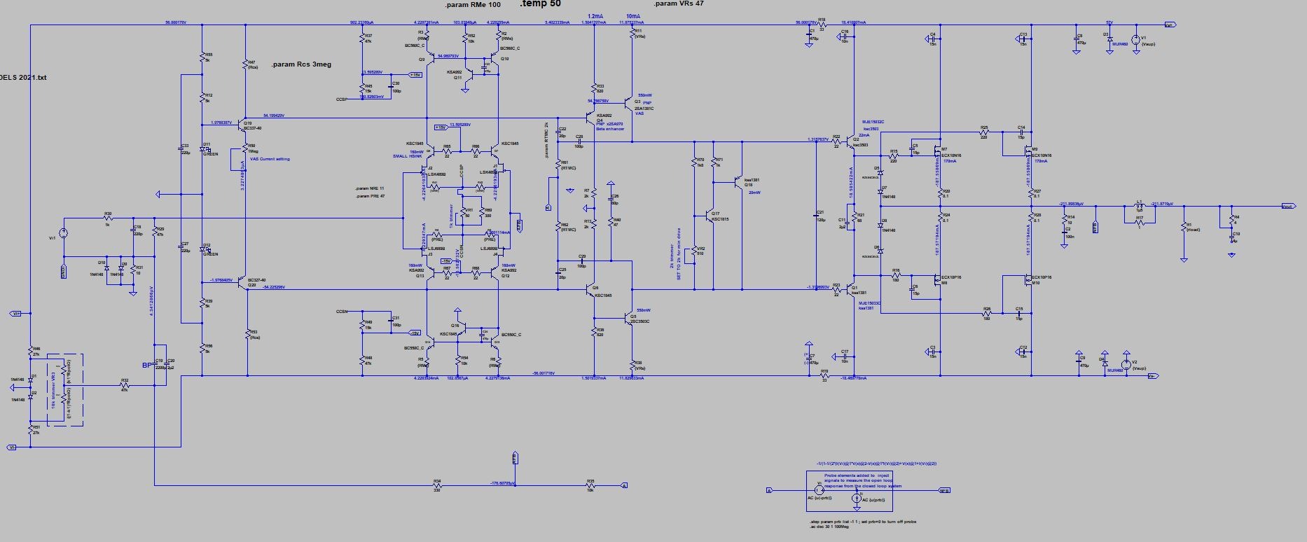

As you know I built a complementary mirror loaded LTP following image 9.20 page 215 of your book second edition and tried to maximize shunt resistors R11 R15 to increase LoopGain but experienced high VAS current variations.
With 4k7 ohms it sounds really detailed in the HF but looses a bit of control in the bass compared to my other build that uses a differential VAS (my other build according to fig 9.15 in your book)
Now I simulated another version of the complementary LTP without the vas current setting shunt resistors.
In this case I used a ccs that sets a fixed voltage in the bases of the VAS "helper" transistors.
The resulting simulation gives very good results but I do not know if it will work in reality.
Would you care to comment my new schematic ?

If I understand correctly, you do not like the distortion of the first period. In that case, I have 2 questions for you:I noticed that the "errors" in your 20Hz bursts (~2Hz) are similar to those known as first cycle distortion in that they fall outside the audio spectrum. So, I would say they are not valid audio signals and of no interest to audio system design. Yes, you can connect an audio amplifier to a signal generator that creates these signals, but we spend little or no time listening to signal generators. We listen to music which contains no such frequencies or waveforms.
1. From what period do you think the amplifier should accurately amplify the signal?
2. Since what period do you personally listen to music?

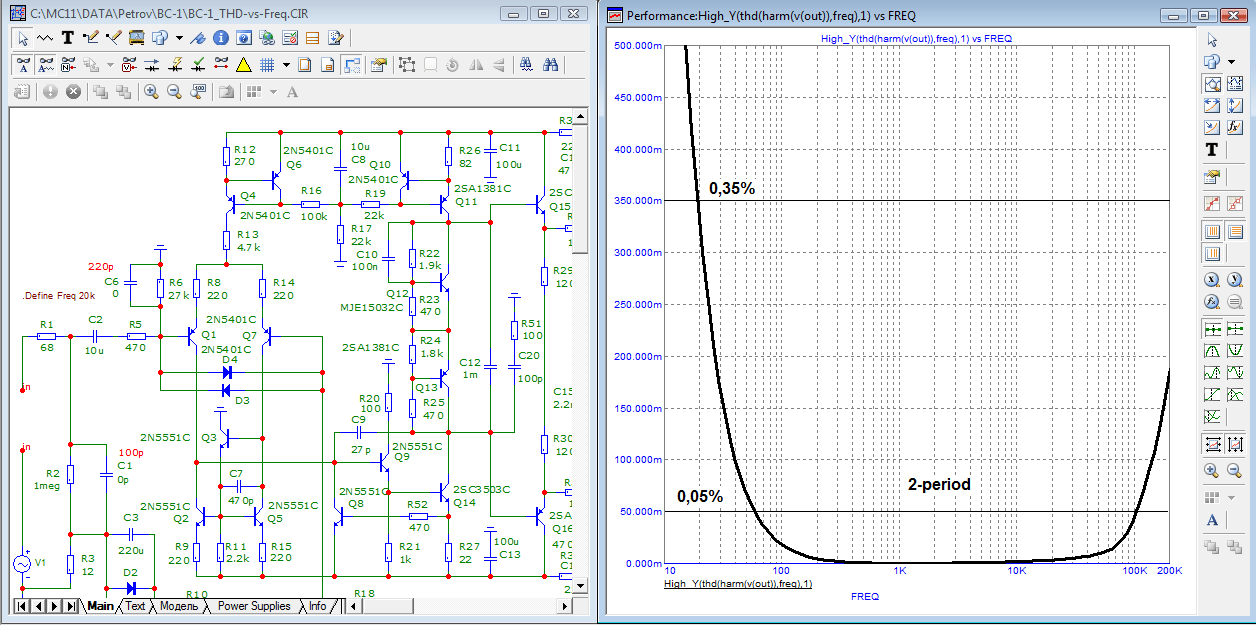

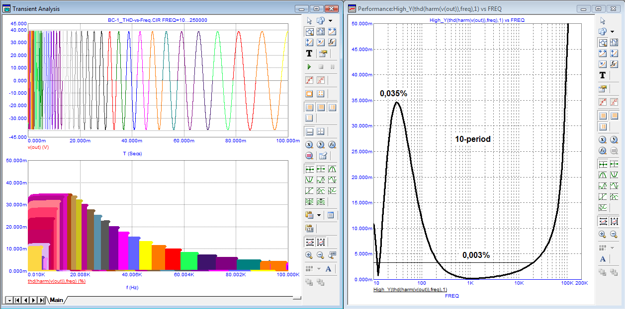

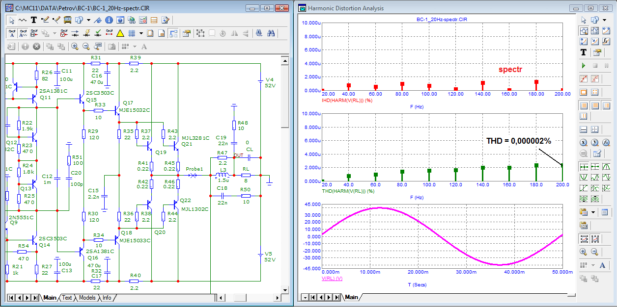

This is what the simulator shows when measuring non-linear distortion at a frequency of 20 Hz in steady state. In one of the articles, Lynn Olson called such testimony complete nonsense.
we will measure the dependence of the total non-linear distortion (THD) on frequency at an output power of 100 W at a load of 8 ohms on the 2nd and 10th periods

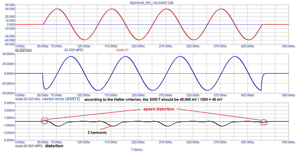

Let's try to figure out how the signal propagation delay time affects other types of distortion other than non-linear ones.
We will test an amplifier that meets the Hafler SWDT requirements to some extent.
From the 10 kHz burst test, it can be seen that the speed distortion does not exceed the 2nd harmonic (below the harmonic distortion in steady state).
In the test with a triangle signal opposite the positive peak, we also see a higher level of distortion, but this is not so much speed distortion as distortion associated with the 2nd harmonic.
