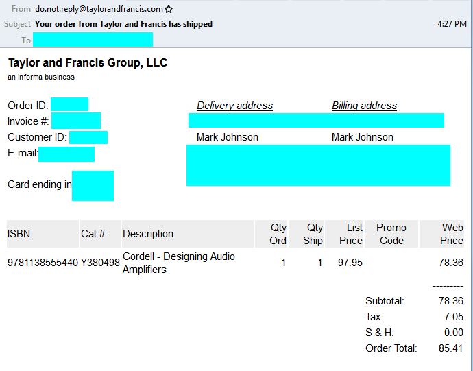

Me too. In April I decided to pre-order from Routledge because their early bird price was considerably less than Amazon's. Just today, 18 June, I got the email below saying that my copy has been shipped. I left the dollar numbers visible so that readers can compare the price I paid, against their own purchase price. And then make the Mlloyd1 decision: was it worth the longer wait, to save this much on the cost? Or was it not?
_
attachment.php
