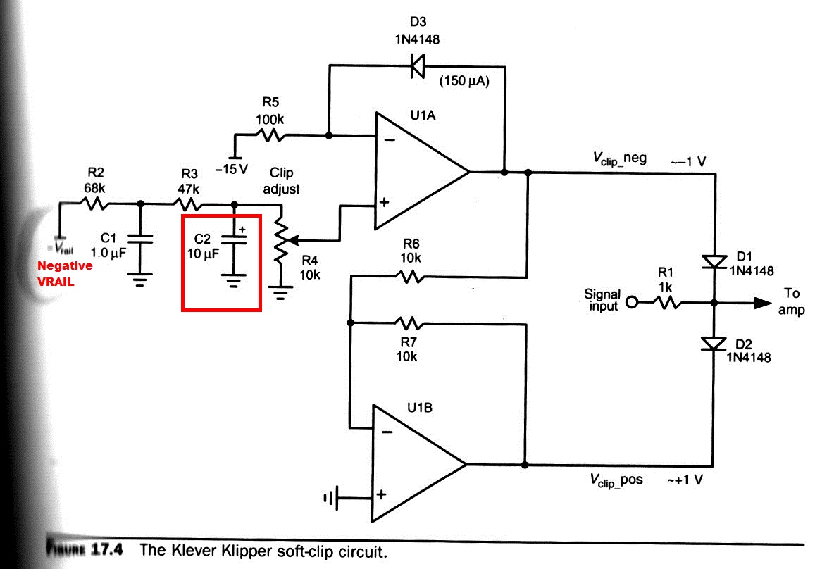

Hi Bob, if there's an errata page for the 1st edition, I couldn't find it. Maybe this has been known for years (or maybe I'm wrong...)
but I think there's an error in the schematic for the Klever Klipper. I think capacitor C2's plates are labeled backwards. I think the top plate should be negative and the bottom plate should be positive (?)

Hi Mark,
I believe you are correct!
There was no errata page posted on my website for the first edition, but I do intend to put up such a page for the second edition. It is a good idea, and it actually helps me as much as the readers. Over the years I compiled files of various errata to correct for the second edition, and many folks here were extremely helpful in that regard. I do indeed owe a lot to the members of this Forum.
