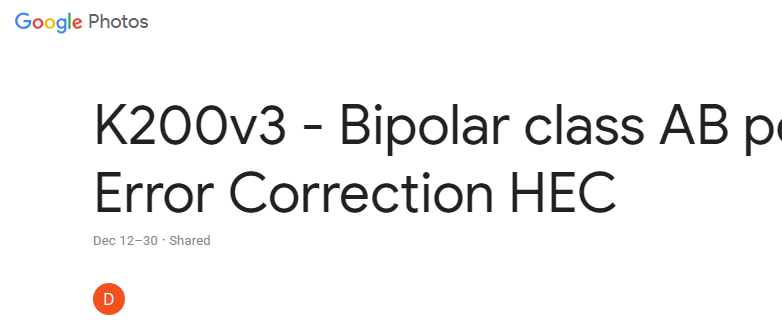

My attempts
HEC buffers
K200v3 - Bipolar class AB power buffer with Hawksford Error Correction HEC - Google Photos

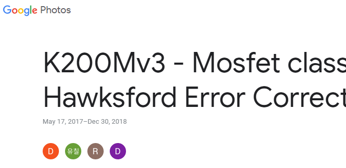

K200Mv3 - Mosfet class AB power buffer with Hawksford Error Correction HEC - Google Photos

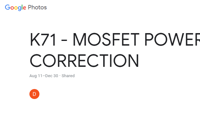

MOSFET EC buffer
K71 - MOSFET POWER BUFFER with ERROR CORRECTION - Google Photos
Odd, they work fine for me. Here are the top left corners of each.
😕😕 Well, I've no idea what's going on. Safari = 401 errors, Firefox with same URL = I can see them fine.
