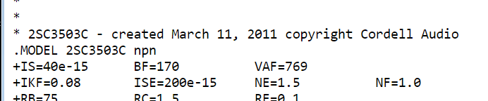

OK, so strictly speaking the "C" parts are not available any more. There's only "E" for the PNP part and "D" for the NPN.
I'll bet that "2SC3503C" appears on an LTSPICE schematic somewhere, and that's why people think it's a part number.
But in fact it simply denotes that the transistor .MODEL parameter values came from Bob Cordell's website. Bob puts a "C" on the end of the part number, to remind users where the simulation parameter values came from. See image below.

It used to be a valid part number. The final letter denotes the beta range. "C" was the lowest grade with beta in the range 40 - 80.

Thanks for mentioning that, Mark. I apologize for any confusion that caused, but I actually did that to remind ME of what model it was 🙂. Its also true, of course, that if those simulations are run with any old manufacturer's model that the results might not be the same.
