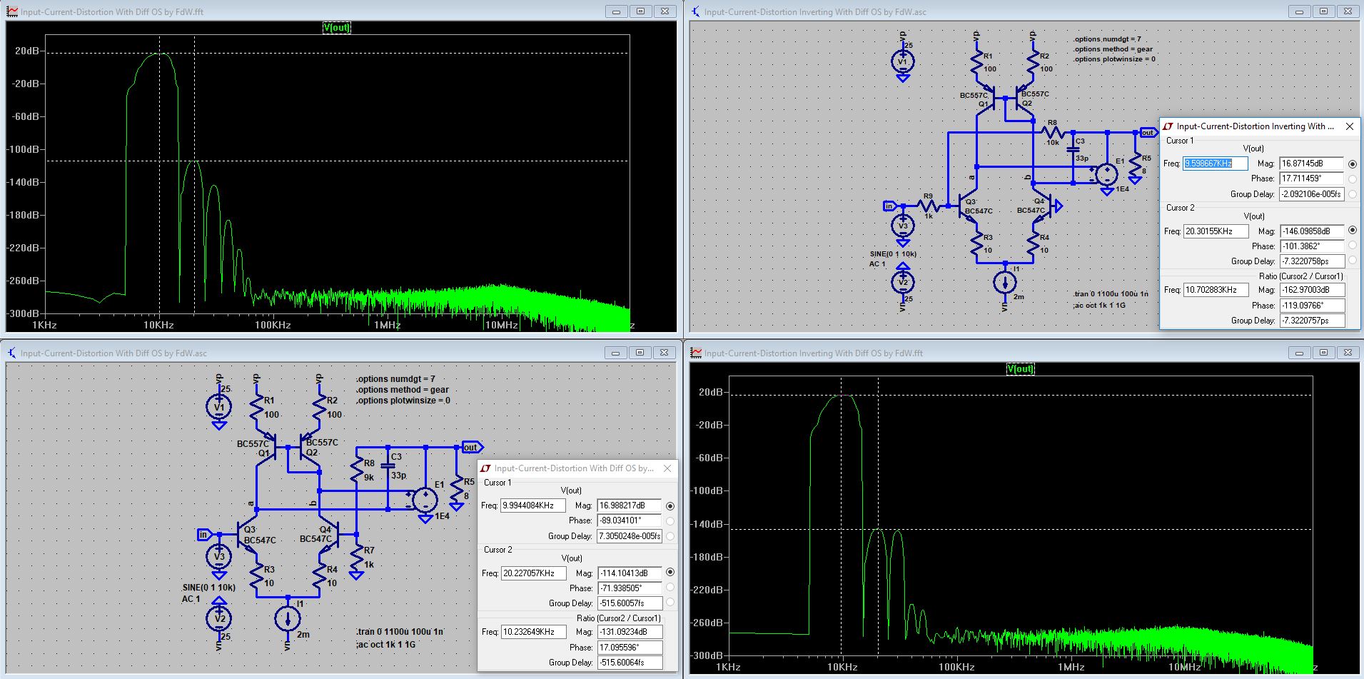

Yes, amongst other things. The simplified model assumes signals travel in one direction only i.e. from the input of the amplifier through its various stages to the output, and in the feedback network from the output back to the input. At higher frequencies this is no longer true. Hence the requirement for a Tian or Middlebrook probe for properly measuring loop gain.
LTP or not, bringing the LTP inside the loop (only possible in an inverting configuration) and inverting mode, here a comparison of the two. Would it not be worthwhile to use inverting and an 'extra' line receiver?

FdW,
one half of the LTP is not inside the feedback loop in both the inverting and non-inverting arrangements.
In the non-inverting the +IN input is connected via the source to audio ground, whereas for the inverting the +IN input is connected directly to audio ground.
In both arrangements the -IN input is inside the feedback loop.
Is it fair to say one includes the whole LTP inside the feedback loop? and say the other does not?

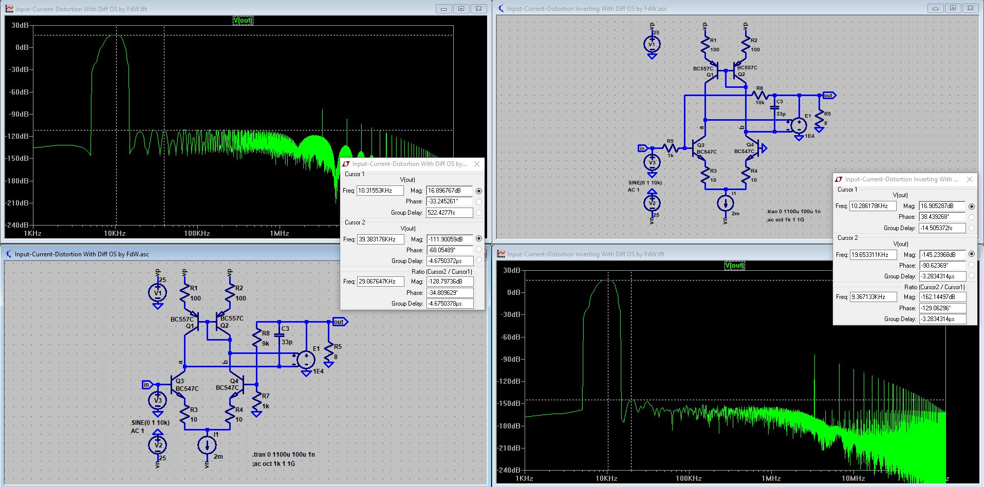

The main point to make is/was that the same components used, one in inverting and the other in non inverting mode, delivers a 30dB difference in THD (yes I know in simulation). This is shown here.
The inverting amplifier shows all transistors inside the loop.
The non-inverting amplifier shows (at the least) Q3 and Q4 outside the loop.
These points where earlier (in this thread) brought to attention.
The -IN node is inside the feedback loop of BOTH arrangements.
As far as I can analyse (I admit to not being an amplifier expert) the +IN node is not inside the feedback loop in BOTH arrangements.

The first spectra looks a bit strange, to me it looks like the spectrum of a small narrow discontinuity superimposed on the second spectra possibly a simulator artifact. BTW I don't like the SPICE Fourier tool I prefer to export data to a general full complex math tool for analysis. Our inhouse simulator has this built in.

If you can afford the inconvenience, the inverting mode offers substantially better theoretical (a perfect summing point) , simulated and ultimately, measured performance.
For the inverting amp it is simple, anything between the feedback-summing-point (ideally there will be zero volts) and the output node (marked out) in in the loop, only the input resistor R9 (and the source impedance) is not 'in' the loop. Any distortion in this resistor will show up at the output.
For the non-inverting amplifier it is simple too, Q3 and Q4 are partly in and out of the loop, the most notably (but others may differ and/or add to this) the base-input-current of these transistors can not be corrected inside the loop, the LTP (partly) depends on canceling any effects of this by using totally equal transistors and loading (as discussed earlier in the thread) the distortions of Q3 and Q4 are canceled if they are exactly equal and if the loading (input and output) of these transistors is exactly equal.
IMHO this is a clear case for inverting mode.
Who cares, and why then not run it on your 'in-house' simulator. This is all besides the point, the point is not about simulating, the point is INVERTING AMPS HAVE LESS OUTSIDE THE LOOP! and thus (in theory [and probably praxis]) can perform with less distortion. But feel free to run it through the 'in-house' simulator and show us 'better' results 😕

Same simulations with a bit more precision added 🙂
.options numdgt = 7
.options method = gear
.options plotwinsize = 0
