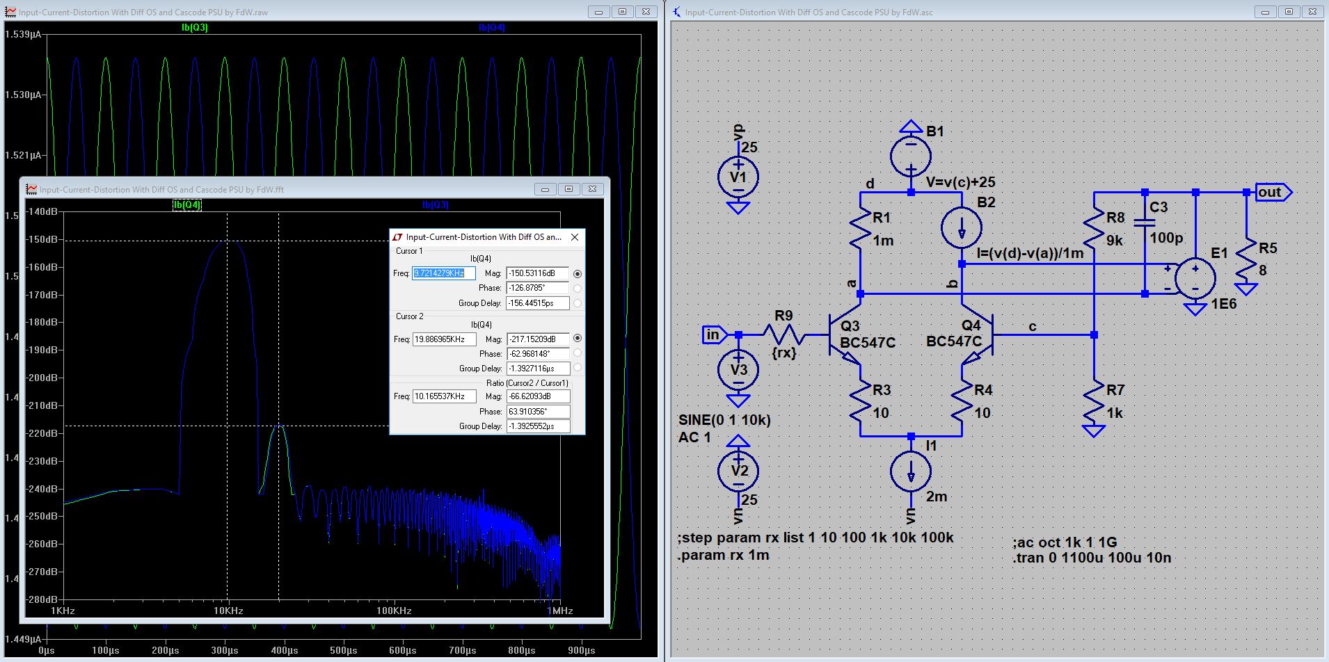

I do agree on what you say here, but there is just this point: would it not be interesting to get some input from DS and BC on the subject? To me the moment I got interested is when they started to talk about 'unknown' origins/mechanisms (creating this distortion, e.g. why/how is this base-current non linear and what can we do), BC saying that DS did not explain and DS saying (sort of) it's just there.
Again, to me, I find it interesting to know what this mechanism is, please [DS, BC] enlighten me 🙂

I was under the impression that we had established that there are a number of mechanisms at play:
1. Modulation of transistor beta due to early effect (transistor beta is a function of collector-to-base voltage)
2. Modulation of transistor collector-base capacitance (transistor collector-base capacitance is a function of collector-to-base voltage)
3. Beta is (or can be, depending on the transistor) a function of Ic, even with fixed collector-base voltage.
4. Tail current is supposed to be pure DC but can be modulated by the signal if the tail current source is not properly implemented.
All these mechanisms can result in the base current of the input stage transistors being distorted. When that current passes through an impedance, this will be converted into a voltage distortion. If the input transistors are exactly matched, and impedances seen at the two inputs exactly matched, these distortion products are common-mode and will cancel. Imperfect matching will result in some of the common-mode distortion being converted into differential distortion, which, as far as the amplifier is concerned, is actually signal that should be faithfully amplified.
Which of the four above-listed mechanisms is the dominant factor in a given amplifier design, depends on the specifics of that design.
Have I missed anything?

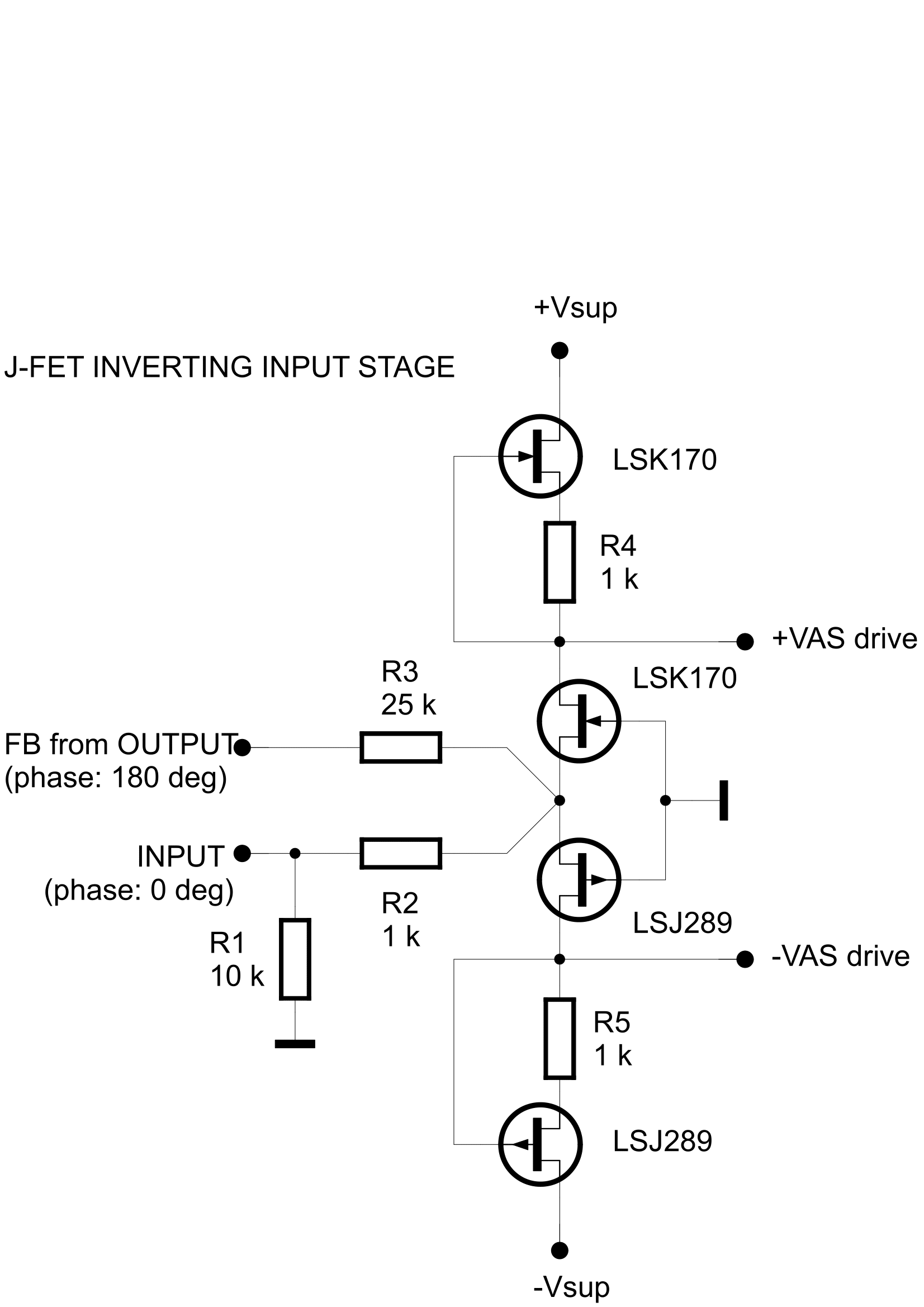

P.S. I find the talk of inverting mode + input buffer interesting. So far everyone seems to have ignored the fact that in that case, the input buffer will experience a common-mode signal. So, somewhere in your circuit you are going to have to use a technique other than inverting-mode operation to ameliorate problems caused by a common-mode signal.
The inverting configurations inherent distortion advantage is not a base current issue (only) - a fet input stages show the same effect. In any case, (at least in a power amp setting,) I don’t think the buffer is is essential - the feedback resistance values are typically substantially larger than the (variable)output impedance of the preamp. If you did decide to implement a buffer, (which I did) i just used two single ended ones. Made with matched jfets and trimmed resistors admittedly - hence my “if you afford the inconvenience “ caveat.

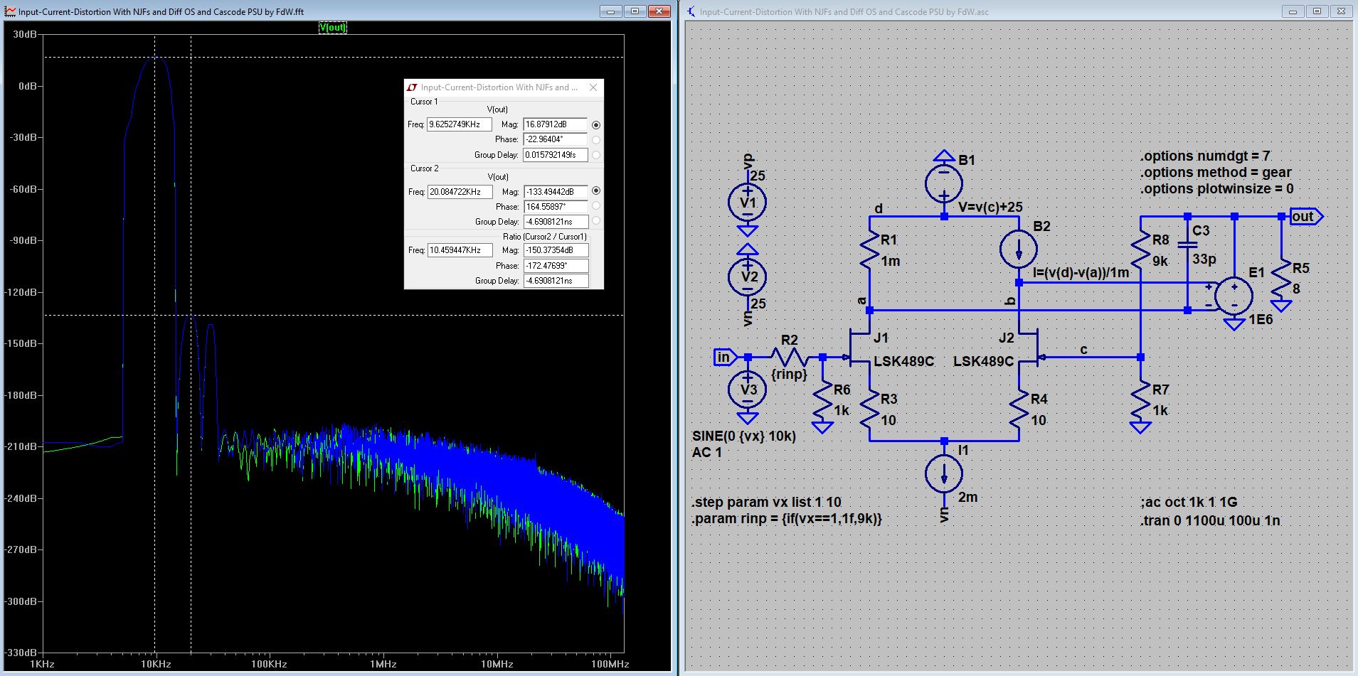

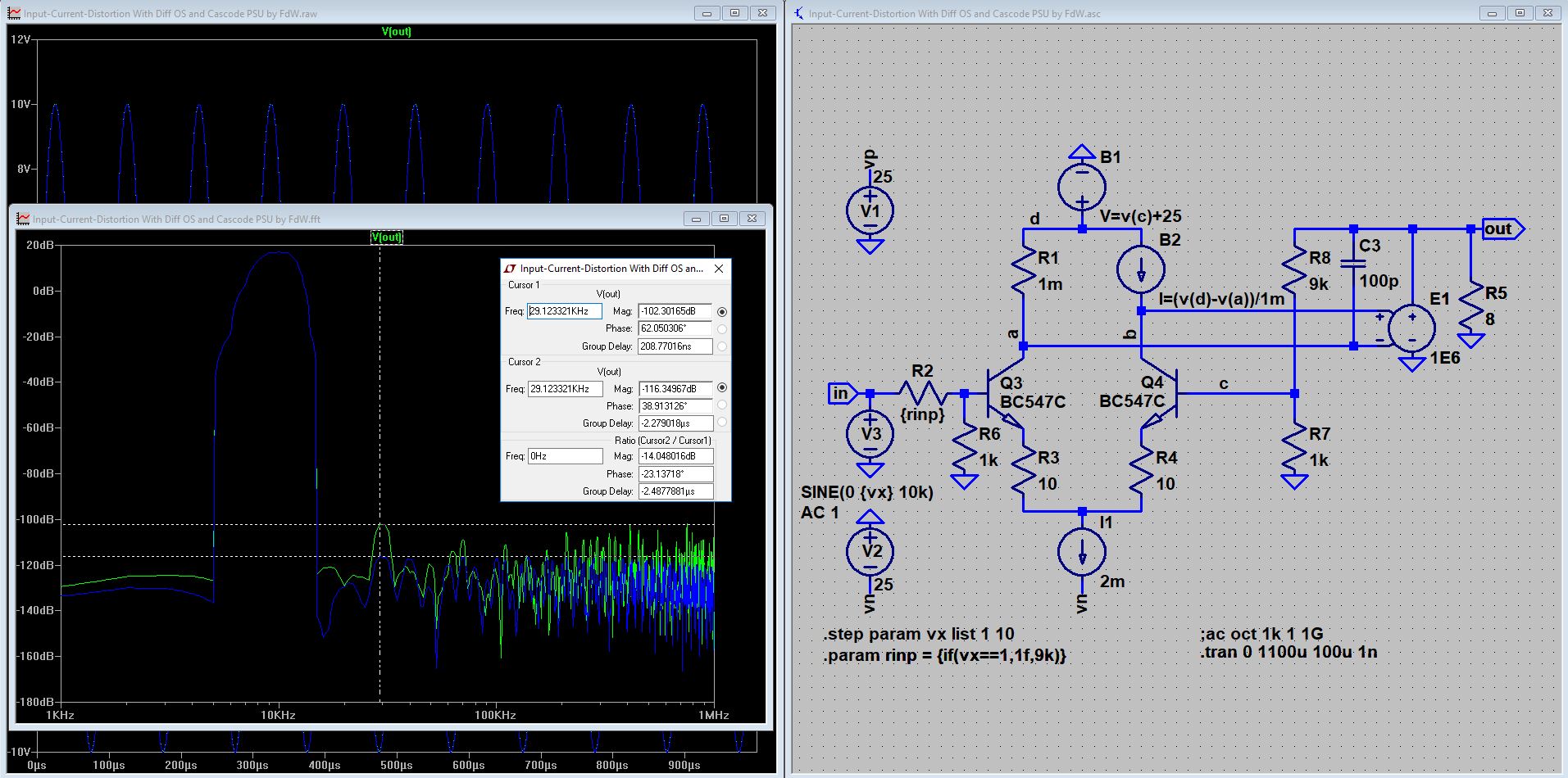

No you are not missing anything (for as far as I see).
Was taken away in one of the earlier simulations by bootstrapping
Mostly solved by bootstrapping (if not all) and constant current mode.
Yes, there is always that 'left-over' factor even when bootstrapped and running at a constant current.
There is always noise and the 'act of God' and the (possibly) 'imperfection' of nature.
All these will add up and generate some, but one(I) would expect that (by approximation) this should be divided by beta to get a figure that will be (by approximation) reflected in the base current.
But, the simulation with absolute bootstrapping, absolute mirroring, absolute amplification in the VAS and OS end a zero impedance signal source still shows a sizable input-current-distortion, witch I can not explain from the above, and for witch I like to see some input from the 'publicists' among us.
P.s.:
1st picture: {rx} is in the 1st step 1fempto Ohm the 2nd step (9k) demonstrates the effect of input-loading and then distortion canceling by the transistors being 'exactly' equal getting to a high THD-figure (in both cases)
2nd picture: shows the input-current-distortion (near -66dB) showing that the only way to make an amplifier with better figures is to depend on cancelation of this distortion in the LTP (my opinion, and I would like to see some input on this).
  • Input-Current-Distortion With Diff OS and Cascode PSU Input Impedance Changed by FdW.JPG
Where?
There are multiple problems here that I try to avoid, high impedances and a potentiometer connected directly to the pre-amp output or/and the power-amp input.
There you go 🙂
