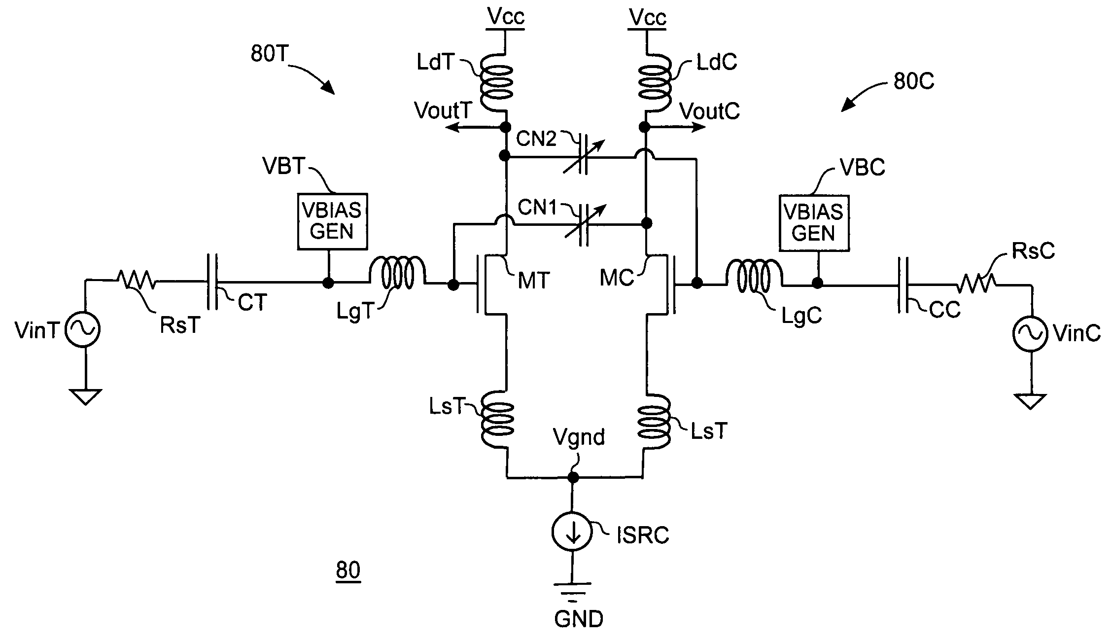

A technique for stabilising RF power amplifiers against parasitic oscillation.
See:
Neutralization of RF Amplifiers
I have never heard of its use in audio amplifiers.
It can do that.... but not its main use.
It works well for any amplifier... audio included. I told John Curl how to do it decades ago for diff pair ips. JC tried it and it worked for him also.
It extends BW by cancelling the IPS stage C's. And, thereby also reduces distortion from that device's C.
THx-RNMarsh

take diff ips (bjt) ---- connect a value of c to collector of one and to base of other. do it that way to both bjt.
Roughly, if the C are same as ips c's, they cancel.
You can use a backwards diode or better, another transistor as diode of same type as ips diff. and get better dynamic cancellation using diode C.
I just found you a schematic of my description. Best though to use c of same transistor connected as diode. [for CN1 and CN2]
THx RNMarsh

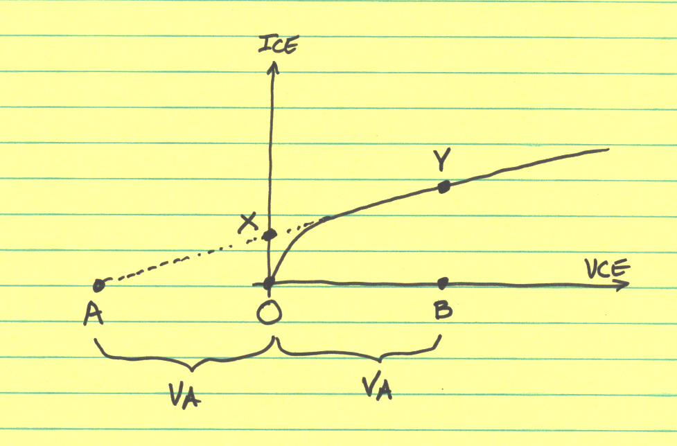

In saying that VAF is the voltage at which hfe doubles
In high school geometry it's called "similar triangles".
Triangle AOX is similar to triangle ABY since (i) both are right triangles, and (ii) both have the same acute angle XAO (== acute angle YAB).
Since the base of triangle ABY is exactly twice the base of triangle AOX, the height of triangle ABY is also exactly twice the height of triangle AOX.
At the same base current, when VCE=Va the collector current has doubled, from X to Y. Thus the ratio Ic/Ib has doubled.
It's geometry.

We can calculate the nonlinear base current due to Vaf to see if it matches the distortion figures.
Cordell's BC550C model tells me Vaf is 162 and from experience Hfe is about 500. Let's say 20Vce, 5mA Ic, and 1V input.
Vaf is the voltage at which Hfe doubles
It's geometry.
_
Neat! I learned something!
