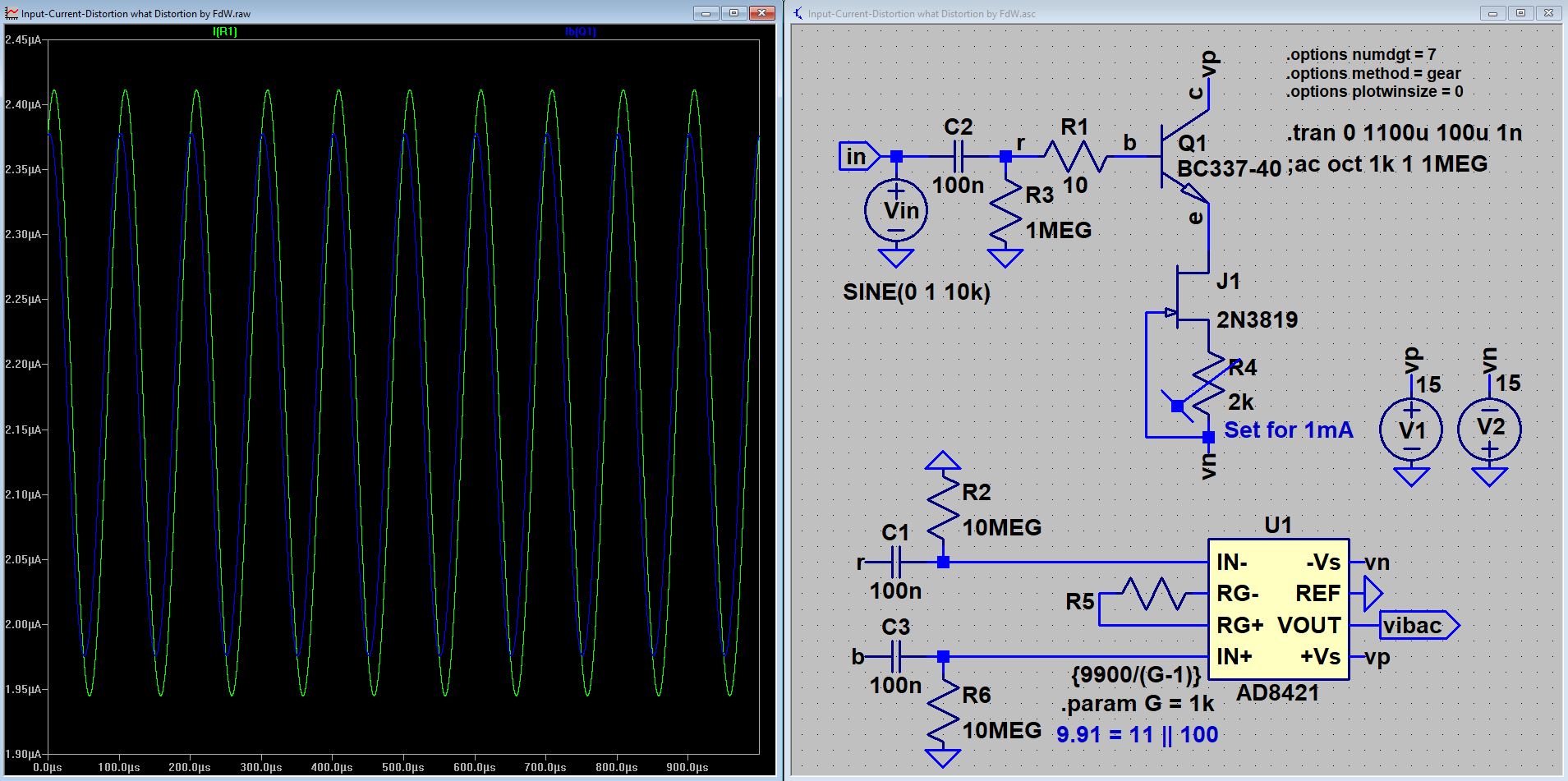

We can calculate the nonlinear base current due to Vaf to see if it matches the distortion figures.
Hi keantoken, thanks for contributing some analysis 🙂
Cordell's BC550C model tells me Vaf is 162 and from experience Hfe is about 500.
Your sums seem to assume that this figure of 500 is measured at 0 V Vce but this won't be the case. Anyway, accounting for the actual value of Vce for this measurement would only make a small difference to your calculations.
54.7nApp total error base current, which we can assume is mostly 2nd harmonic.
57uV error in 1V is 0.0057%. Most of this is still the fundamental though
(emphasis added by me). These two statements do not appear to be in agreement. What am I missing?

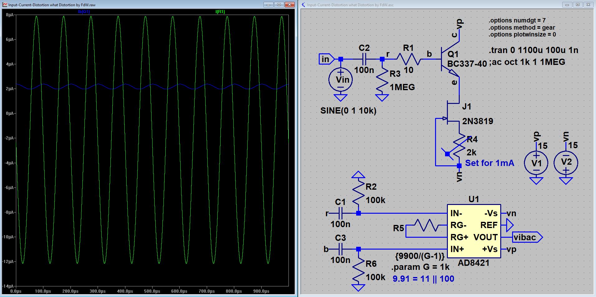

So (I thought) go measure (build something on the realty plane 🙂).
But... new hurdles pop-up, anyone? what is this difference between I(R1) and Ib(Q1)?
