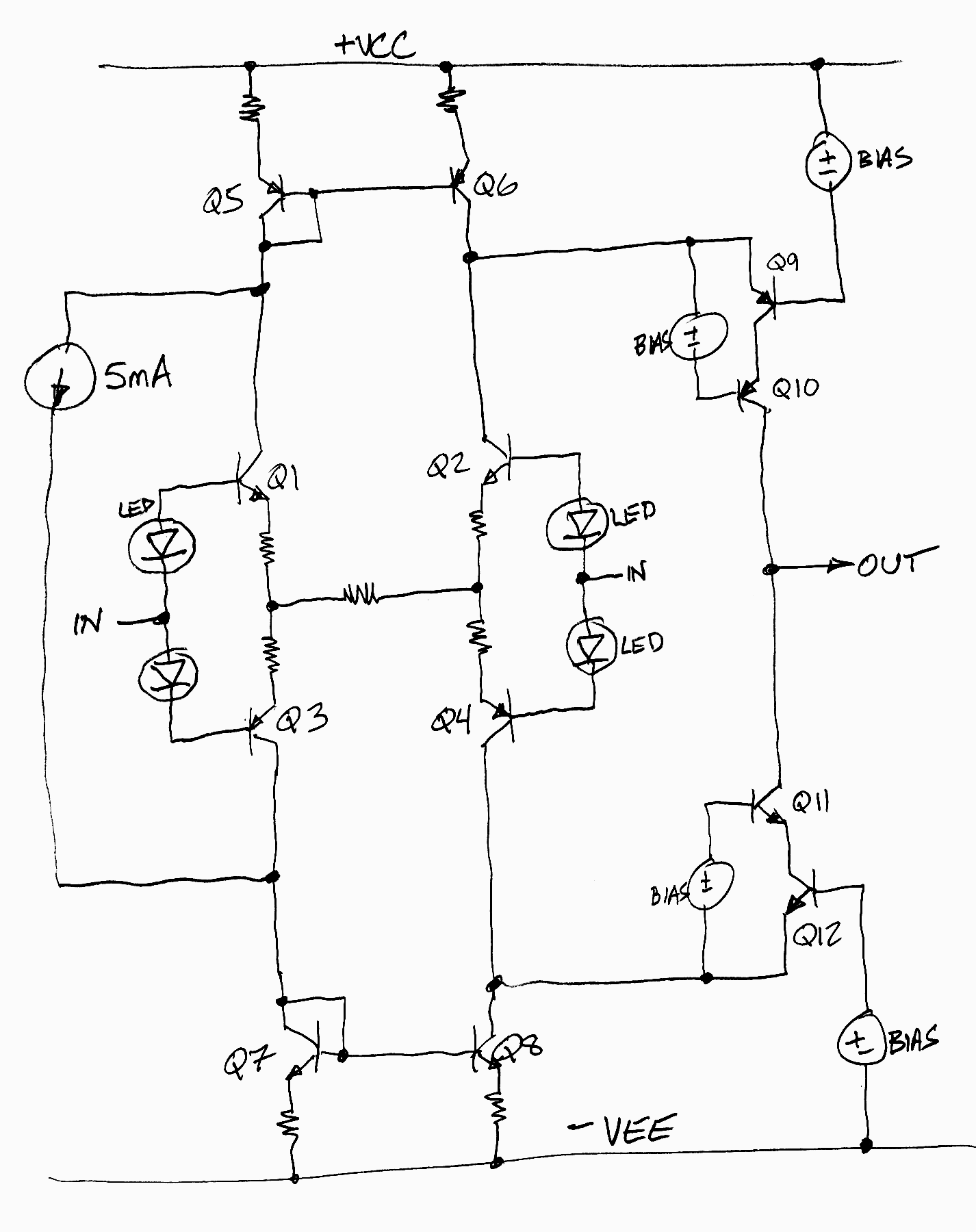

I bought Kolinummi's book from the Linear Audio website and I encourage others to buy it too. On page 200 he says
The complementary symmetric input stage topology makes it easier to create a symmetric VA-stage. In such a circuit, asymmetric input-stage loading can be accepted without increased distortion, and this topology is also superior in terms of offset voltage, input current, and PSRR.
One of his examples of this idea appears on page 194. Not wanting to upload copyrighted material, I have redrawn it by hand, and made some (very!) slight changes; thus it's not a copy. Trust me, the schematic below faithfully represents the essence of his example. Or if you don't trust me, open the book to page 194 and find all of the differences. Maybe you won't agree they are very slight (?)
_

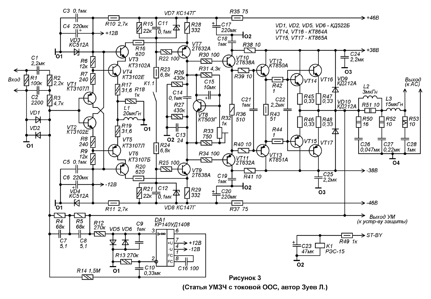

Óñèëèòåëü ñèììåòðè÷íûé ñ êàñêàäàìè óñèëåíèÿ ïî íàïðÿæåíèþ ñ îáùåé áàçîé
Such circuitry has been developed and our fans. I suspect it is a painted one and the same person.
Here is a very small loop gain. It's a dead end.
Best Russian amplifier - here: Ñîáèðàåì ñâåðõëèíåéíûé óñèëèòåëü Ñåðãåÿ Àãååâà..
It may seem a bit complicated. 🙂 You can download the files without any problem.
Of the simpler amps have this circuitry:
http://forum.vegalab.ru/attachment.php?attachmentid=234997&d=1429687343
The earlier and more simple version of this amplifier is attached.
Those, who doubt the accuracy of the calculations of the simulator, can draw these two schematic and make the test: the first version has 0.005% distortion, and the last 0.001%. My test showed a perfect match with the parameters, that showed the author.

I assume you are referring to cascodes where the cascode bases are fed with the common-mode signal presented to the differential pair, such as using a buffered version of the tail voltage or a replica of the feedback signal?
I have used the replica feedback approach to drive the cascodes, and it works great. It is especially helpful when high-capacitance JFETs are used in the IPS, like the LSK389.
