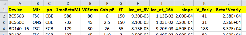

I measured a bunch of PNP transistors and calculated that figure of merit; it's in column "L" of the table below. Beta was measured at (10V & 1mA) and Early voltage was measured at (10V & 8mA). Those were the measurement conditions that most closely met my design needs at the time; readers who don't approve of these choices are, of course, free to repeat the measurements themselves at whatever conditions they prefer.
The KSA992 comes out 11th best (see row 12) in this table. The 2N5401, used throughout Bob's book, winds up in 23rd position, with a Figure Of Merit that's 83% as good as the KSA992. Notice that the top two finishers are large, macho power transistors, and number 3 is the lowly MJE350 medium power device in TO-126 packaging.

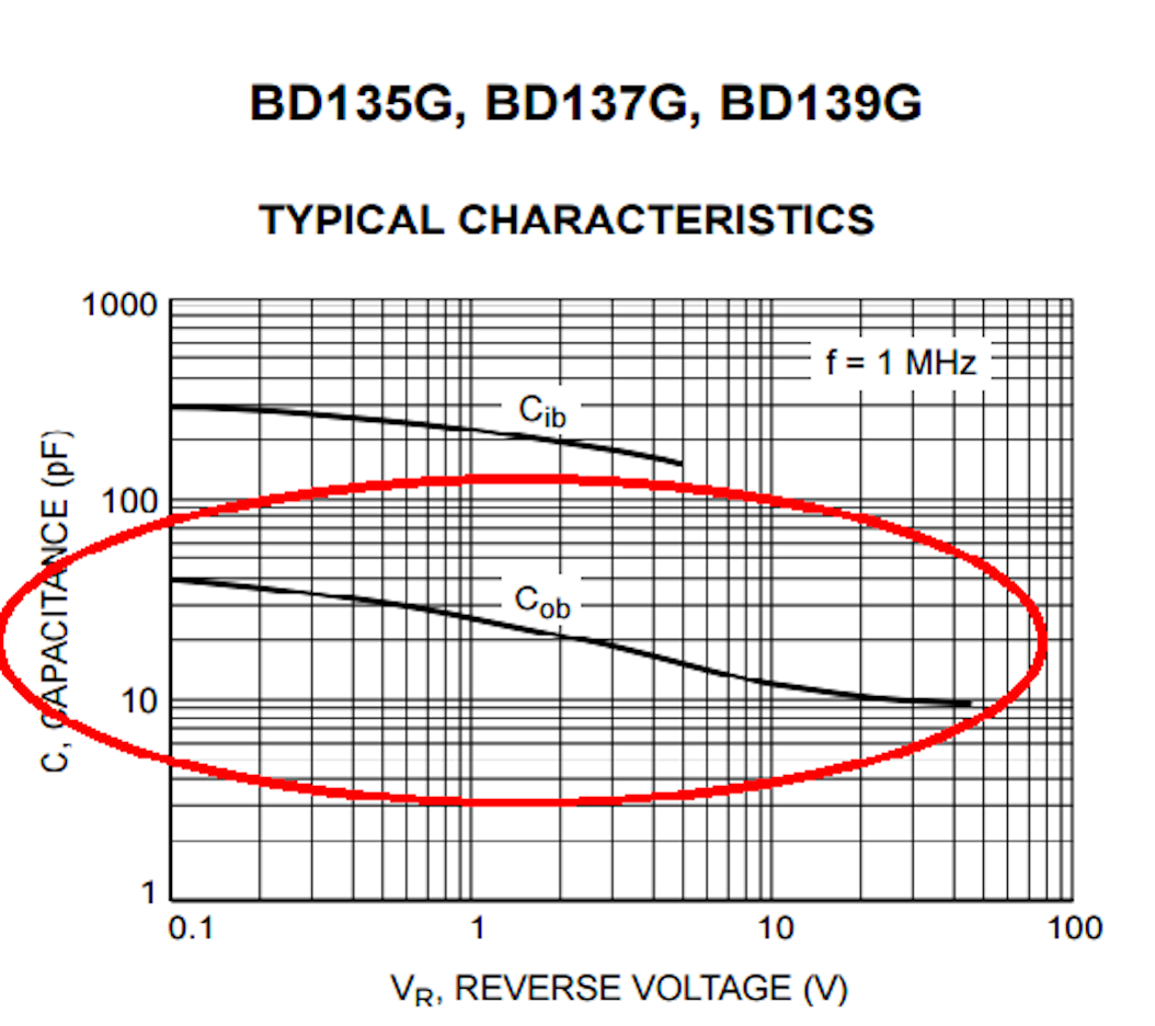

I noticed that you measured most of the values yourself, did you measure the Cob's?
I see the BD140_16 as 26 pF which is much lower than I thought it would be, none of
the data sheet I could find had it listed when I looked several years ago. I think the
very old Phillips data sheet had it but they are not making them anymore and I've read
that the newer parts are not as good - no idea if this is true.
From the ON Semiconductor datasheet

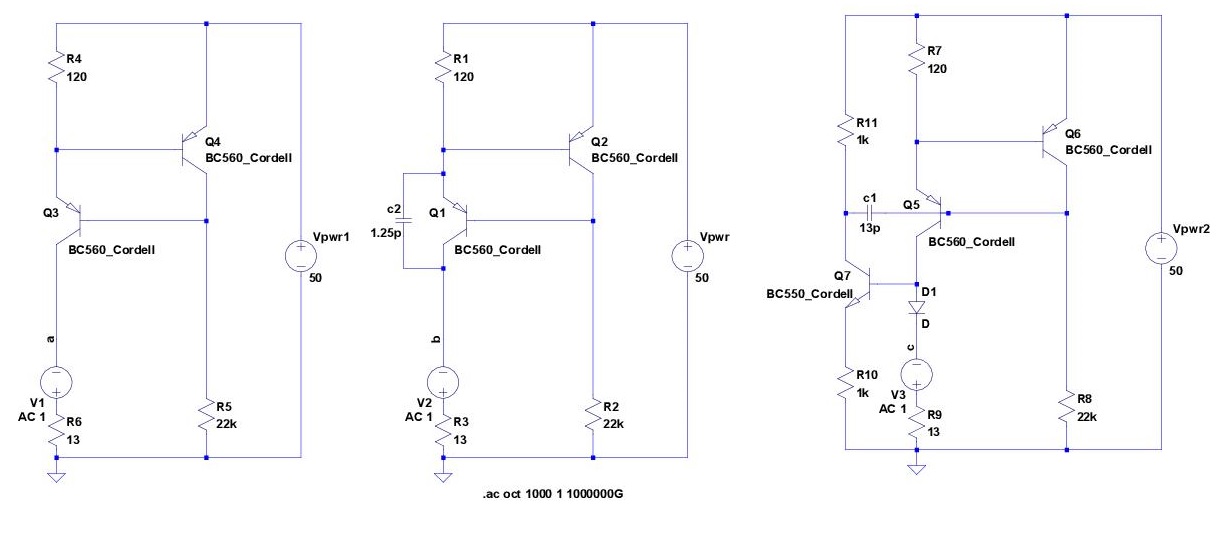

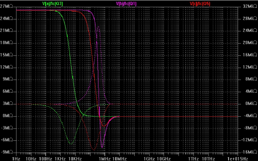

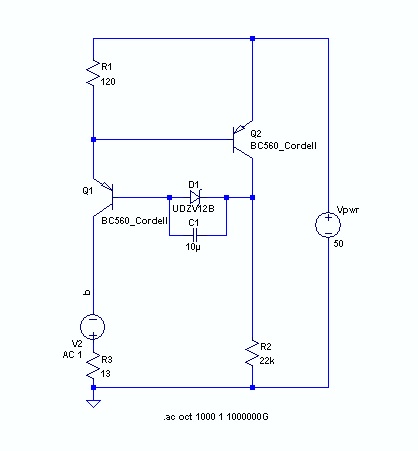

Just to illustrate. This is by no means practical as is. But the idea is to null, cancel, reduce Cob increasing the the impedance BW. The sensitivity is far too high. Change one thing and it's gone.
an order of magnitude improved impedance at the same corner frequency is still an order of magnitude greater frequency with the same or better impedance for a 1st order slope
and as already pointed out the Z loading the best ccs is still going to be nonlinear, likely more nonlinear with increasing frequency and will typically dominate in aduio power amps
Something I wanted to ask long ago, what if we throw in a bunch of diodes in series with the output transistors emitter in order to give the driver a little bit more Vce headroom and hence a lower Cob, say 5 diodes for a starter, driver base goes to between the diode string and the resistor, could davada perhaps simulate that for us, thanks.

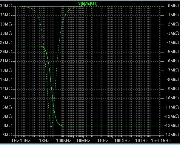

If we put a series of diodes on the emitter of the output transistor of a 2T current source then we won't be able to bias the the output transistor such that we could get 5mA out of it.
If I understand you correctly your goal is to raise the voltage on the control transistor collector. I think the circuit below will do this and still allow bias of the output transistor.
I think it's the output transistor Cob that is of concern for BW.
Actually I meant, keeping R1 in place and adding the diode string in between R1 and Q1 emitter, but the zener will do the same forcing Q2 Vce stretch a bit as well.
I wasn't so much hoping for a greater BW around Q1, rather was more curious how the driver Q2 interaction with Q1 would change as Cob would almost half with larger Vce, or doesn't the spice model take these changes into account, any way thanks for your effort, maybe there's not much to gain on increased driver Vce.
edit: btw, one could also try decrease Vpwr, which in your simulation looks like to be set at 50 Volt, to something much lower so there's only couple of Volts Vce over Q1, that should also increase Q1's Cob considerably and hence lower the BW, or am I thinking wrong?TOP

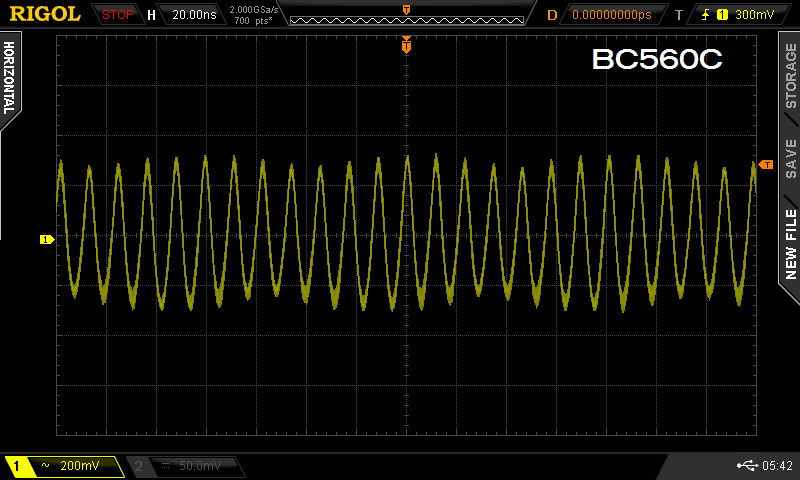

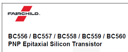

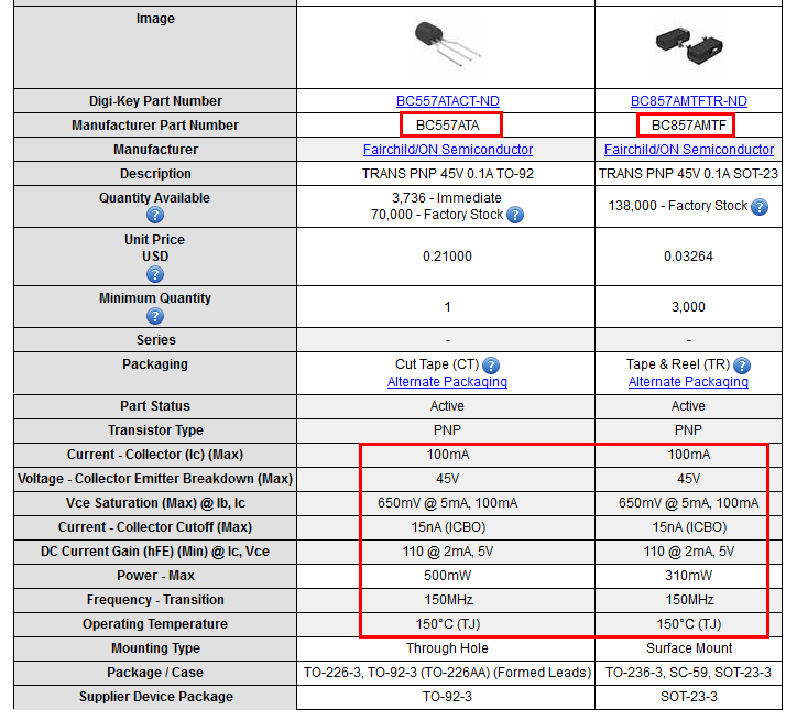

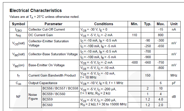

I think the exact same transistor die is sold in surface mount as "BC857" and is also sold in thru-hole packages as "BC557" see image 1 below.
BC557 is a medium voltage sort bin on a transistor die that can be branded BC556 thru BC560 depending on its measured VCBO and measured Beta at final test. See image 2 below.
I did test the next higher voltage device (BC556) and the highest Beta device (BC560) see image 3 below. So you can probably interpolate the BC557 / BC857 from these.

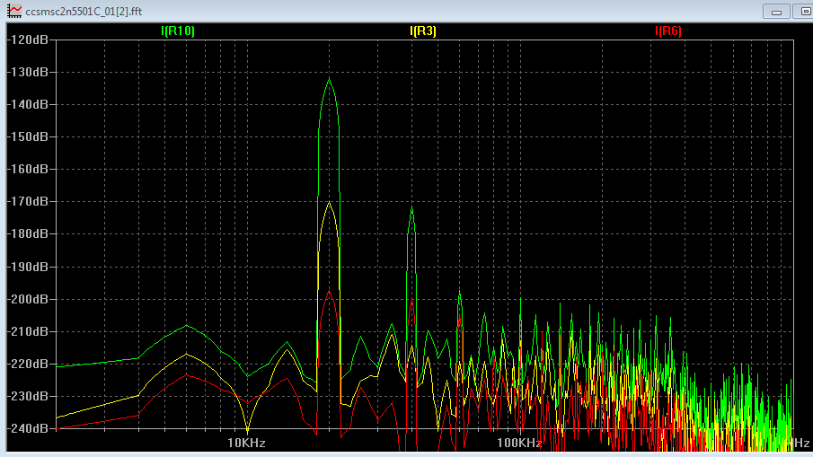

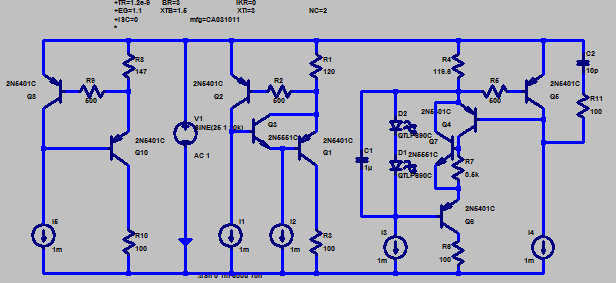

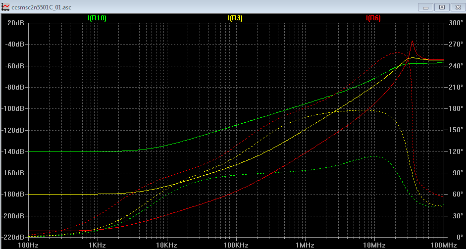

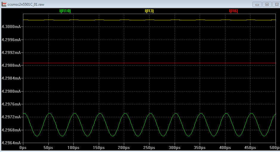

more simmed ccs racing
I think the Cartesian plot used by davada is not very useful, also .AC while convenient is seriously flawed
I used the principles in the Hawksford paper I've been promoting here recently in the following sim, used Cordell models
https://web.archive.org/web/2013012..._lab/malcolmspubdocs/J10 Enhanced cascode.pdf
for me the most informative way of looking at these circuits is the .Tran with a time step small enough to capture the ccs oscillation - too big a t_min and often the sim won't oscillate when it should
then use the actual frequency of interest, show the fft to see nonlinear harmonic behavior:
  • ccsmsc2n5501C_01.asc
lots of opportunity for unmodeled effects - it would require quite a bit of bench time and good tools to get hardware and sim to match @100 MHz - but I think it is possible - got Fet probes, Vector Impedance Analyzer?
I really was more concerned with showing even audio frequency comparison requires a bit more care with sim, even with the "too simple" models we have in hand
and my characterizing it as "sim racing" should point out how little practical use I think these elaborations have in real world PA circuits where ccs Z and linearity will be swamped by anything they are connected to
