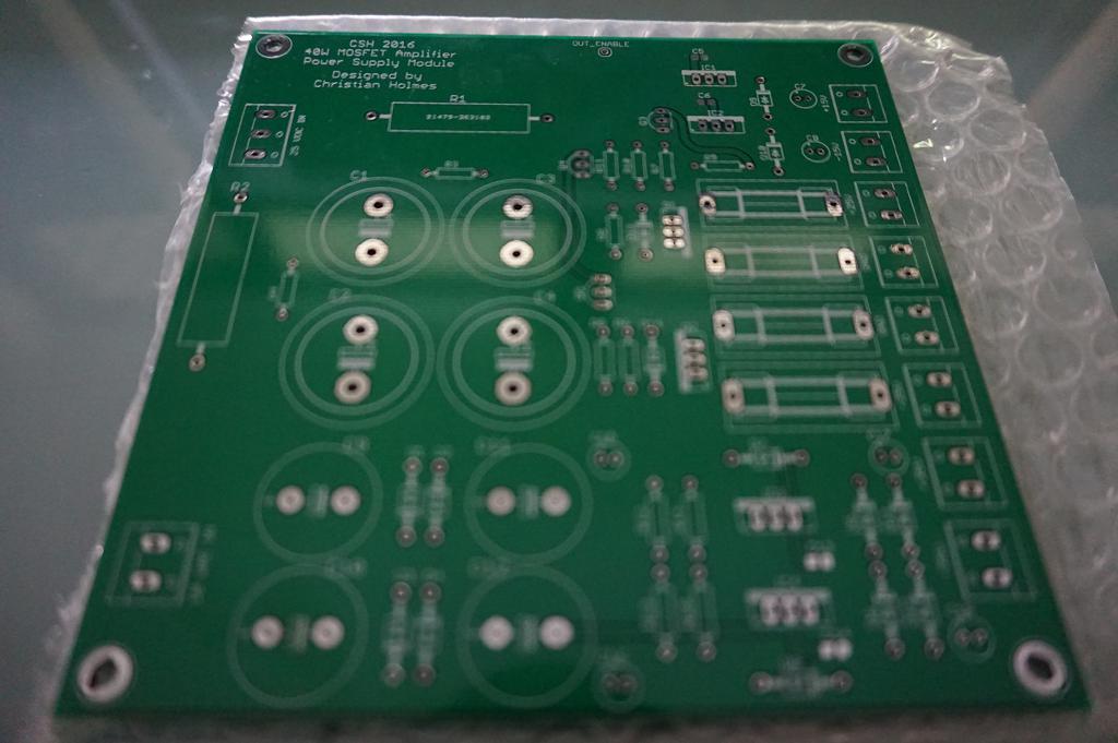

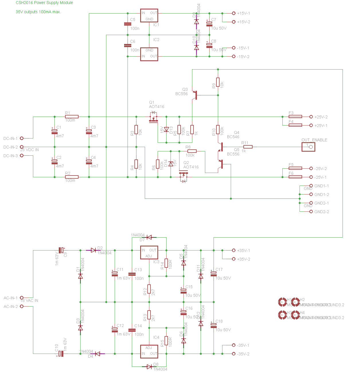

Hi Mark, what's not apparent from the schematic I posted at here is that the rails feeding the IPS are fed from regulated supplies, which is why I haven't implemented the usual measures such as filtering the CCS Vrefs either.
The power supply board's schematic is attached. I used to obtain the boosted and regulated rails by adding windings to the PT as described by Bob in his book, but I now find it far more convenient to use a voltage doubler circuit instead. Only two "extra" parts (C9, C10) vs. Bob's method - a no brainer IMHO to avoid fiddling around with magnet wire and kapton tape.
When I revisit this board I'll do away with the boosted +ve rail altogether and simply bootstrap the VAS CCS and feed the LTP tail from the +15V opamp rail.
The main rails under the control of an 8-pin PIC microcontroller (off board, not shown) which delays turn on to eliminate thump and disconnects power if DC is sensed on the speaker line.
