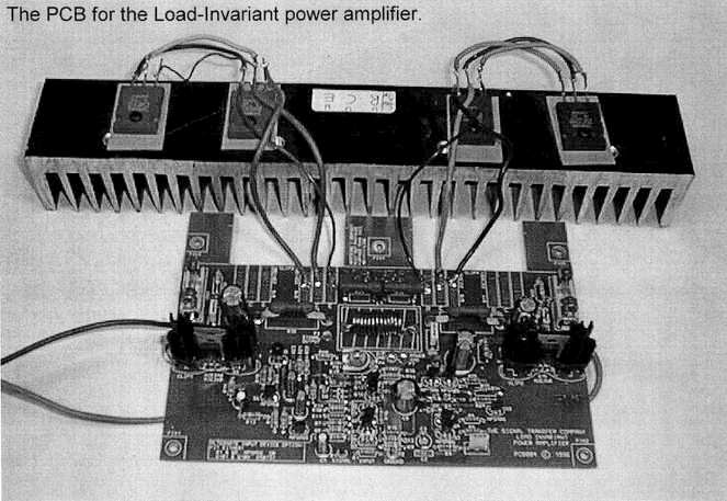

wiring
Hi Douglas,
Do you mean the "laws of physics" of the wiring as shown below?
IF your test circuit was built this way, of course it shouldn't work.
Cheers, E.

Guru Self will tell us he is unable to make it work but that doesn't stop the rest of us from doing so
No, but the laws of physics might.
I do hope you will inform me when you succeed
Hi Douglas,
Cheers, E.

Hi Douglas,
Cheers, E.
Hello Edmond
Do you mean that it won't work as shown because the device wiring is too long? I assure it also doesn't work if the power devices are mounted straight on the PCB, as intended for this design.
I don't think I've ever said Cherry compensation can never work; perhaps there are amplifier configurations where it does. Maybe. But I have never been able to make it work with the Blameless configuration/concept, and that is the most stable and predictable configuration I know.
